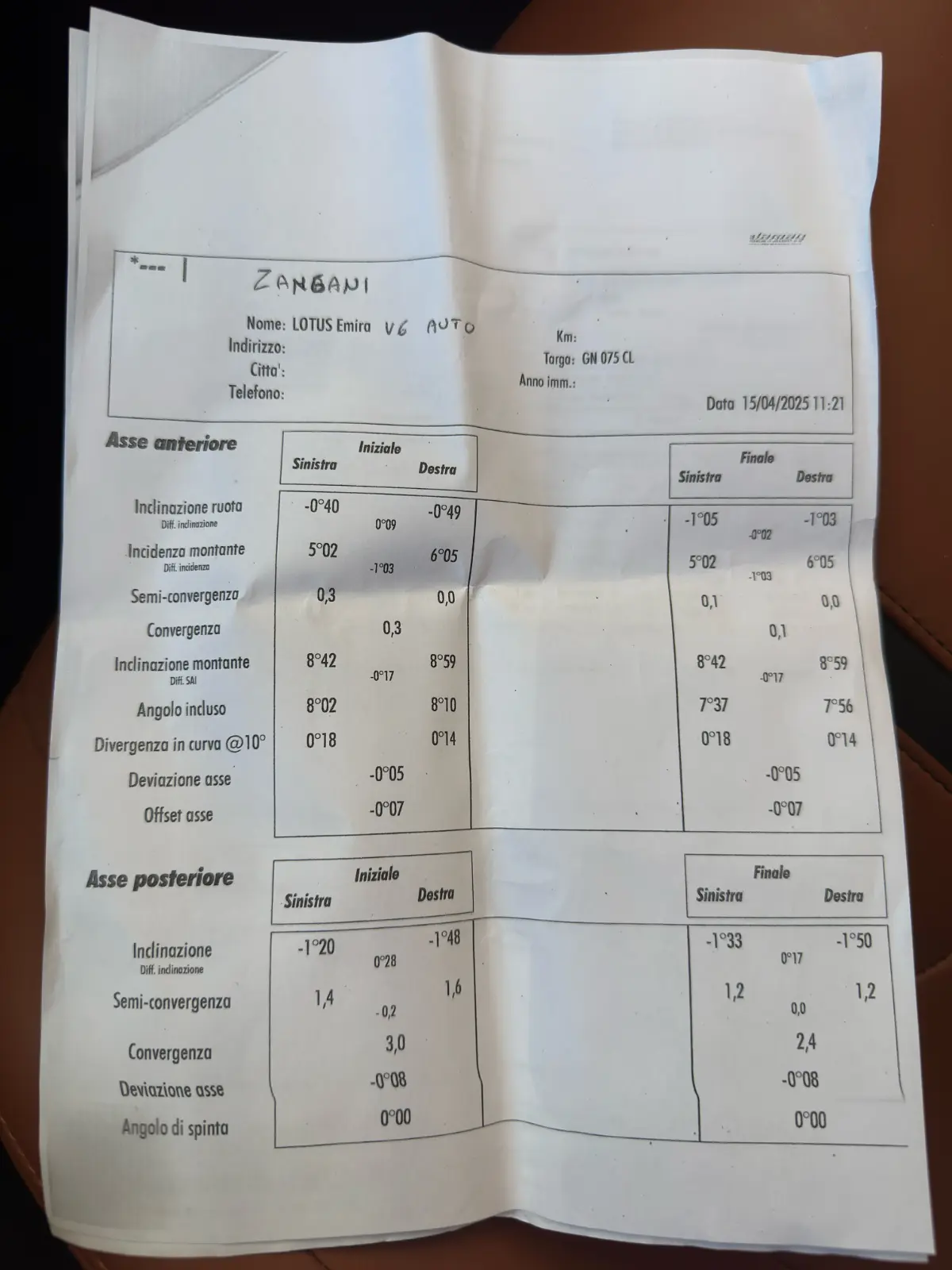

The other day I took back my car from the dealer (PB Raging) in Italy and, since the owner ( Stefano D’Aste) is a racing driver for/with ( I don’t know) Lotus I also asked for new, more drive focused wheels alignment but nothing too extreme, and I asked for the final measurement that shows before, left side, (I’d say “stock” since I haven’t touched anything since I took delivery of it) and after, right side, obviously they are in Italian…
What are your thoughts?
The biggest difference here is more front camber which will result in more front grip during cornering. There is less rear toe in which will make the rear more active during cornering and less stable at high speed. Overall the new setup should understeer less.
