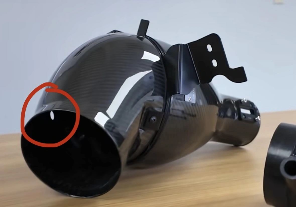

Anyone concerned with installing this with the type of filter it has(no pre-filter)? Comparing this to the stock with the angel hair. Will direct water spray be an issue with the Eventuri one?
Nah, that stuff is never really an issue unless you're going through a torrential hurricane or driving through water higher than your air filter with your foot on the throttle. I wouldn't worry about it and always remove the stock air filter restrictions when I buy a vehicle.. or just buy an aftermarket open air intake.
Guess I should have stated when washing the car...those vents get pretty dirty and I wash them out good with direct spray.
Ah, makes sense. I assume the intake duct work has some drain holes, but I would avoid shooting water directly up the side vents. The filter should sit a little higher than the vent as well, but I'm not 100%. I doubt it's an issue though.
Yeah there is a decent sized drain hole in the eventuri intake housing before the filter.
The factory intake is sealed up nearly the same way but has drain holes as well so its a non issue imo.
