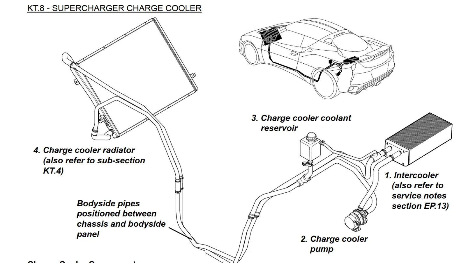

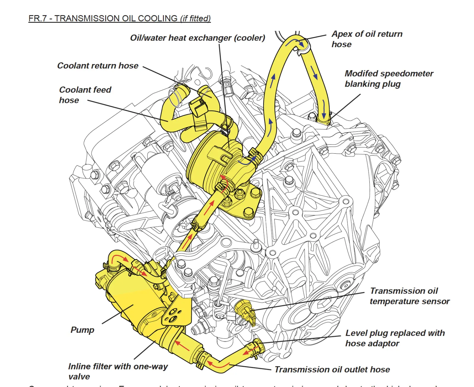

While the driver interface electronics, chassis and interior are different to that of the Evora, the drive train is the same, drive train layout the same and so much has already been learnt over the last 15 yrs of the Evora. Specifically here, LHS intake feeds engine intake and RHS has a fan assist feeding cooling air into engine bay. Air will also feed in from scoops on under tray to cool surrounds of engine, exhaust and transmission flowing up and out side hatch vents and gap at rear of hatch. Forward main radiator provides water coolant for engine and to a water-oil heat exchanger mounted on top of the transmission. SC uses an air-water heat exchanger piped to an other radiator in a nose side duct to cool air intake charge after the supercharger has compresses it. Attachments from Evora Service Manual; while Emira is similar, layout and components will differ so no responsibility for any mis-information.
