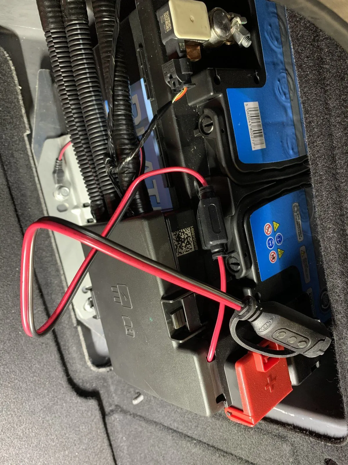

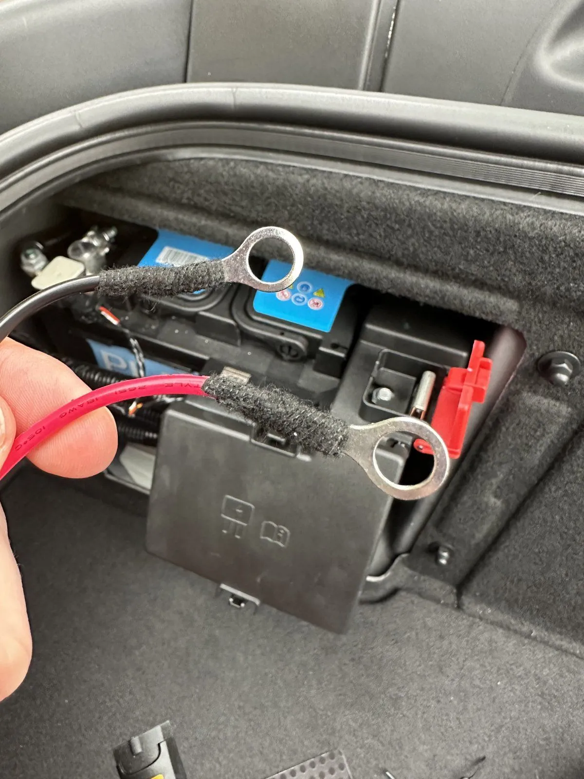

Make sure you wait at least 30 minutes after the car was last turned on before doing this. (I did and had zero errors/warning lights come on) Always disconnect positive first. I didn’t even disrupt the circuit to be honest and the quick connector isn’t a complete circuit as long as it’s not got anything plugged into it.

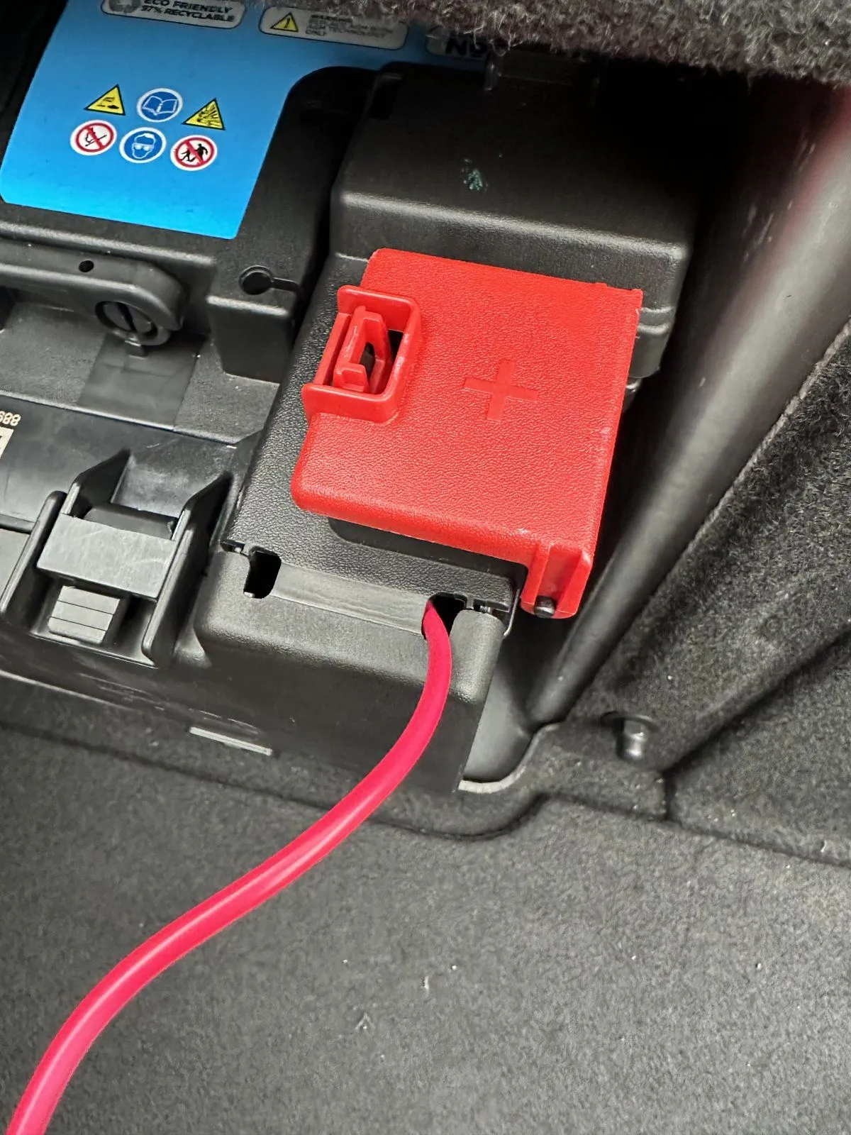

There is a nice gap when the cover goes on for the positive wire to poke through.
The finished position of the wire has to poke out on the left hand side of the boot cover case otherwise the hand tight black nuts won’t go back on if you’re too far to the right.

So to recap, you can attach the CTEK directly to the terminal bolts per photos helpfully attached a few posts back. Turn off car/wait 30 mins, positive then negative connection to ctek (no need to disconnect the battery) and you are good to go?

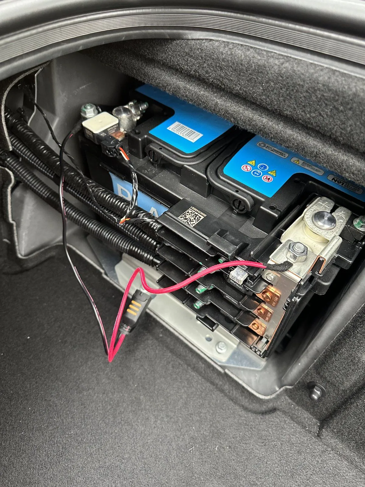

I opened the car doors and the boot and left them open. Put the keys in the house. Waited 30 mins. Removed battery compartment cover (two black nuts)
Removed one of the battery securing bracket bolts. Unclipped the plastic cover over the positive terminal. Spun off the obvious looking nut on the positive side. Popped the the red positive lead on this and re secured the nut. Negative - black cable bolted to the battery clamp using the clamp bolt. (Just noticed the cable looks red in the photo because it’s red on one side, but that is the black cable on the clamp). Plastic cover back on the positive side feeding the cable through the little gap. Replace battery compartment cover.
I opened the car doors and the boot and left them open. Put the keys in the house. Waited 30 mins. Removed battery compartment cover (two black nuts) View attachment 22769Removed one of the battery securing bracket bolts. Unclipped the plastic cover over the positive terminal. Spun off the obvious looking nut on the positive side. Popped the the red positive lead on this and re secured the nut. Negative - black cable bolted to the battery clamp using the clamp bolt. (Just noticed the cable looks red in the photo because it’s red on one side, but that is the black cable on the clamp). Plastic cover back on the positive side feeding the cable through the little gap. Replace battery compartment cover.

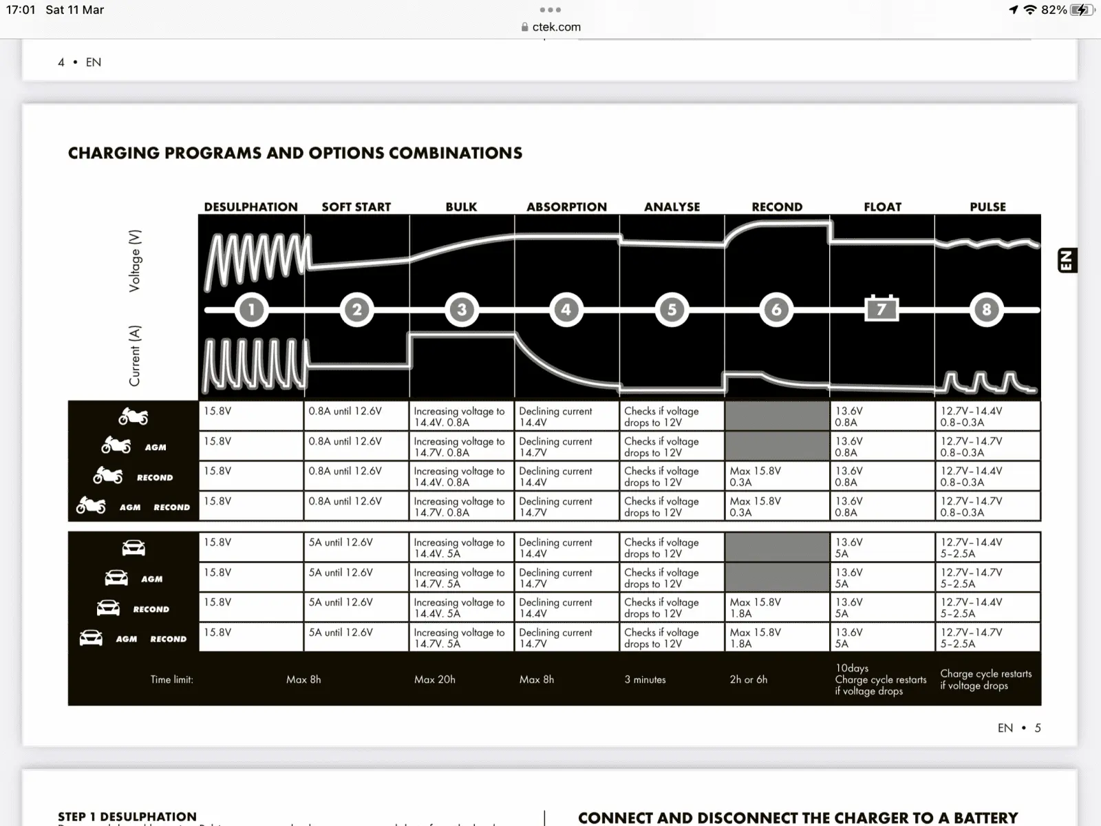

I did exactly this setup on my car now and measured 13,0V on the connecting cable. However if I connect my Noco Genius 5 to the battery, it states that the battery is empty and starts charging. I selected AGM on the charger. Has anybody an idea what's wrong there?
Don’t know much about the Nocos but the CTEK will charge at 14.7 volts. Even if I connect to a fully charged battery it will still go through its analysis cycle.
These smart chargers look after themselves generally so I would leave it connected for a bit and see what happens. Assumes you have connected the cables the right way around (sorry that was not meant to be patronising) but I think the smart charger would let you know that too.
You're right, it "fixed" itself. Just took 40 minutes or so and then the charger stated that the battery is fully charged and switched to maintenance mode.

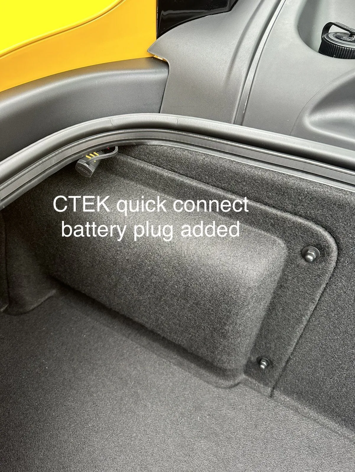

I've fitted my Ctek connector to my battery but just wondered how they route any extension cable to their trickle charger when the boot is closed and the car is locked? Do you just shut the boot down on top of the cable?
That’s right. Just avoid the part of the boot where the lock mechanism is. My trickle charger is outside the boot so it’s only the thinner low voltage cable going through the seal.
I sit my ctek on the engine window and run the cable under the window (where the water drains) then into boot. Means I am not stressing the boot seals/lock.
