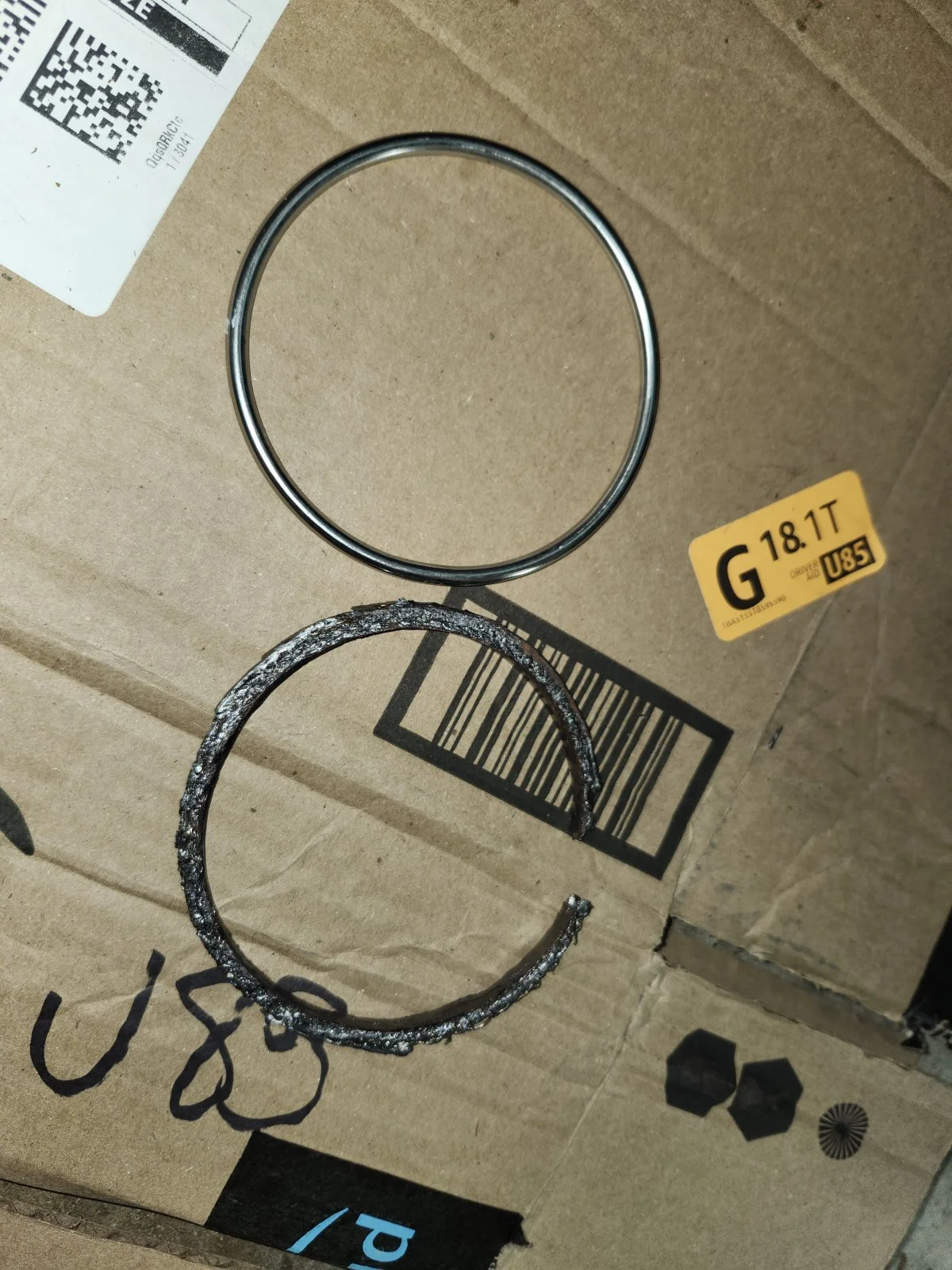

Yeah, day 1 of mine too, very happy (GRP product). I highly recommend buying the new gasket with the pipe, mine looked like old dirty solder after only 400 miles....
Yeah. I advise anyone doing this mod to also buy the gasket. I missed this and Lotus had to do a patch up of my OEM one. My bad.

Yep. Make sure you have an exhaust flange gasket. The one coming off the current CAT is unusable.

My gasket was hammered after only a few hundred miles and I took a pick and 3M green pads to make sure all of the gasket material was off of the y-pipe before reassembling.

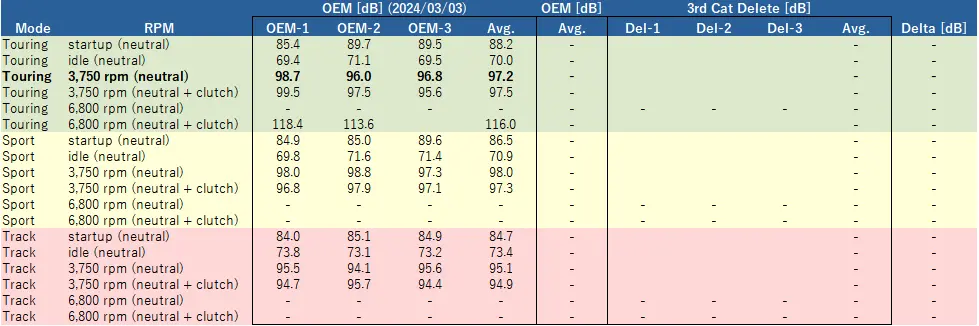

Not yet. I will when my pending parts are delivered. I couldn't find the right allen socket last time and substituted a torx instead - bad idea - ruining multiple bolts on the underside. The measurements will need to be done with full underside installed, just like how it will be done at the vehicle inspections in Japan.
No ETA, but when the parts arrive, I will need to redo the OEM measurements, as the car has since "matured" and the weather has changed too. My neighbors will not like this 😆
If anyone can do something similar, that will be great (my neighbors will thank you). The individual decibel readings do not need to be really really really accurate - no need for an expensive, fully calibrated sound level meter. The delta is what I'm looking for.

Interesting that your measurements show Track to be 3db quieter than "road-going" modes (halfway up the range) ... I wonder if the valve actuation is tuned for places like the UK, where circuit noise limits are lower 🤔
I was puzzled with that too, but didn't give it much thought after realizing that I had ruined some hardware.
My objective is to see how far off the decat pipe would bring us from vehicle inspection standards (3,750 rpm in Tour mode, including burbles and pops after lifting off the gas), so you can see that I had not continued to measure the higher revs in Sport and Track modes.

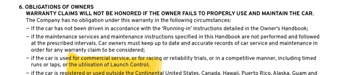

Removal of the “underfloor” cat (3rd cat) was specifically called out in the USA warranty handbook. It voids the warranty. Otherwise Lotus offers 8yrs 80k miles on certain emissions items.
Voids what part of warranty? Complete?
The emissions control warranty which includes the TCM and ECM. Oddly enough utilizing the launch control feature voids the entire warranty. Like why have it then???
Launch Control not being covered by warranty reminds me of when the Nissan R35 GT-R first came out.
