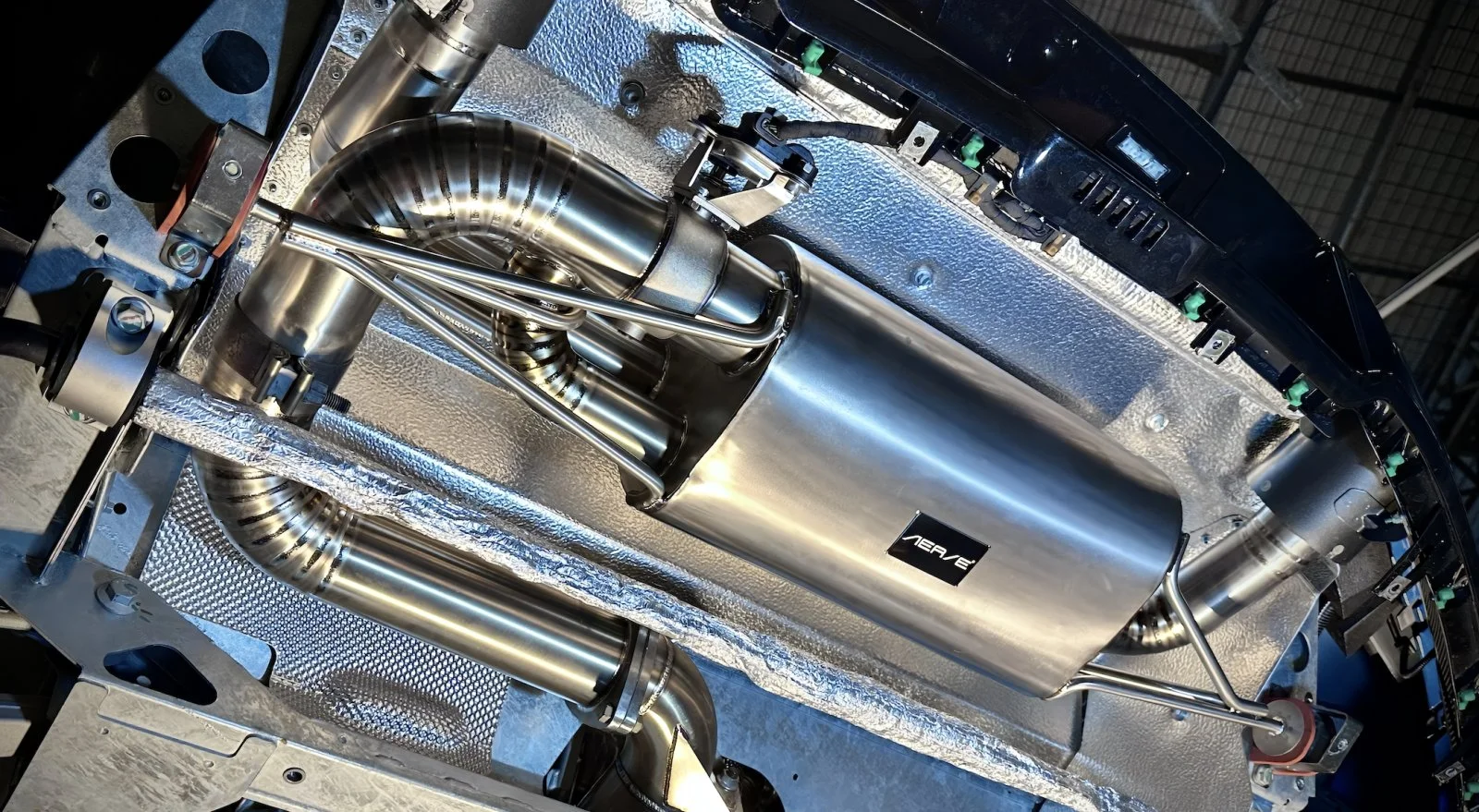

.... just want to reduce the temperature in the boot by a few degrees.
Forgive me if I'm misinterpreting, but I think your exhaust is going to make sure that boot temps stay where they are, regardless of engine coolant temp.
There's heat shield material there from the factory, but I'm not sure how effective it is.
I got some of this stuff: https://www.secondskinaudio.com/heat-insulation/mega-block which I'm going to put above and behind the muffler and the 3rd cat (this pic shows the delete pipe is there).
