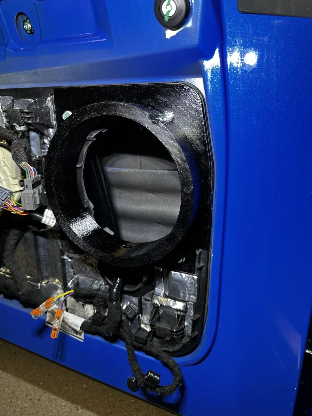

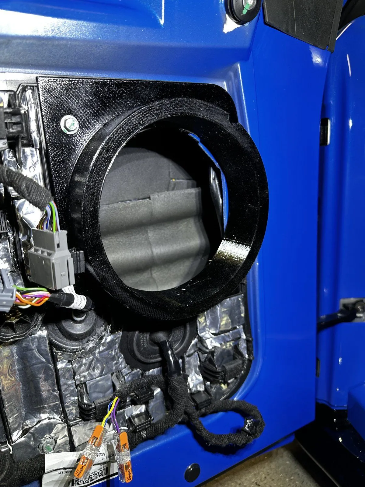

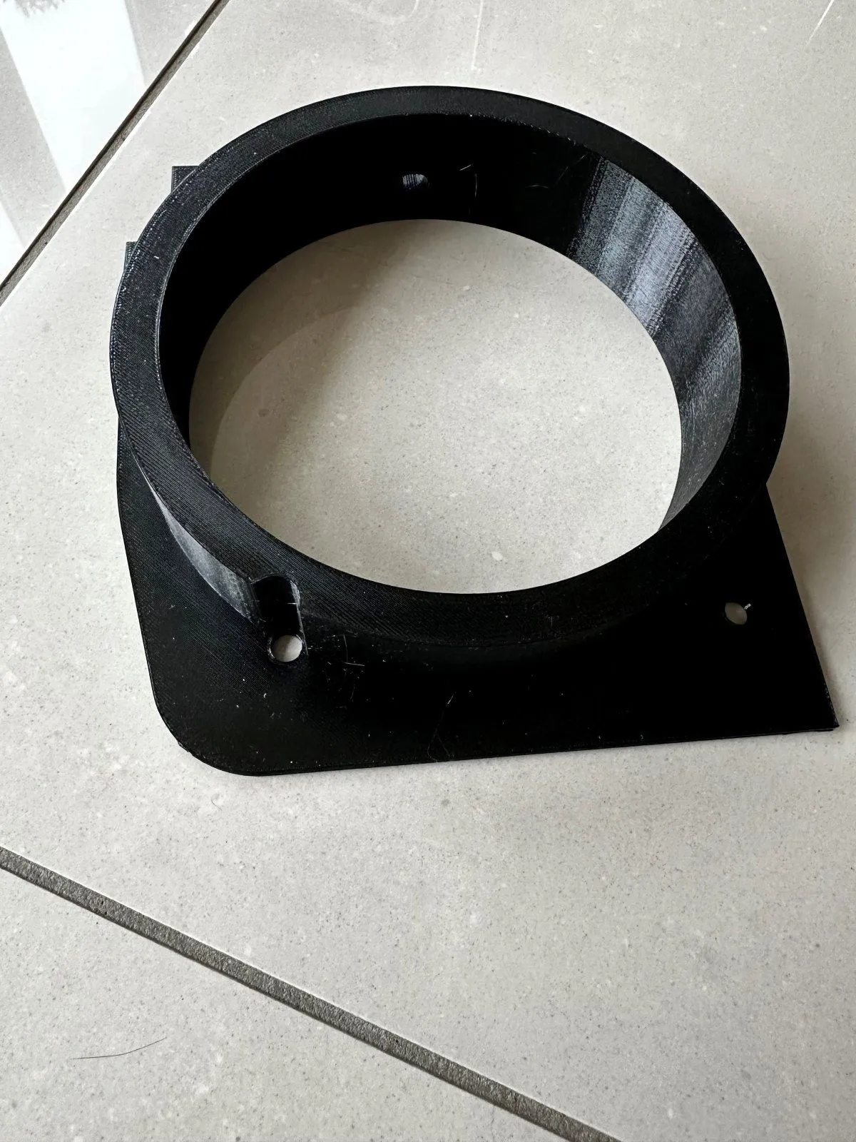

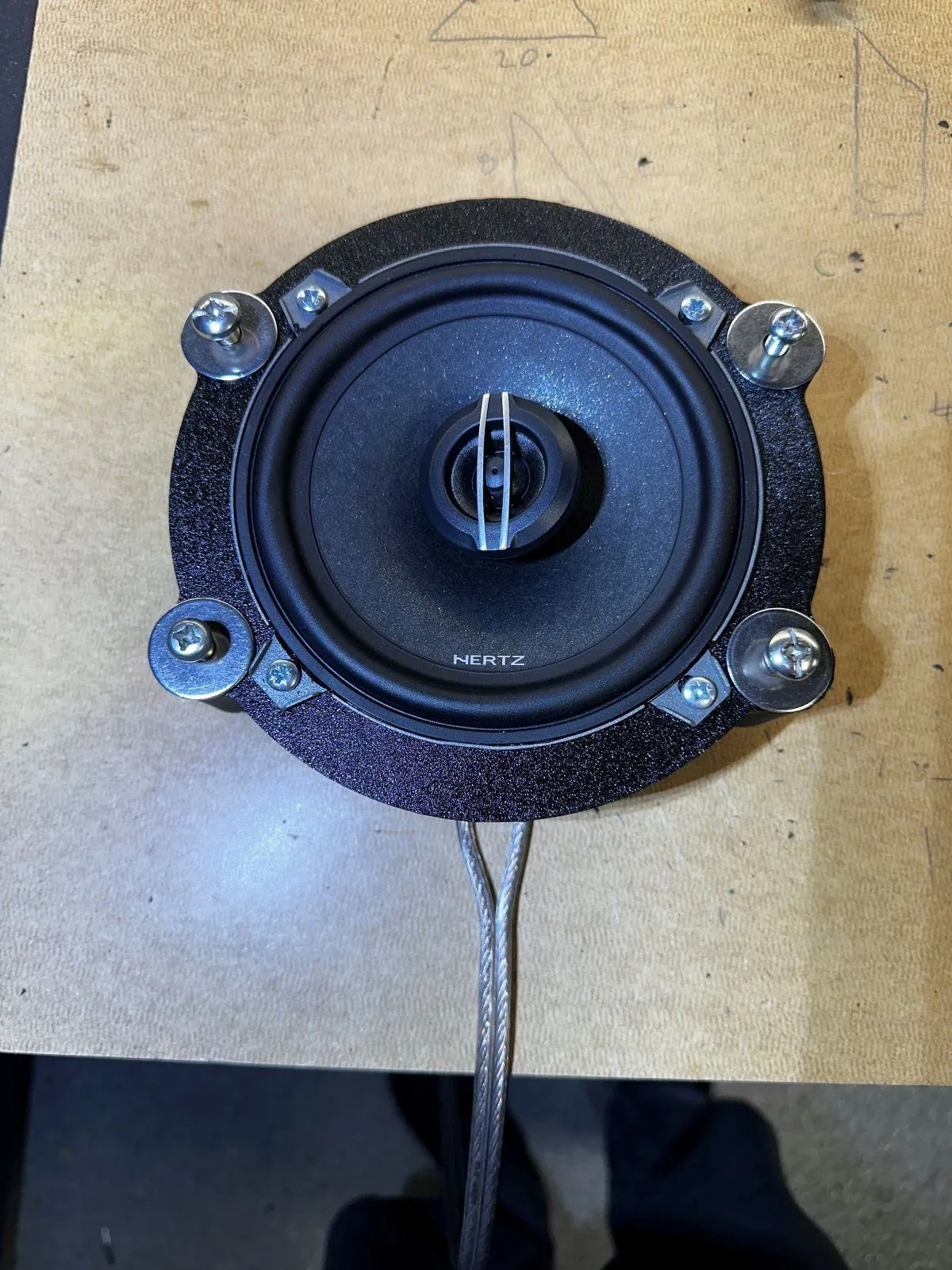

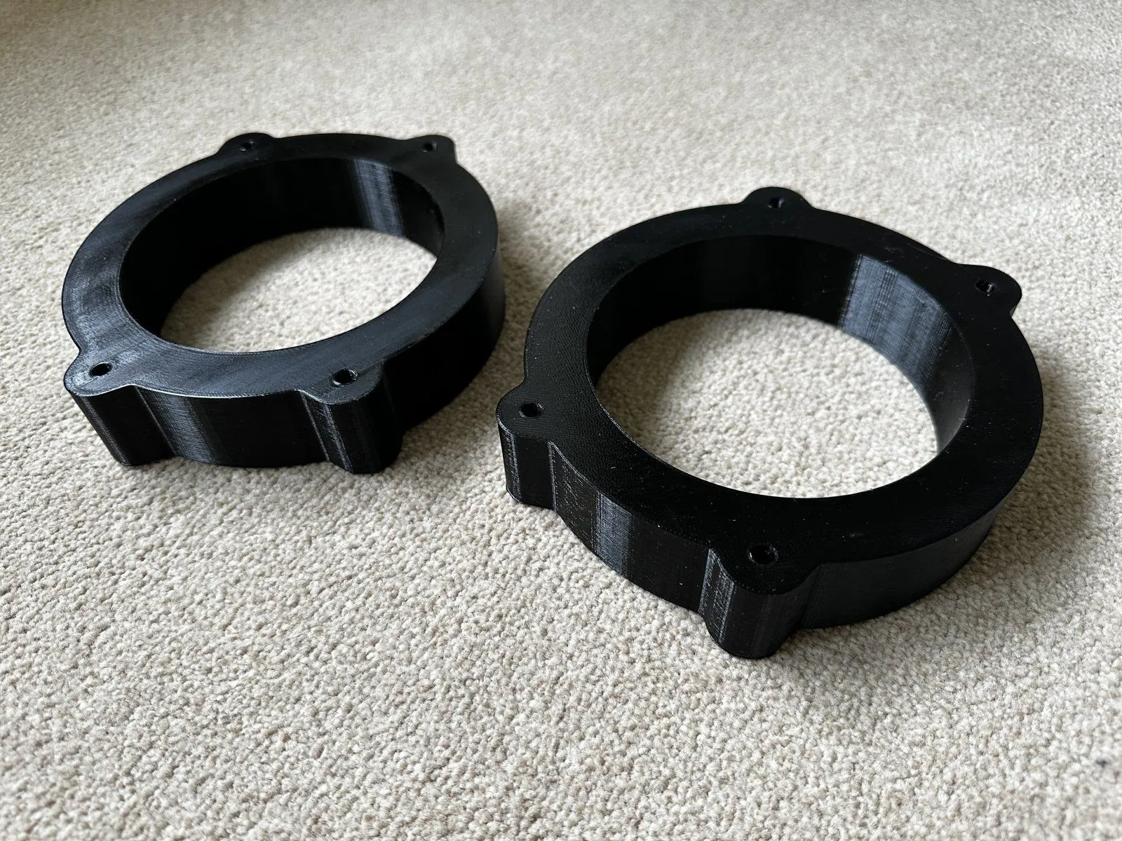

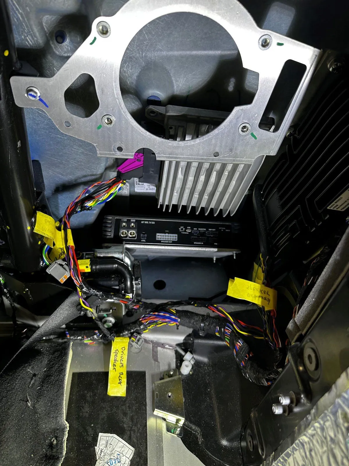

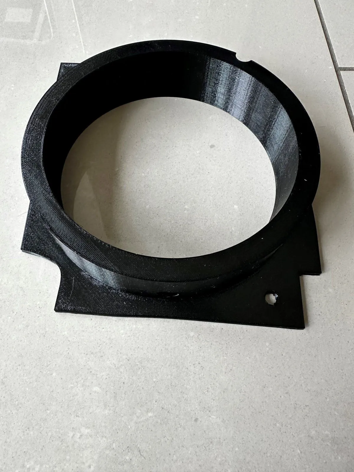

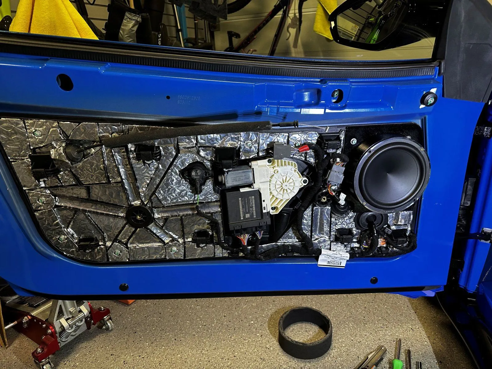

As promised, here are the final 3D printed versions of the front and rear speaker mounts, & Amp Mount, allowing you to upgrade your KEF audio to a far superior system. The front mounts allow you to transform from a 3" speaker to any 6.5" speaker, and the rear mounts allow you to install any far superior 5" speaker.
I’m able to produce both front and rear mounts on demand at a cost of £435 (Including postage if you’re within the UK). The mounts are 3D printed at 100% infill, not hollow or honeycomb.

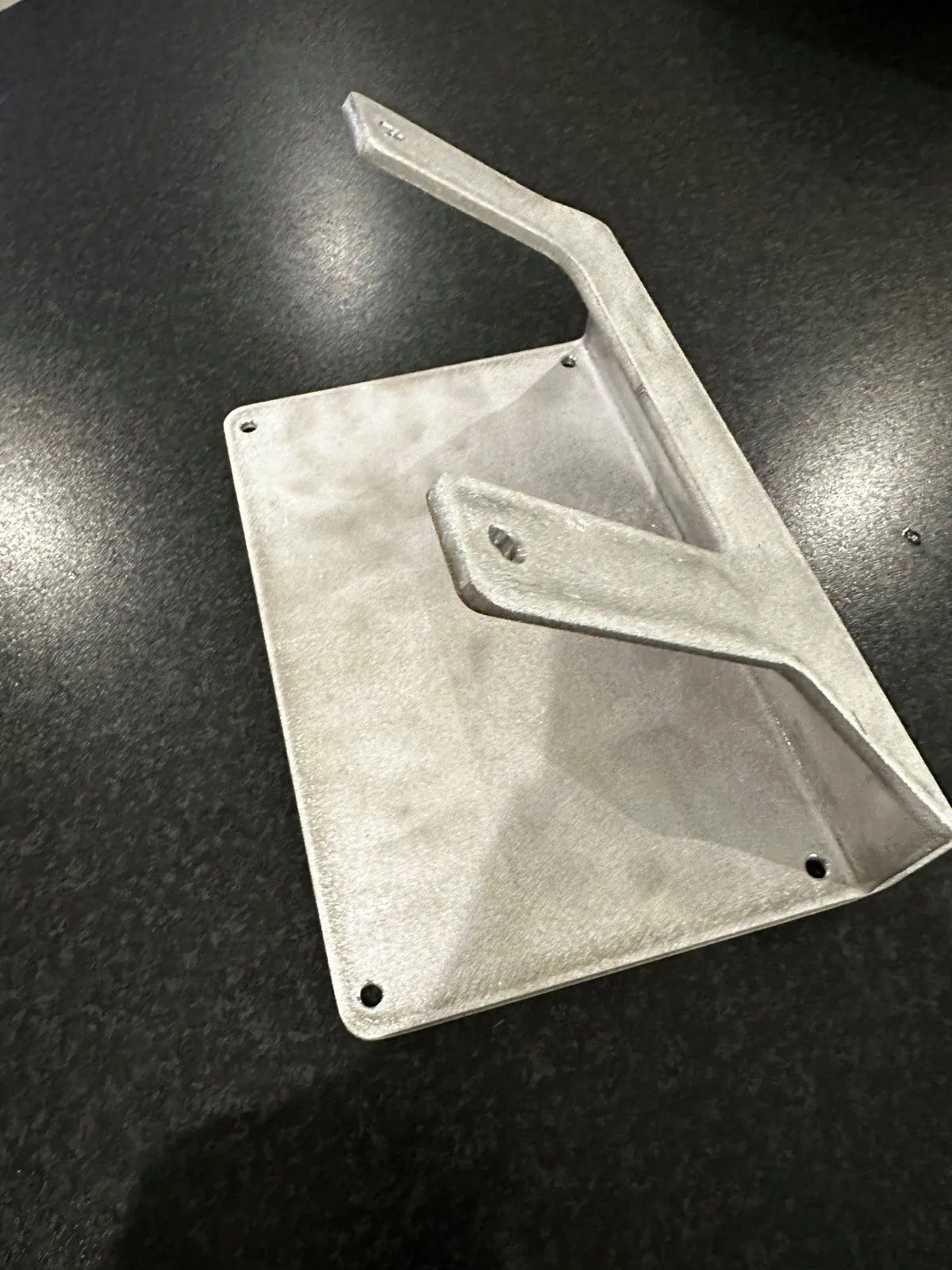

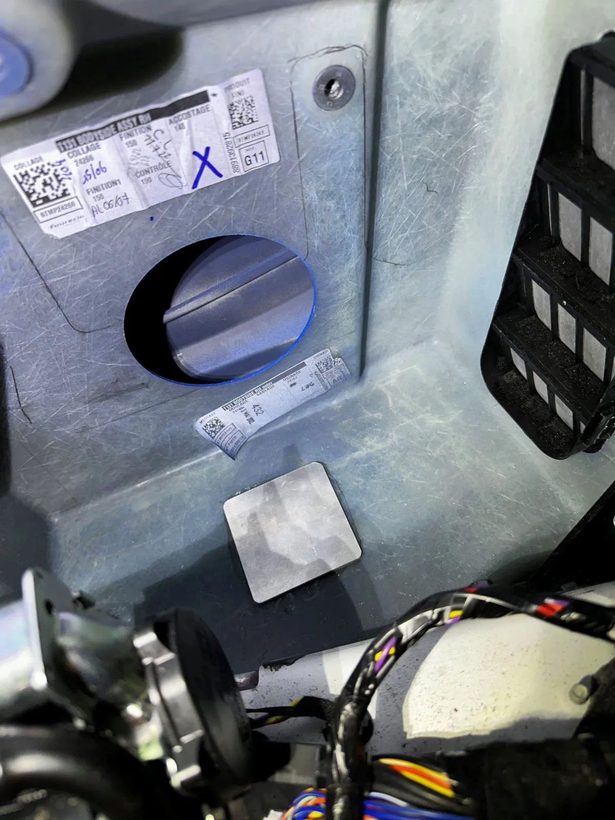

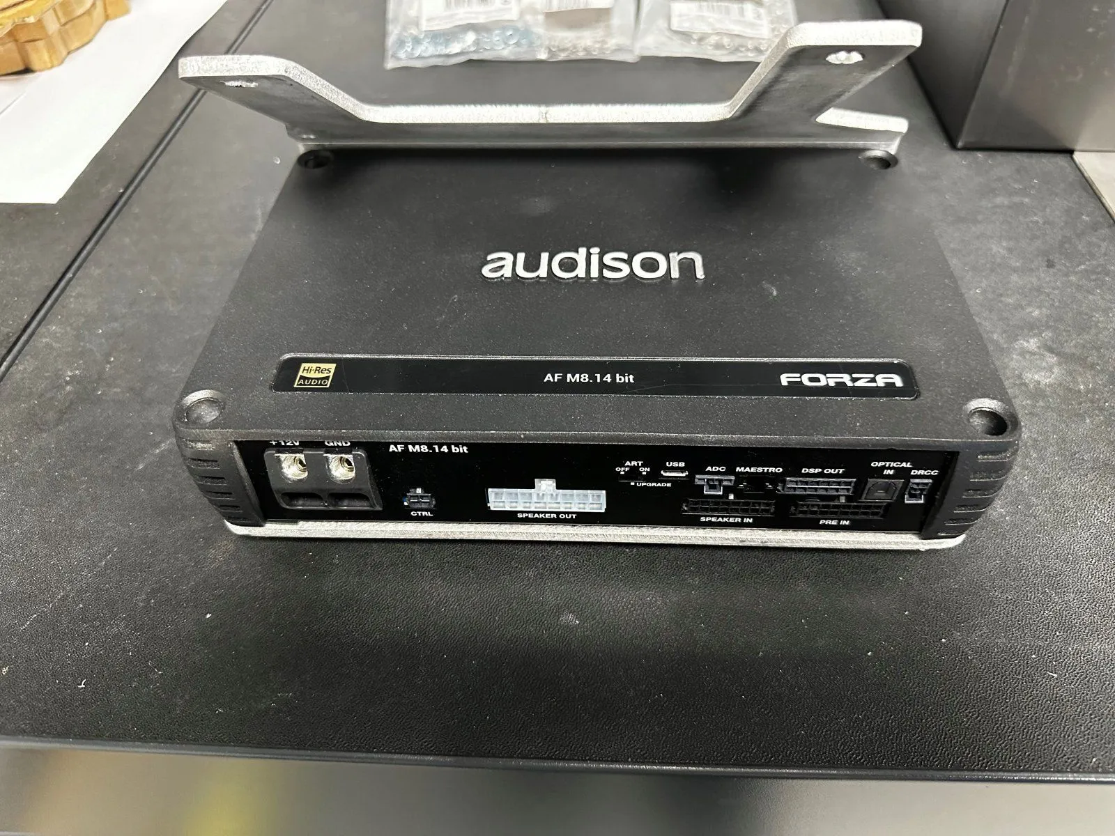

The amp mount can also be produced upon request for £180, (formed from a single sheet of 5mm aluminium, plasma cut & folded into the perfect shape to mount in place of the cars original sub). All holes are pre-drilled and it’s made to take any Audison Forza amp. A 70mm Stainless-steel blanking plate (to cover the bottom free-to-air sub drain-hole).
Speaker wiring colour codes will also be included, saving you hours of time.
I’ve personally completed this upgrade to my own Emira and the difference is night and day – If you enjoy your music as much as the car, then this upgrade is definitely worth it!
I’m sure there will be many questions, and hopefully I’ll have all of the answers as the installation was completed by myself (plus taken 100’s of pictures along the way should these also be of interest).

Would you be able to share the 3D files for those of us that have a 3D printer?
  • #7
Would you be able to share the #d files for those of us that have a 3D printer?
Unfortunately the answer is no....
Sorry to sound harsh, however, as you have your own 3D printer you'll know & understand it's not just as simple as drawing and printing such specialized parts.
Many hrs have gone into the design, development & trials with different types of material to ensure the end product is robust & will last on sport suspension.
The mounts are 100% infill, not partially hollow / honeycomb 50% or 20%, these were the prototypes which I wouldn't offer for sale due to a risk of failure.

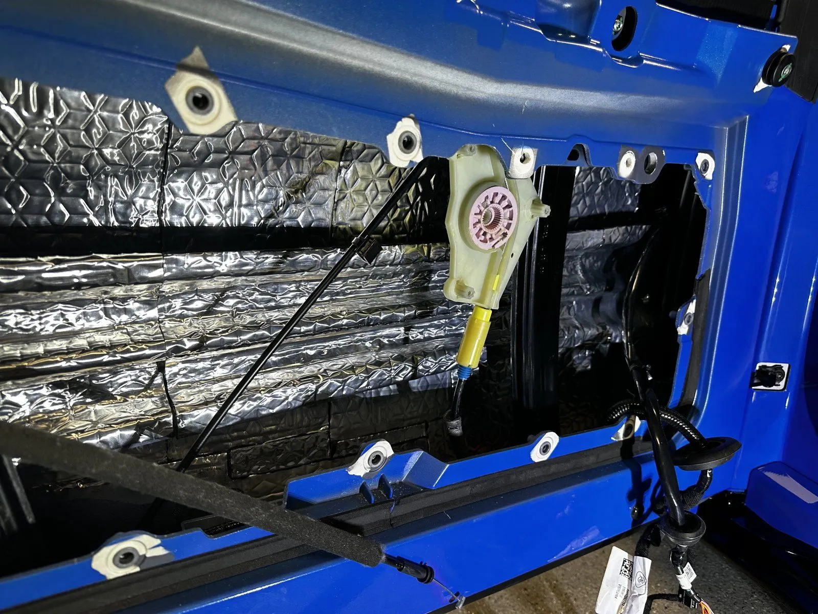

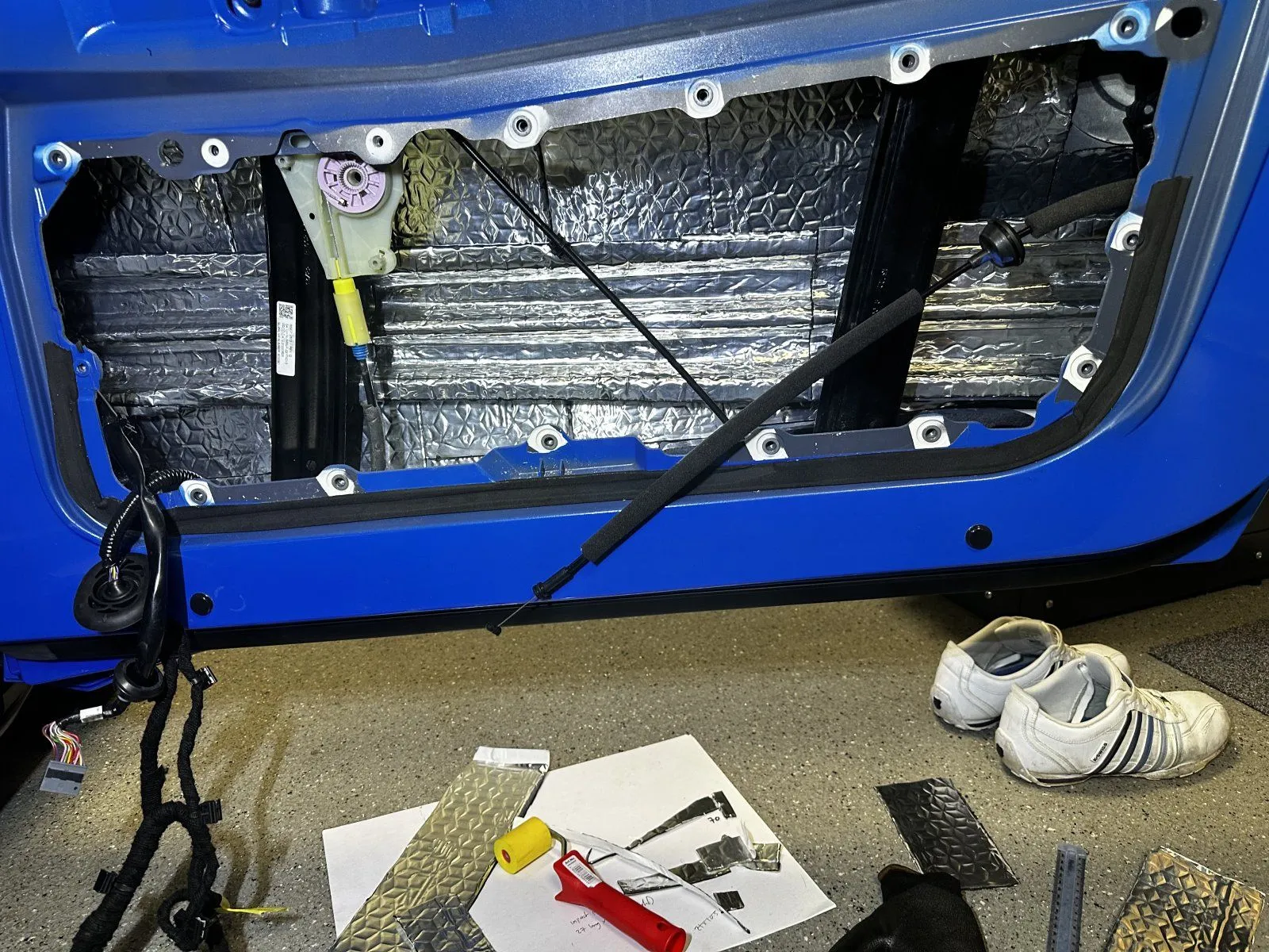

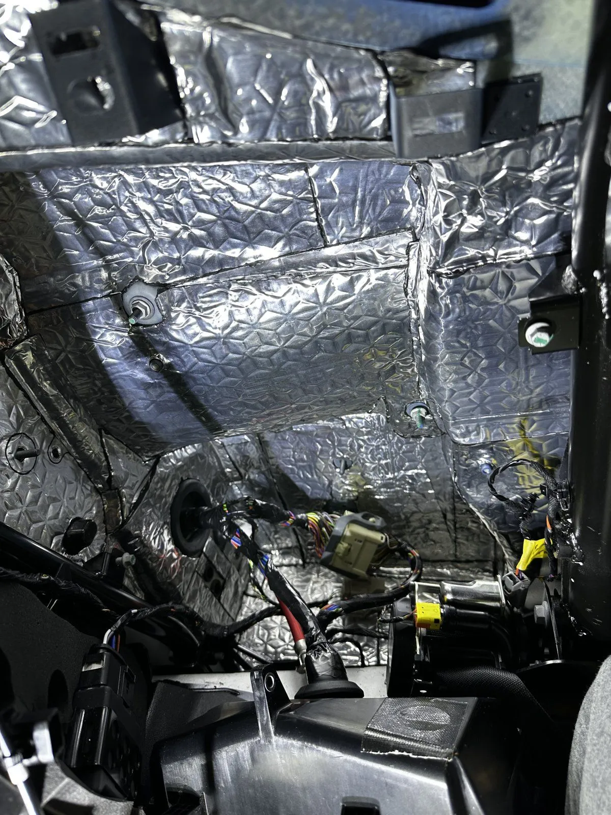

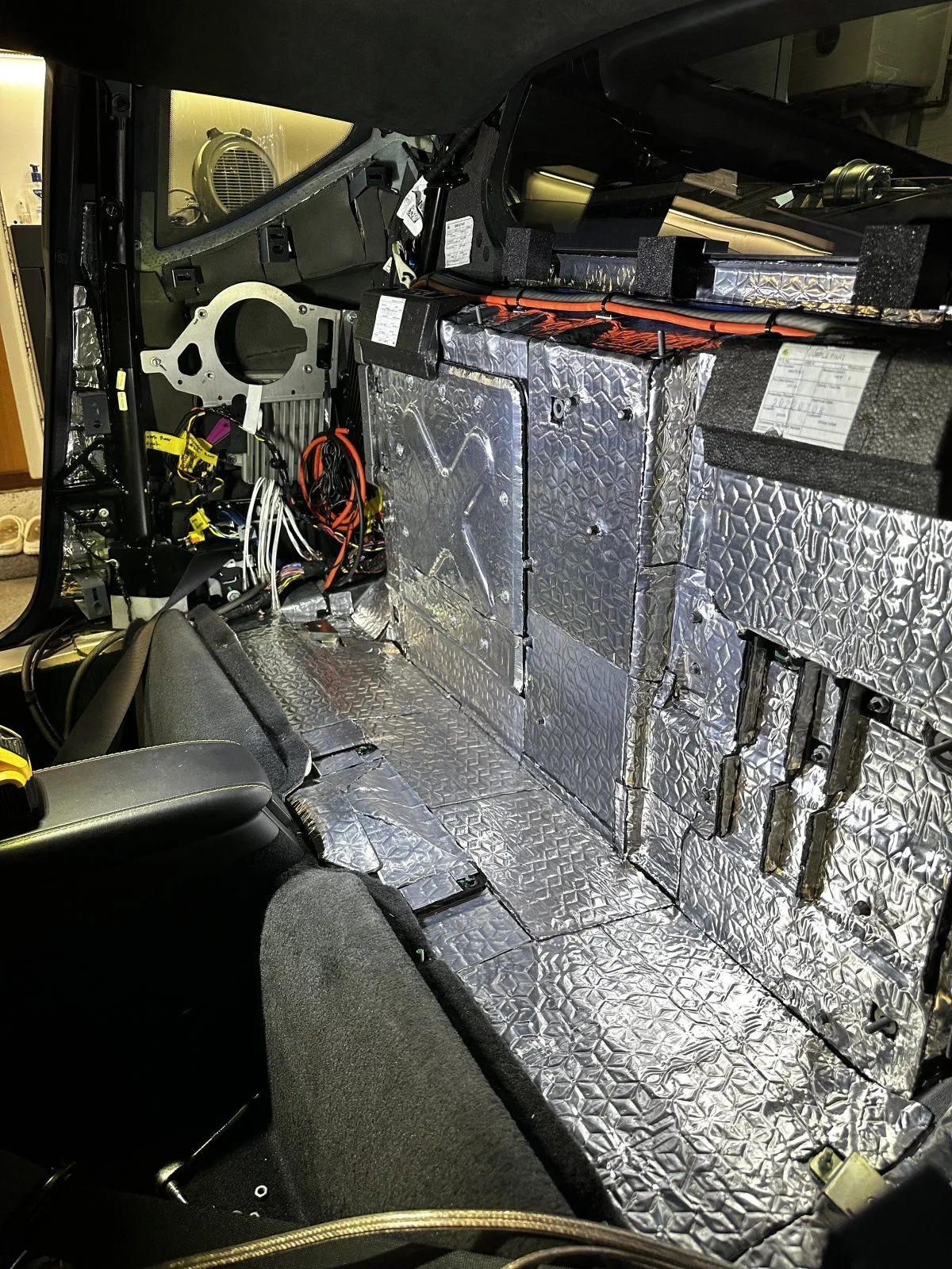

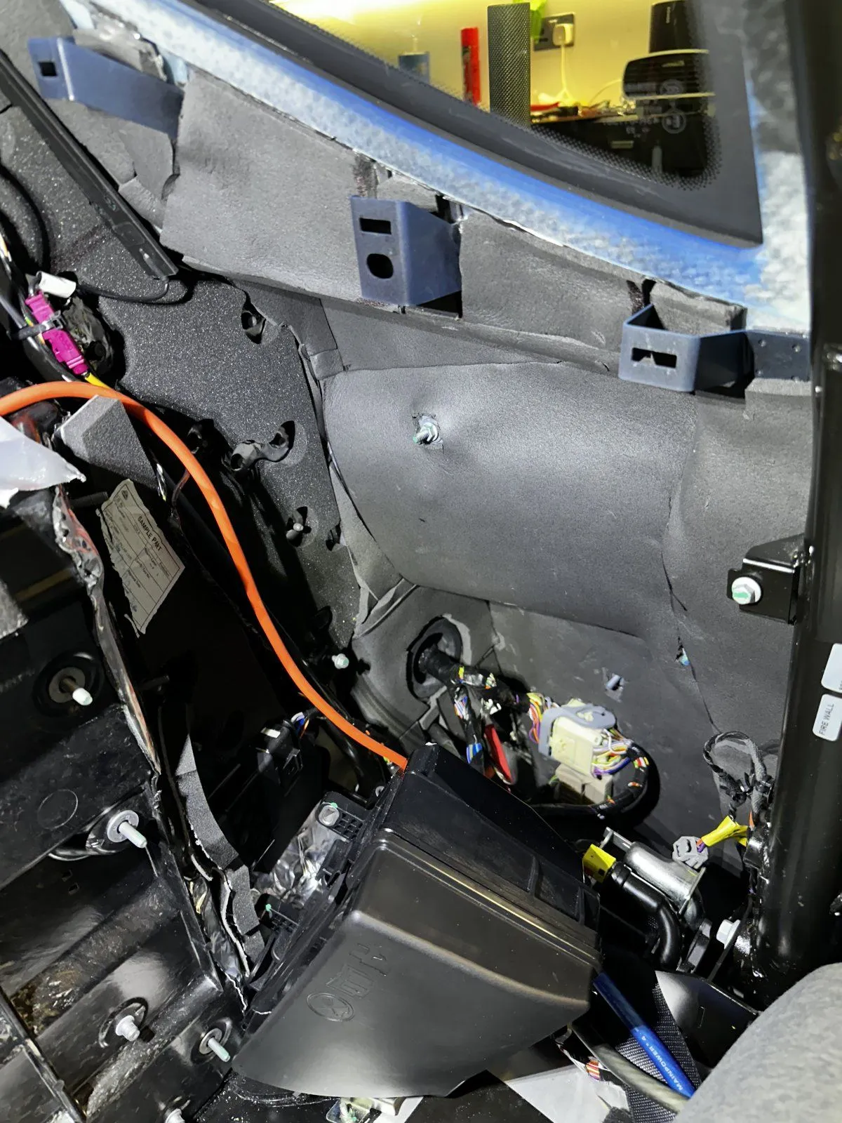

Did you install all that sound deadening in the door and on the bulkhead , or is that stock?
I believe he did that after, as the EMIRA does not come with sound deadening.

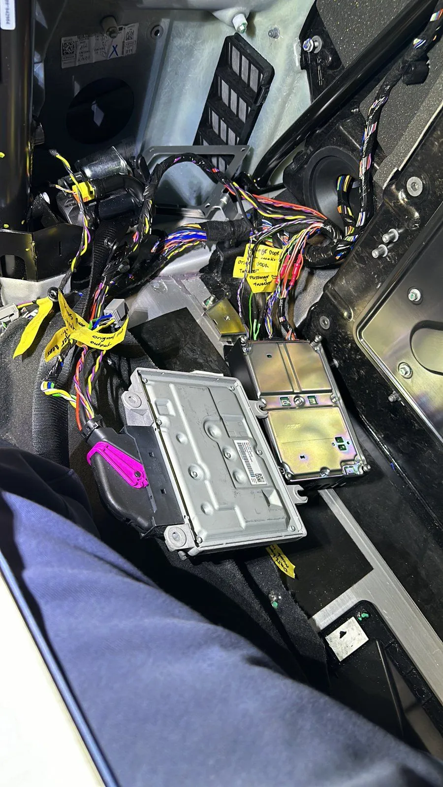

Thank you for really going in depth on the whole process! I was interested in attempting a similar project on an Evora (and now Emira instead), but the amount of work you've done to take apart the vehicle has me a bit more hesitant. Do you have a rough estimate of hours necessary to take everything apart and any difficulties with wiring?
I would estimate the complete installation would take around 1 week if I'd had the speaker mounts, amp mount & wiring colour codes. If I'm honest, it was the sound deadening that took the most time to install due to the curves in the rear of the car.
No difficulties with the wiring, everything is easily accessible once all trim is removed.
I ran x2 power cables and x1 earth direct from the battery, but again, good access once the left-hand rear wheel and arch liner is removed.
  • #19
Correct, what you can see in the photos is what I have installed. The car doesn't have any in the doors as standard. You do get a bit of suck-on foam in the rear around the engine access cover (behind the drivers seat), but that is all - this peels off quite easy in one piece. I've re-used this because the trims are made to take the 2cm foam.

What material are you using for the print? PET CF?
Hi - Yes, it's a type of PET CF, but reinforced. There are many variations of this material - rest assured only high-quality material is used.
