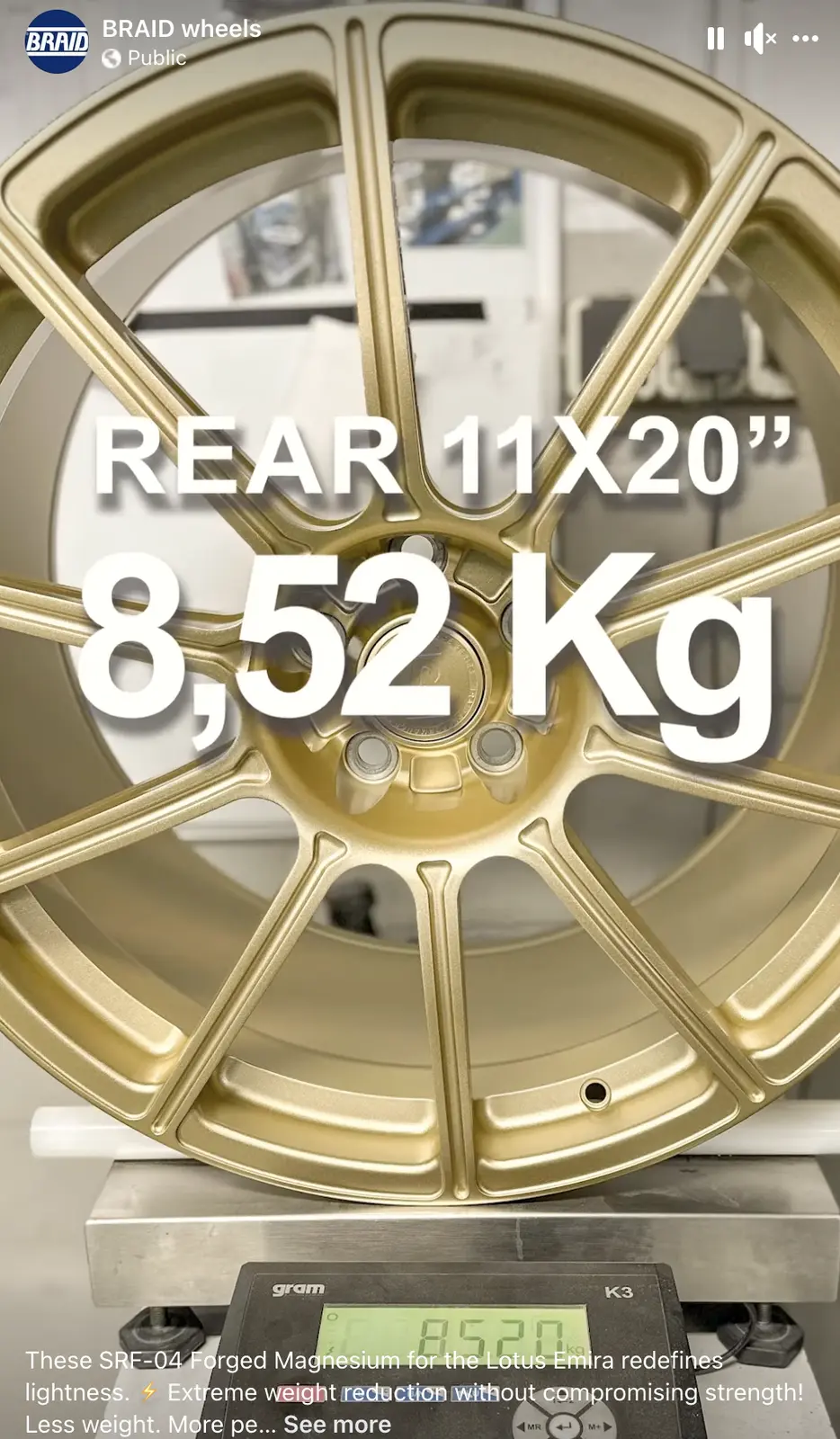

One thing to consider is most manufacturers when stated from a weight that is for the smallest width on that size. When I was looking for wheels one stated from 18 pounds for the 19s but in our width it was 21.3. I would get them to show the wheel on a scale and commit to a weight in writing. For that kind of money they wanna be super light and strong.
Never thought to ask that question since the wheels will be a custom size. It will be interesting to see what the weight difference will be compared to other wheels in the same size and width.
