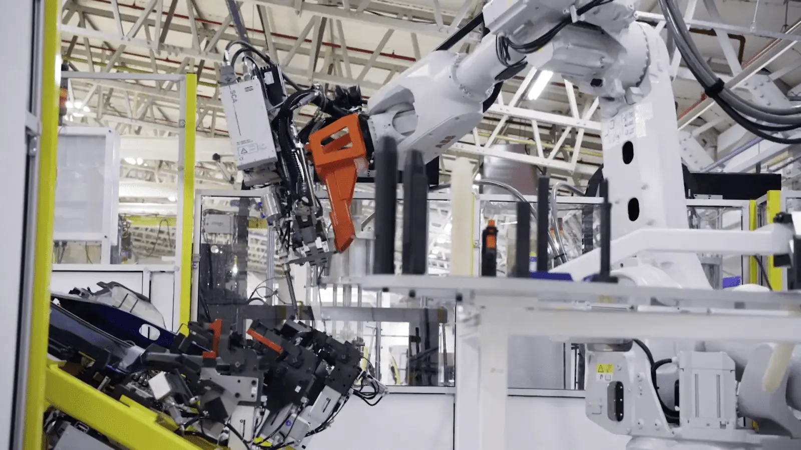

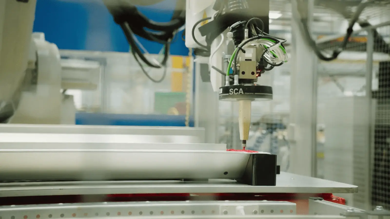

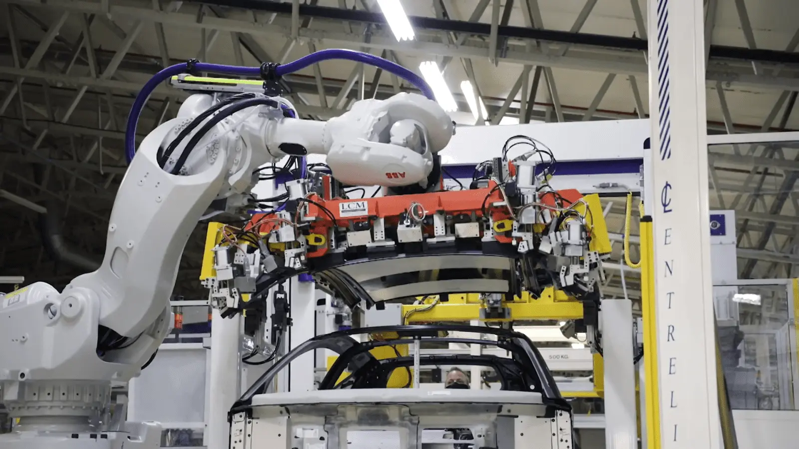

The bonding machine is in the main production facility at Hethel and glues the panels to the chassis. The chassis and sub-frames are built at a different facility nearby in Norwich. I don't think that's been shown on any of the YouTuber videos but I think was in the "Lotus: New Dawn" TV programme. I believe the constraint there is the physical size and layout of the facility versus being able to increase the throughput.
There are several different bonding robots. Here are three that were shown in the New Dawn documentary...
Thanks. I believe the second two pictures are of the same large robot, which has multiple arms and is used to apply the adhesive and fit the panels? The roof is the same in both and is at Hethel. The first one looks like chassis and has different safety screens, so could be Norwich.
