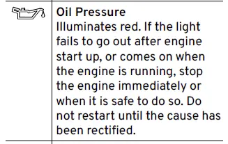

I can’t find this anywhere in the display. Surely Lotus wouldn’t miss this off a driver’s car, would they?

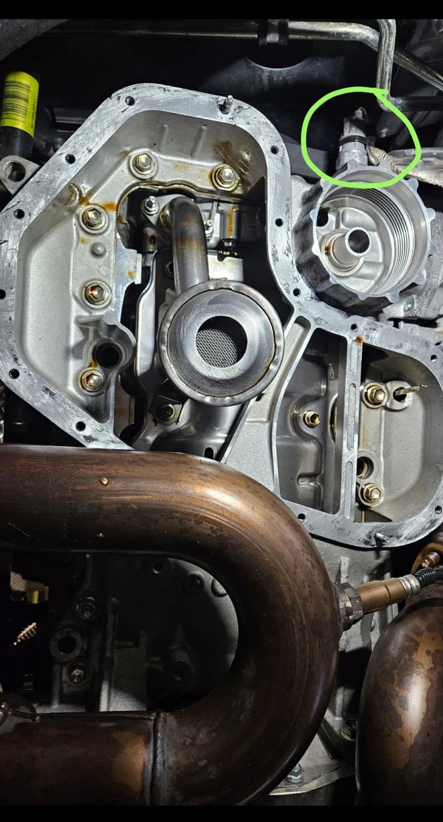

The 2GR-FE should have a sensor in this red circle, but I have never actually seen it, so I do not know if it is there or not.
However, even if Emira does not have a sensor, there should be a hole to install it.

Just checked my photos from when I replaced my Evora GT pan and sure enough, there's a sensor right there.

It may be a mistake to describe it as a sensor.
I think it is a simple switch that turns on when oil pressure is applied and turns off when it is not.
Therefore, I don't think it can accurately measure the current oil pressure.

Correct, and most people who want to integrate an oil pressure sensor can just use a 1/8" BSPT tee or adapter.
Something like this https://www.glowshiftdirect.com/1-8-bspt-oil-sensor-thread-adapter-for-gt86/
This should screw into the 1/8" BSPT port on the 2GR-FE, and have the stock pressure switch plug into the female 1/8" BSPT at the end of the adapter. Then you have two 1/8" -27 NPT ports on the sides of the adapter for an oil pressure and oil temperature sensor that you can remote mount (as not to add extra pressure to the fitting).
