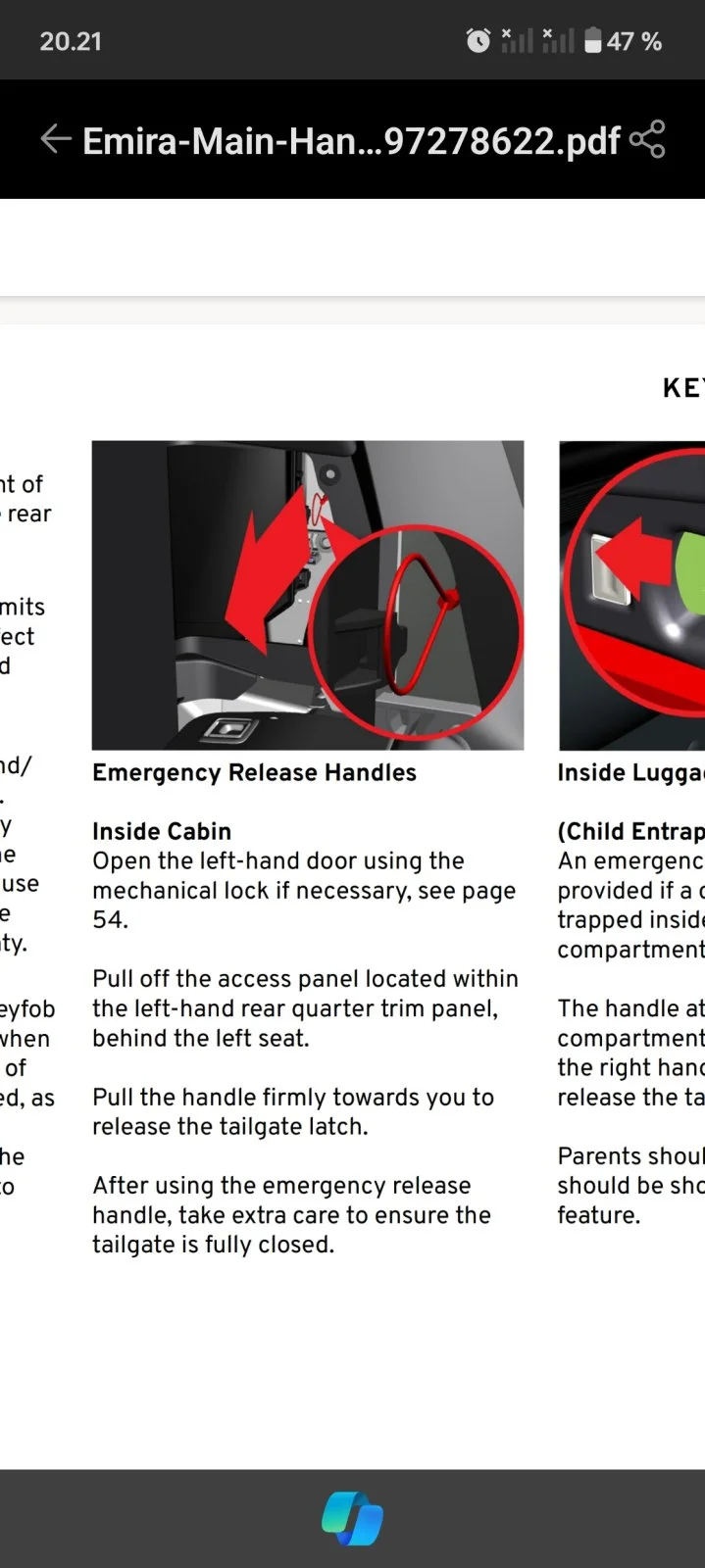

Hi, I run out of battery and I am trying to access the tailgate using the emergency handle.
The manual says to look behind the left seat under the rear trim.
But I can't see a red handle there, as to charge the battery afterwards 🙁
Am I looking in the wrong place?

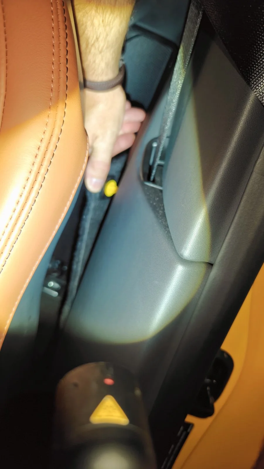

The "pull cord" on my Emira was a black loop (not red, as mentioned in the manual) and it was located more along the side of the open panel area, as opposed to reaching down inside and towards the back of the vehicle. So once you pull back the panel behind the left seat, check along the side of the vehicle...and look for a different coloured loop. You should also be able to feel it there, w/o actually seeing it. I took delivery of my Emira on June 6/24 and if yours had a similar newer production date, perhaps it's the same set-up. Good luck and a big hello from Canada to Budapest (I'll be vacationing there in October)!

I'm attaching a photo of the location of the hidden lever (on the side trim behind the seat) in case, another driver faces the same issue in the future.
