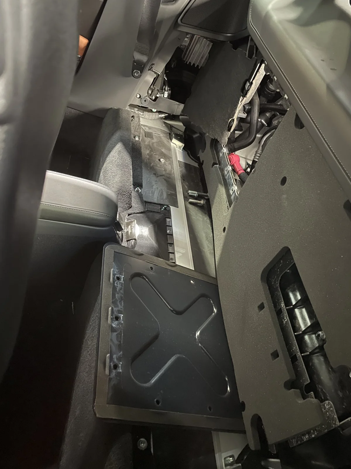

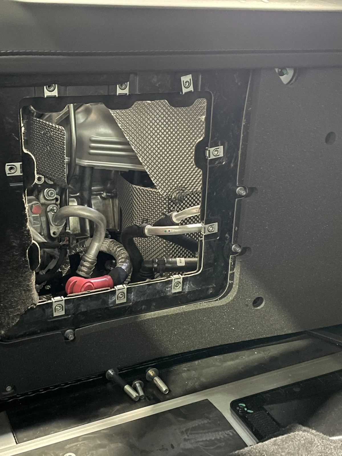

I don’t think so unless you remove the back bay and open up the engine compartment. See pics.
