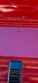

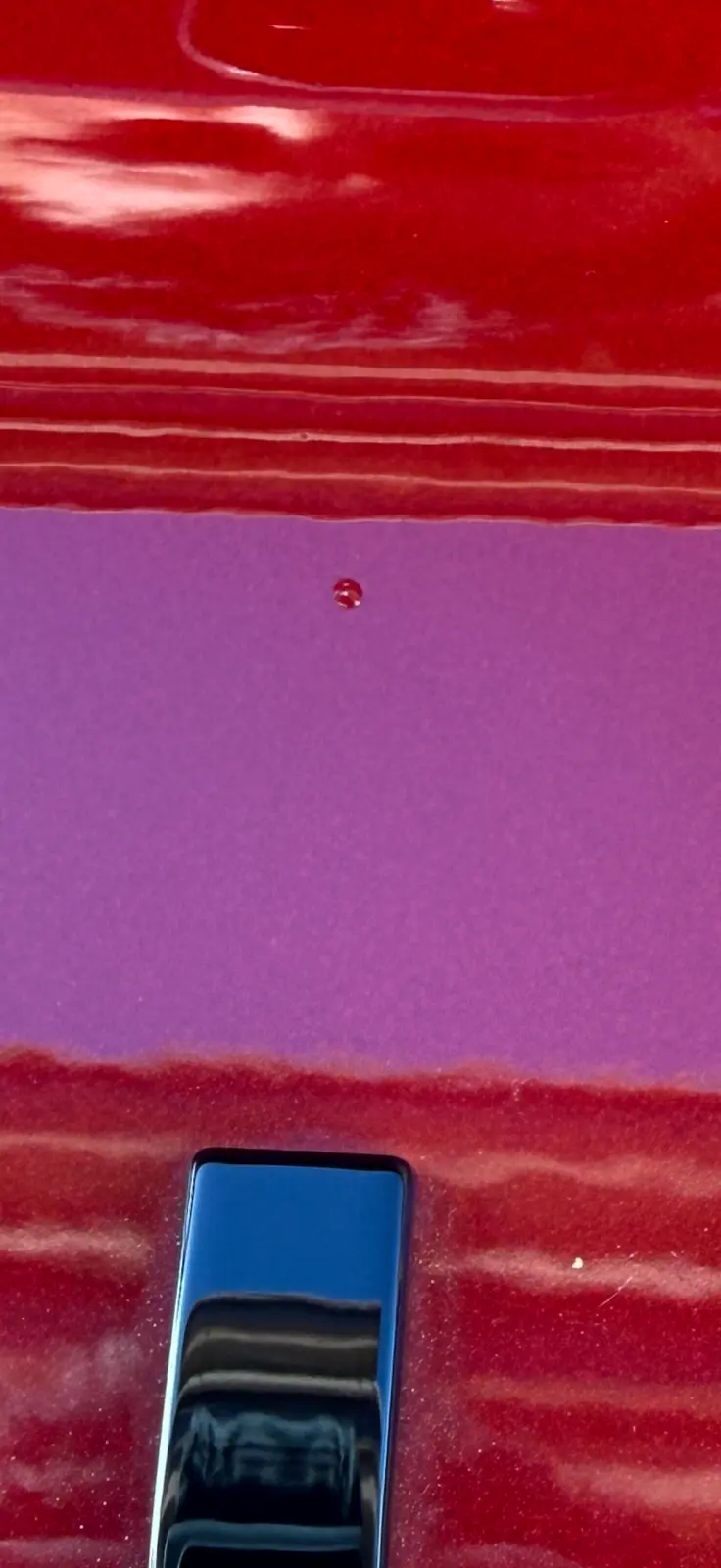

USA Jan 2024 build. Just got the car used with 400 miles last month. Got it back today from paint correction and coating and noticed this above the U on the back. Can’t tell if this is the bubbling everyone is talking about or ceramic coating related.

I don’t think the trunk lid is the same supplier as the doors, and therefore would not be related to this (but clearly a paint defect).
It's the same supplier, though not a common area for issues compared to doors and rear quarter panels.
Teijin is providing the doors, rear quarter panels, and the inner, outer and lower shells of the tailgate.
The bumper is made of ABS — not a glass reinforced plastic like the bubbling substrate panels issue. This is just a different type of problem.
You're right, falafel91 mistakenly described the blister as being "on the trunk lid" but looking more closely it's on the rear panel. The rear panel/bumper is not made by Teijin.
Yes you are right. Not trunk lid sorry but the rear panel about the lotus emblems
