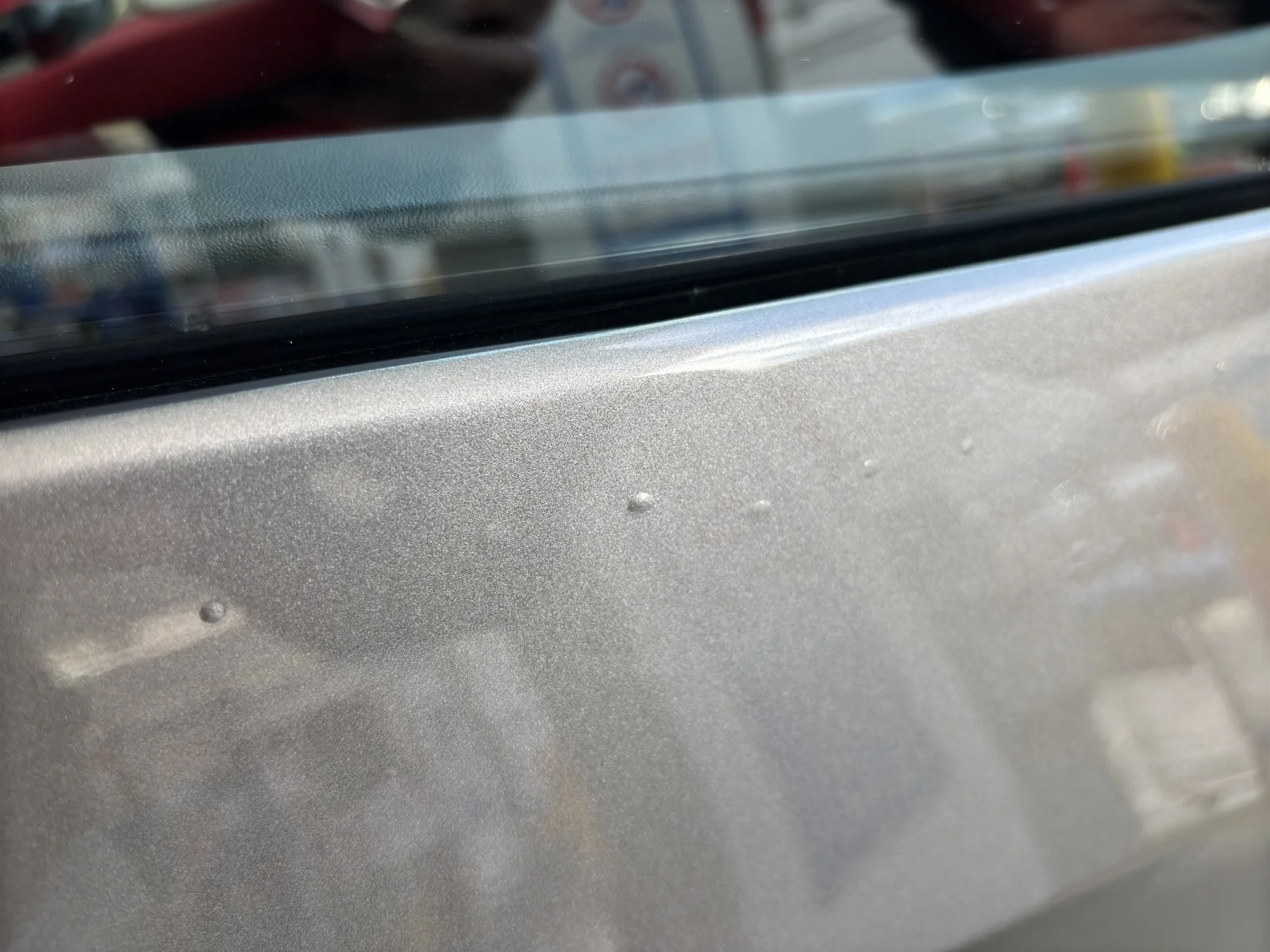

Unfortunately I am now an official member of the paint blistering club. Delivery July 2024, Nimbus. Have bubbles on both driver and passenger side doors.

Sorry to hear about this on such a recent delivery. Do you know when your car was manufactured? It was reported earlier in this thread that Lotus were supposed to have fixed this issue for cars built from mid 2023.
So they haven't sorted the problem out. My honest opinion, try to get your money back and get something else. Lotus just laid off another 200 people and are 'restructuring', never a good sign for a company.
Have no idea of the manufacture date. I don’t think the Japan cars have a sticker indicating like the other markets (or maybe I haven’t looked hard enough to find it). Could possibly be a 2023 make as I think the majority of cars were already shipped to Japan summer of 23 but PDI capacity was limited to 1 car/day, who knows, car could have been sitting outside for over a year waiting inspection.
Dealer has come back that they will repaint under warranty, however reading over the thread I guess the repaint won’t be a permanent fix and so need to go in and discuss next steps a little more in detail.
Door replacement is supposedly the only permanent fix, under warranty of course.

just had my doors replaced through warranty due to the dreaded blisters on each side.
Had an interesting chat with the service manager who said that there was no treatment internally on the earlier cars (Mine was Jan/Feb 23 build) but the new panels now all come treated/painted internally, I assume that Lotus now believe this to be a contributing factor.
My Car went in yesterday to get the blisters sorted. I originally took it in because of the trim alignment on the passenger door, and it was Lotus who spotted the blisters and informed me they'd fix them free of charge. To this day, I still haven't spotted them, so gotta say that I was pretty impressed by this, as they must be on the internal painted surfaces somewhere.
Two new doors shipped to the Lotus approved body shop here.
