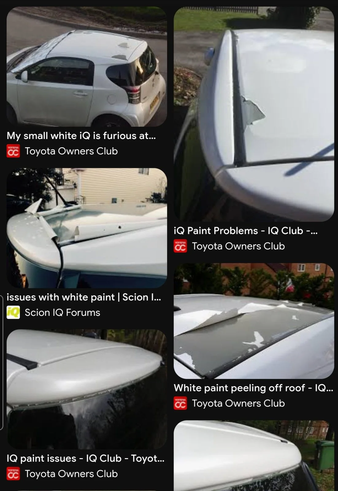

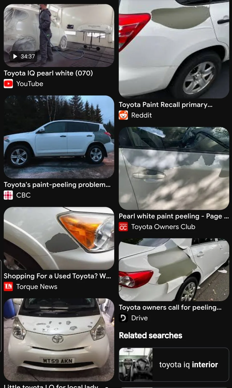

I raise you paint bubbling and give you Toyota white pearlescent from 2009. My daily, a Toyota IQ, started with the paint problem 10 years from purchase, of course they wouldn't touch it. A fault in the dipping process prior to priming appears to be the reason, an incorrect mixture used on 2009/20010 white pearlescent cars.
I had to sand to bare metal the bonnet and roof before starting from scratch.
That sucks, did you manage to get a professional spray job or are you attempting to do it yourself.
Did it myself. Its a 3 part paint so quite hard to get a really good match via DIY, I painted the roof and bonnet with a black similar to the Raptor paint you can get. I used a brush to apply and went over with a foam roller, it looks better than it might sound 😂.
I wouldn't want my Emira painted in it though. 🙄
