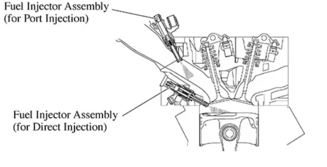

V interesting - does anyone know whether the Toyota V6 has Direct or Port fuel injection ?
Too old to be direct injected :) the 2GR-FSE added direct injection for twin injection.
thanks. I think that makes the Rev Hang issue for the Emira “worse” based on the earlier technical video.

Great video. I see it is worse on cars with port injection and from the diagram it appears the Emira V6 does have this. I suppose at least we are less likely to get the coke issue suffered by direct injection only cars.
