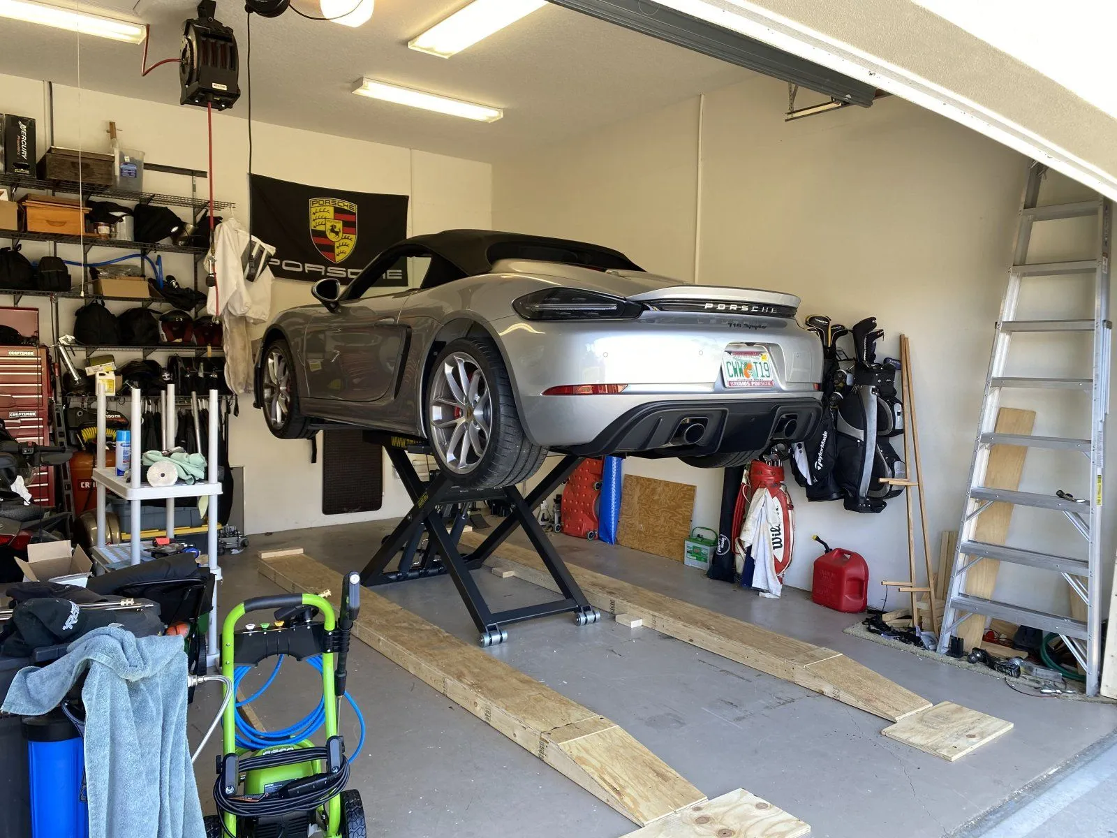

Avoiding one 24 month service on my Porsche’s paid for this setup.
That scares me... doesn't look like that lift is bolted to the floor and it's on rollers!?
It’s a standard portable scissor lift rated to 6600 lbs. The rollers are only on the rear section since the scissor action relies on the part moving back and forth. It’s very stable but requires a flat surface, which isn’t a problem for 99% of the garages in the US. This one is a Titan lift, one of the best in this style. It’s every bit as safe as a bolted down 2 post lift though it does block the tunnel area, which isn’t really a problem on a mid/rear engine layout.
If I decide to keep the Spyder I’ll probably install one of these and sell the scissor lift.

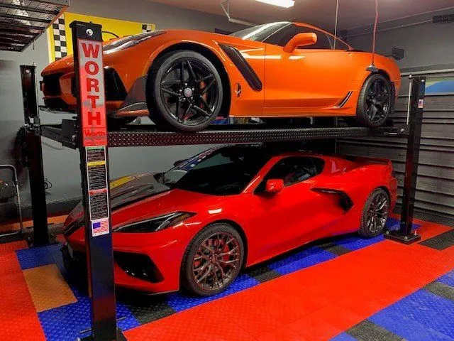

I need something more like this.. My 1 car detached garage is tiny. It'll fit the Emira, but I'd like to have both my Emira and daily driver parked in there if possible. How much do these run? $4-5k?
Figure $4k-$6k for a good one. Most are now made in China but if you stick with BendPac, Rotary or Backyard Buddy (made in USA) you’re good to go.

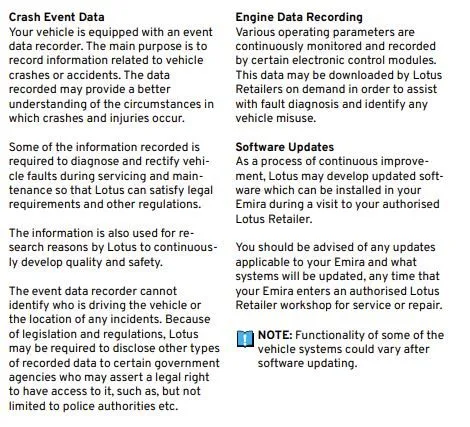

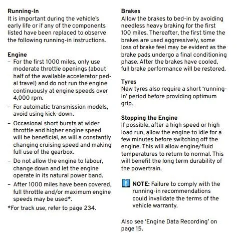

Running in is explained in the handbook. Here are the relevant pages:
Previously Lotus have recommended an oil change at around 1000 miles and a download of data from the car at the same time. The published Emira maintenance booklet doesn't include space for that stamp, so the requirement may have changed.

Seems a bit OTT for an unstressed non motorsport inspired motor... But it is what it is I guess!

Brilliant, that's open to a degree of interpretation 👍🏼
