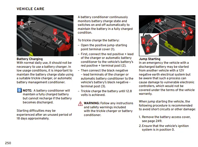

When I picked up my Emira, my dealer said that Lotus suggests using the provided trickle charger if the car will not be driven for "a couple of weeks."
The user manual says that "Starting difficulties may be experience after an unused period of 18 days"
It also makes it pretty clear that you should not let the battery become discharged.
I'm curious why you say that a trickle charger isn't an option.
