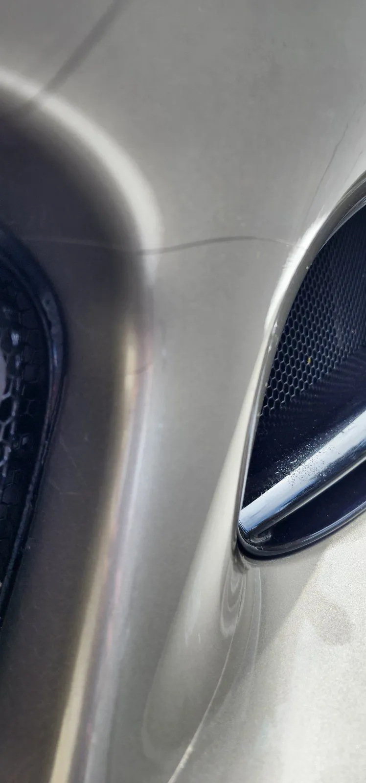

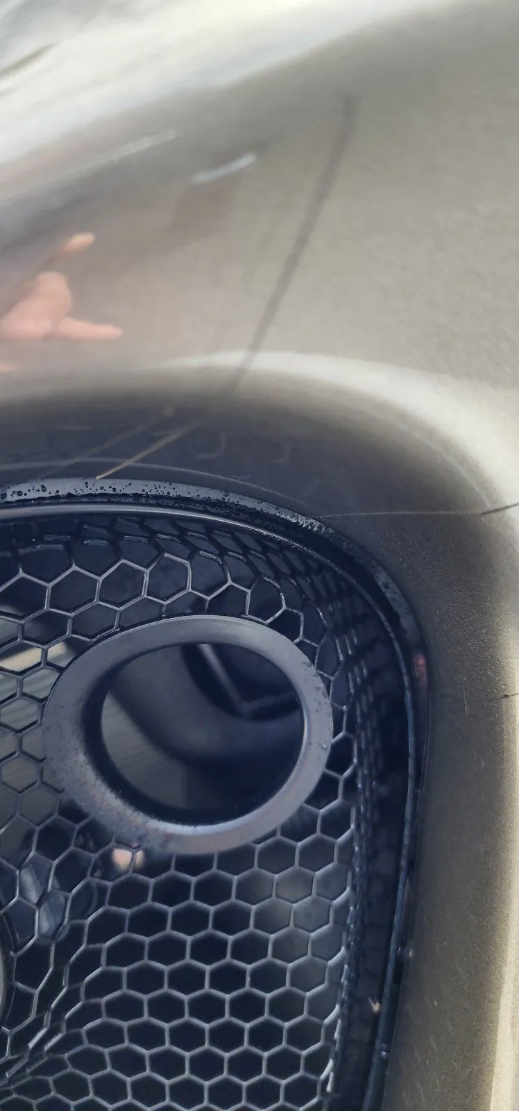

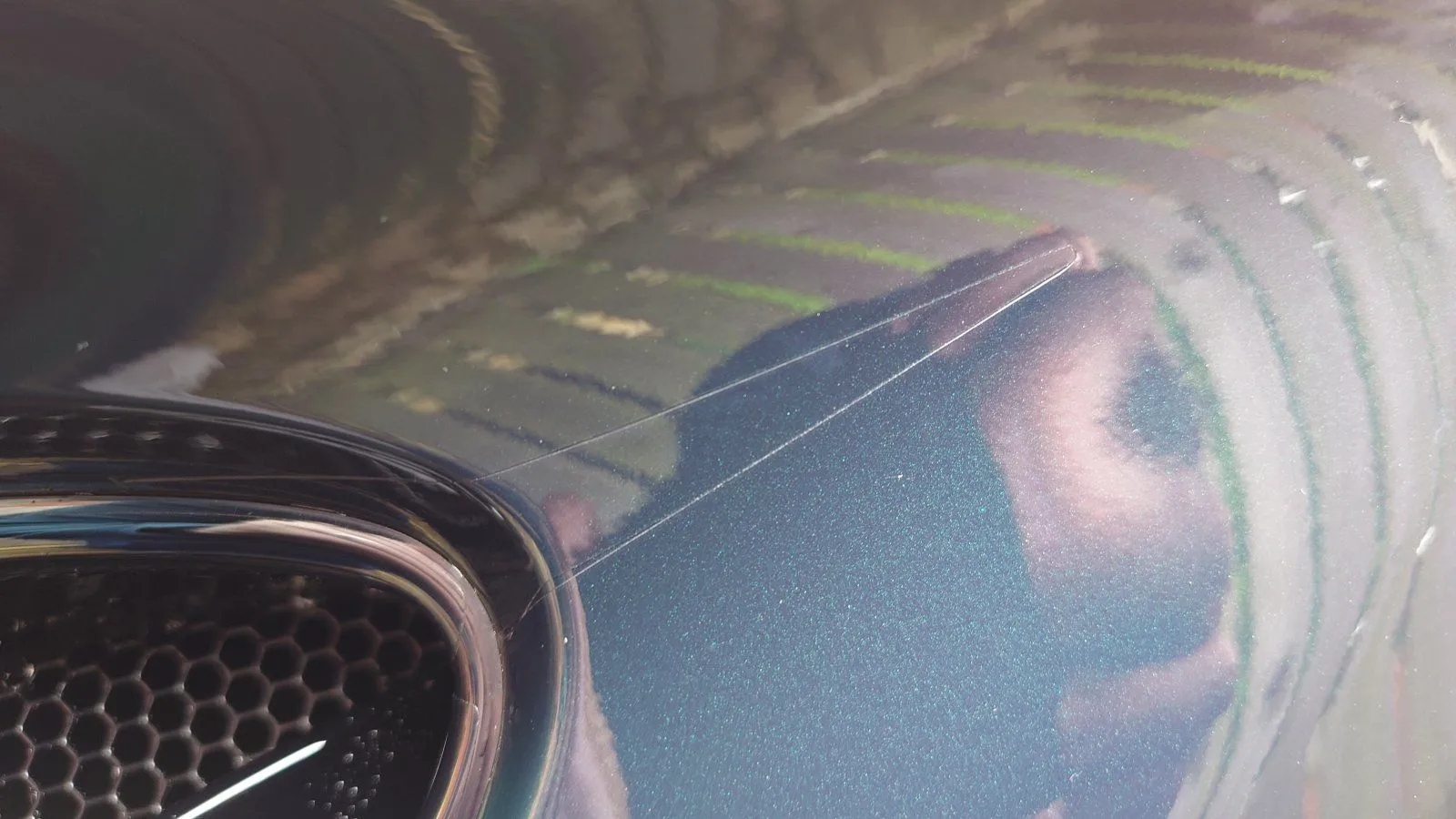

Has anyone else besides me had their car wrapped yet? I did full wrap of Xpel 10mil at One-of-One in San Diego ($7125) Love the look and happy with the work except for the relief-cut 'triangles' they left bare behind the side air vents. Has anyone else encountered thisView attachment 43819View attachment 43820? I heard it's in the template and one other forum member said he had the same. If you do full wrap please LMK how your installer handled this. It's not terribly visible unless you really look for it but Im worried about uneven discoloration/oxidation 8yrs from now in SoCal sun! BTW shine is out of this world and makes lines dance - especially over Nimbus
There are similar relief cuts around the vents in the PPF I had installed by Topaz in the UK (who use their own templates as far as I'm aware), however they infilled the gaps with additional PPF rather than just leaving the paintwork bare in that area.

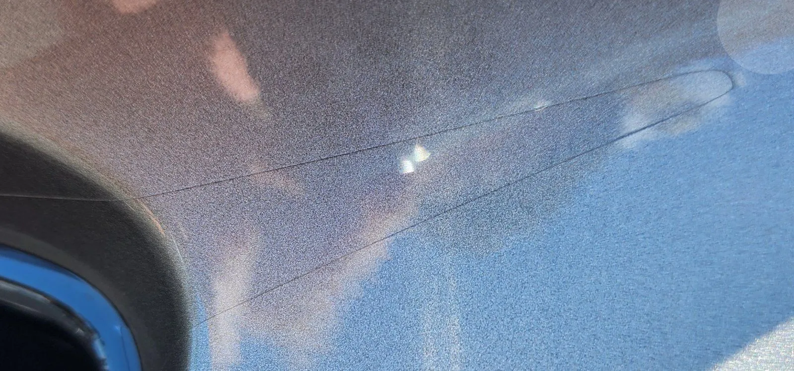

Having taken a close-up photo I can see that the infill isn't perfect (I definitely wouldn't have noticed otherwise), but in a way that helps show that it is indeed there!
Thanks @PsymonR and @Balboa Can you measure the length of that cut out? Hard to determine scale in the close ups we've seen. And are you saying that at "normal magnification", say when you're standing next to the car, you can't see this? Because the close up photos are really concerning me. Like wouldn't you expect that over time, maybe even a short period of time, that edge is going to collect dirt and that V will become very visible? That would be my concern, is how visible is this now, and how visible could it become later.

The relief cut is about 2½ inches long, you can definitely see it if you look for it but I don't find it obvious otherwise. How it will age with time I don't know, first time using PPF, but the lines of the car aren't simple so I can see why they have done it like that.

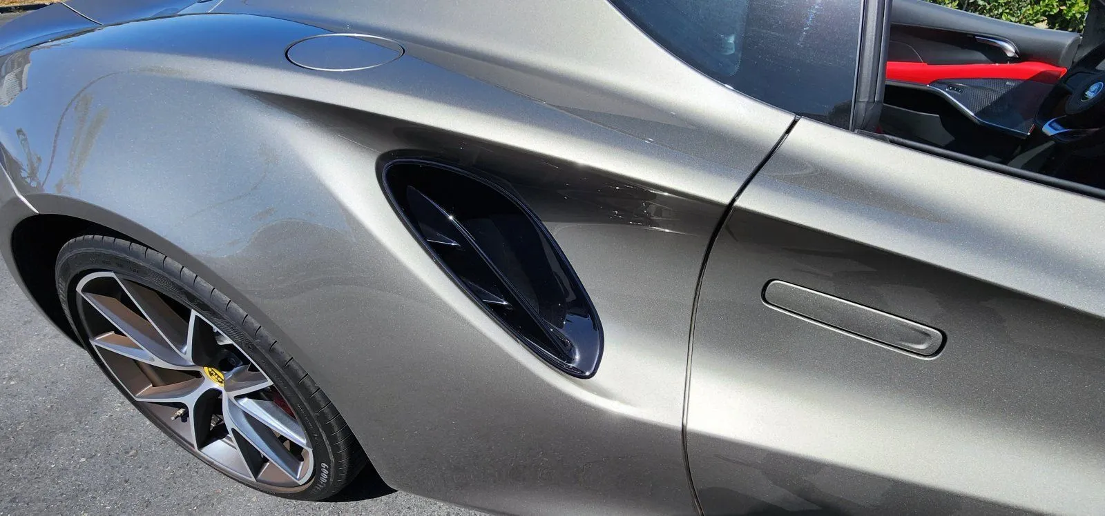

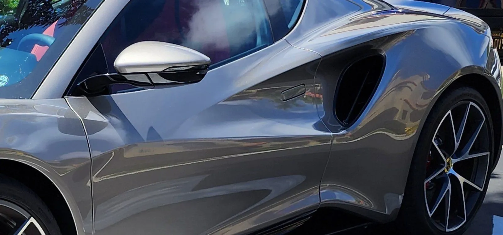

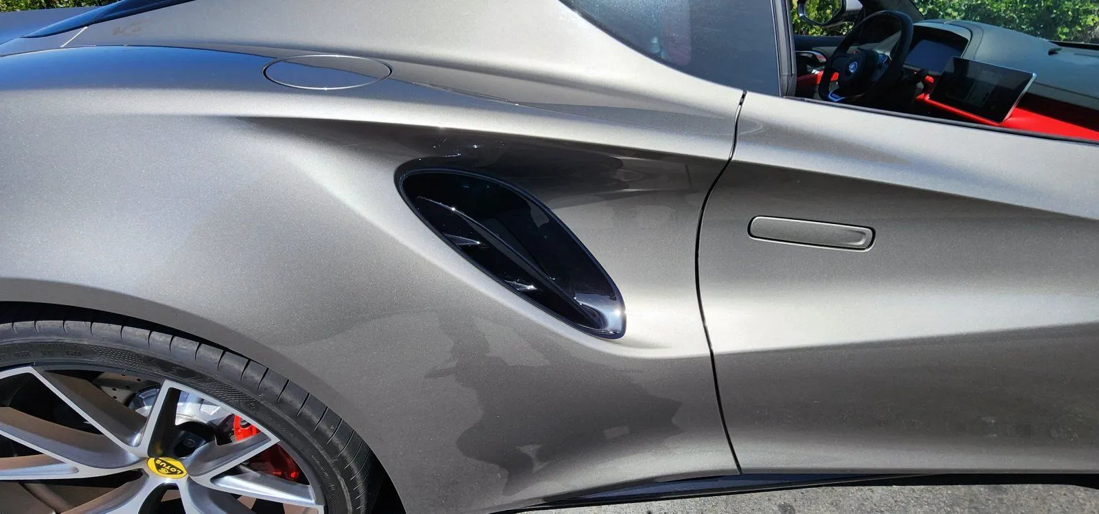

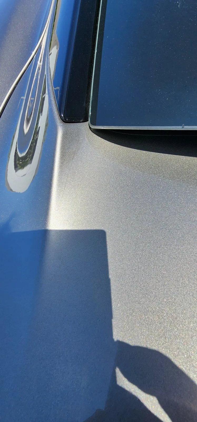

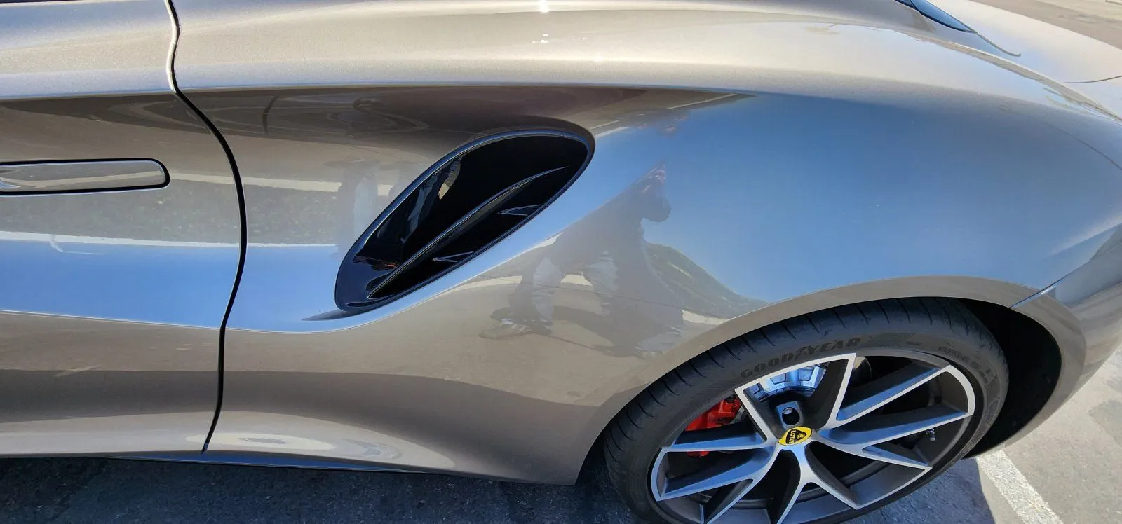

I want back to installer to discuss. It's definitely in the template (and Im not thrilled with it) They said if you try to do it in one piece (if it's even doable) it will probably end up lifting. Also they did my entire car in 10mil Xpel which has more impact resistance. They said maybe that panel could be done in 8mil but you give something up. I thought the 2 seams fore of the vent could have been better placed. At this point Im going to have the bare triangles ceramic'd and live with it. They're about 2-3 inches long. Also found 2 at the bottom of the back glass. These are very tough angles to work. If anyone is able to do without relief cuts I'd love to understand how. It really isn't noticeable with all these swoops and shadows unless you're really looking for it (and even then. only in direct sun at certain angles - where you can see on one side of the car but not the other- at least w Nimbus
). Not ideal. Mine was the 1st Emira they wrapped. Maybe some tricks learned down the road but I'm leaving well enuf alone. See pics - I included one where sun and angle allow you to see it
If it's any consolation it's almost impossible to see the side vent issue at any normal distance

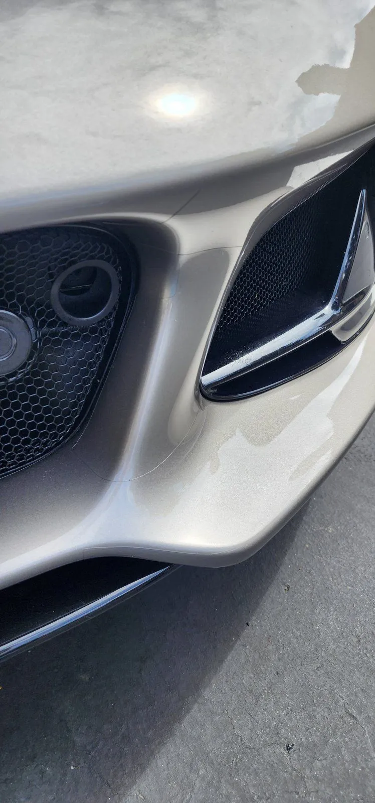

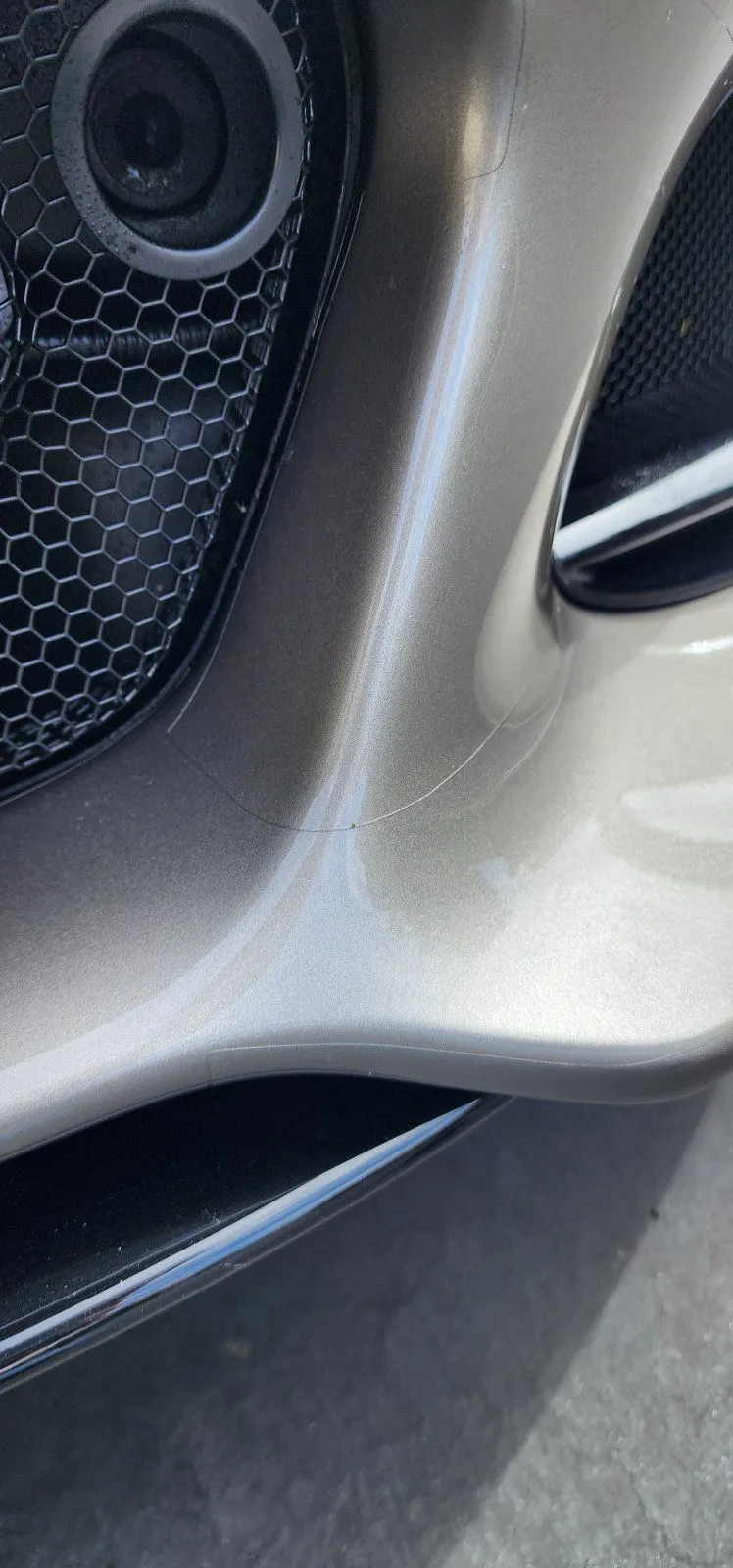

Can you guys post how the front bumper is completed with PPF? Are there similar relief lines? I would imagine so given the curves
