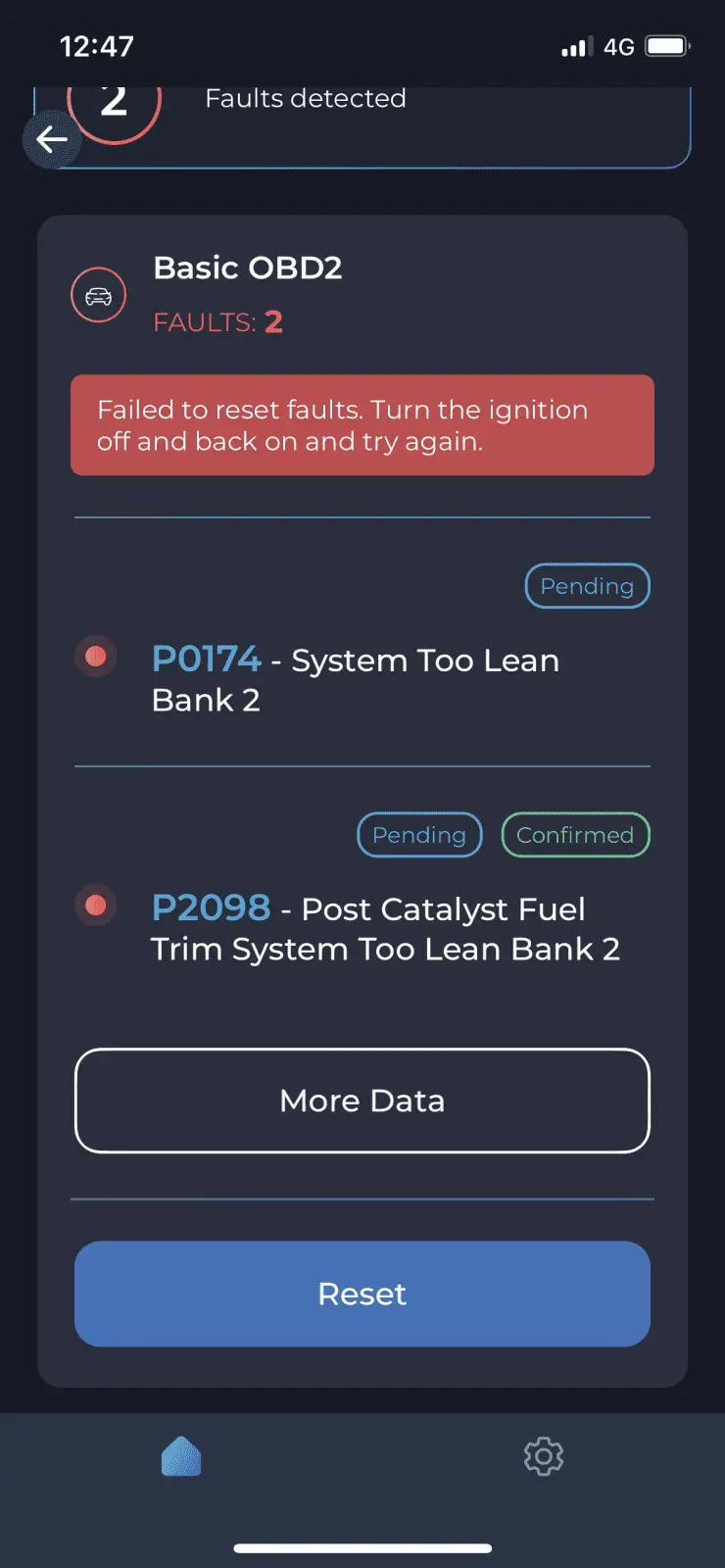

today my Emira went into limp mode and stopped in Switzerland on the first day of our driving holiday on the way to the Alps. Lotus Lucern, Switzerland were brilliant in dropping everything to help us. It’s not running yet and they are still working on, so any ideas welcome.
Although sensor show too lean it is actually over fuelling one bank of three cylinders. The top lean signal appears to be sending more fuel and destroying sensors. (Two sensors so far). Also exhaust are covered with black soot and smell of petrol from engine.
what is causing it and why only one bank?
Either faulty wiring / ecu or ecu programming is all I can think of at this point. Hope your car isn't too far from home since you were on your first day of your trip. If it's anything like the others I suspect you won't be getting your car running well for a while.
