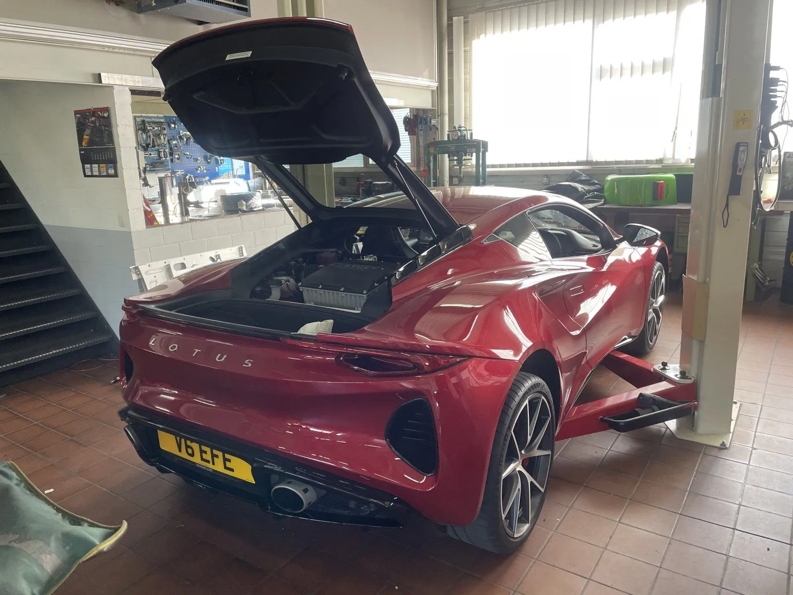

These guys are so amazing and are everything you could hope for as ambassadors for Lotus and Caterham.
