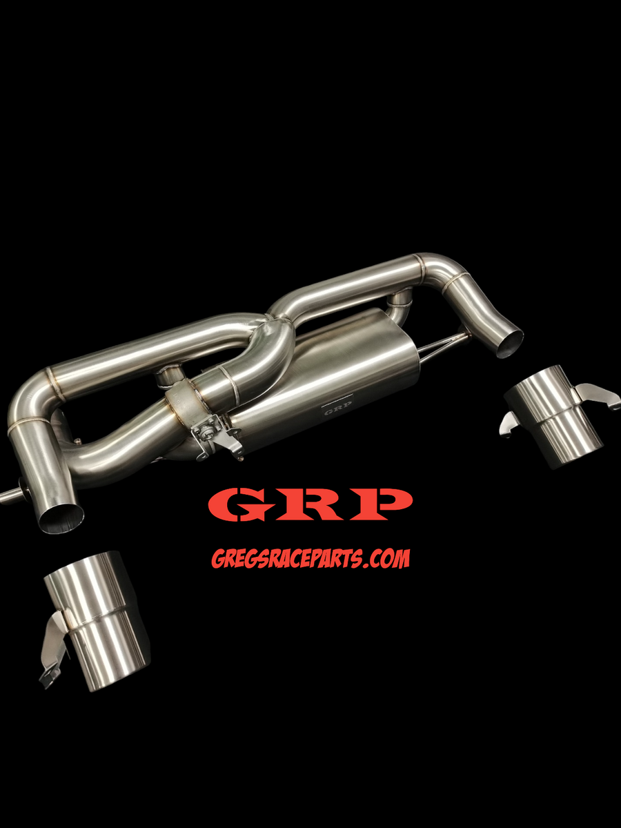

appreciate everyone's feedback and thoughts on exhaust, cat delete, and valve.
Quick question, everyone seems to have installed the milltek exhaust and GRP cat delete.
Has anyone tried the GRP exhaust? Did a quick search, don't see any feedback / installs on forum. Thanks everyone!
Any thoughts / comparisons?

Can't speak to the GRP exhaust specifically, but I do know from personal experience that the stock back box is pretty much a straight pipe when the valve is fully open. Running a 3rd cat delete and forcing the valve open will give you all the sound you need. The only benefit IMO of an aftermarket muffler is potential weight savings.
Do an exhaust controller first, if you still want more sound, do 3rd cat delete.
Personally I've gone back to compeltely stock catted exhaust with the controller and have no desire to mess with it again.
