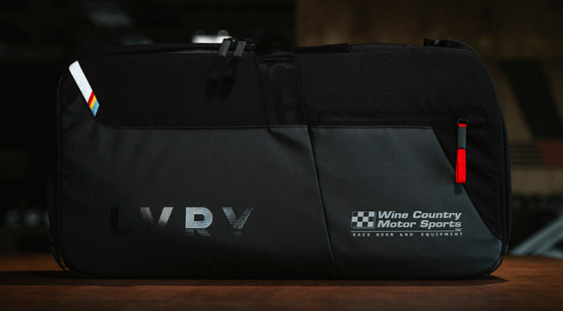

For those of you who have tracked your car, what do you use to carry your gear?
I'm looking for a bag that carries a helmet, hans, shoes, gloves, and suit. And that will fit in the trunk.
Can confirm this fits perfectly on the right side of the trunk and will fit everything you listed.
If a bit too much, use a single helmet bag for helmet&hans and shove that fully in the right side, then have a small duffel for suit, shoes, gloves.

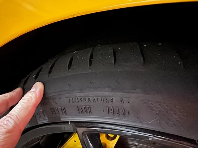

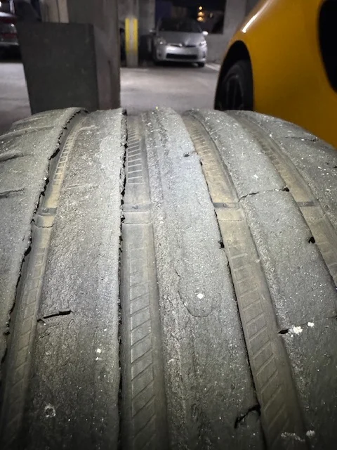

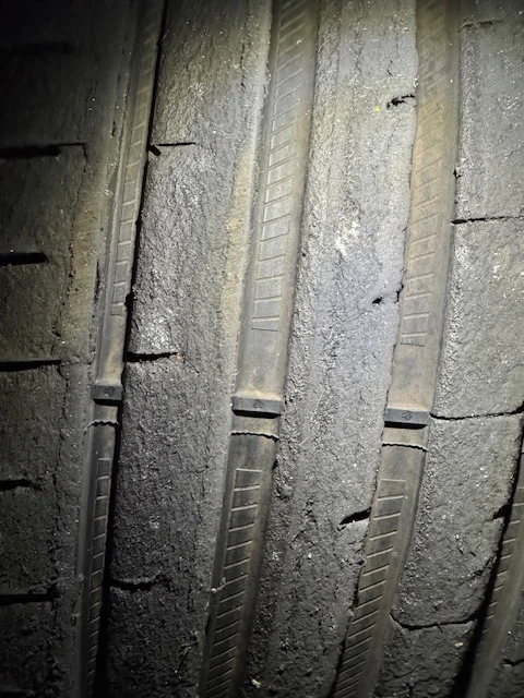

I started going to the track last month. Miami homestead. I'd like to go more. Maybe join a club. I'm trying to get a handle on tire cost/wear.
I have the Goodyear F1s. With track suspension.
I have done 11 sessions over 3 days. The front brakes are gone. The tires look pretty worn on the side. One instructor said I probably have 3/4 of a day left as the groove gets worse.
I can swap from left to right with a remount. Then get about the same on that side, I'd guess.
So 5 days for one set. That is tough. Some guy driving a C8 said he got 8 days, 4 sets a day. That would be a lot better on the $$.
I could probably squeal less in the hairpins.
One good driver said grippier tires get you a better time, but mask poor driving.
I thought the F1s would be out, but maybe they are not a bad deal.
Any thoughts?

I’m assuming you are talking about the road course and not the oval…
The life of consumables like tires, brakes, rotors, etc. vary greatly by track, driving style, road surface, vehicle weight, and tire tread wear rating. I track more than just my Emira, but for the Emira I did 4 track days last season - 2 private days (unlimited drive time) and 2 organized track events - and only went through a few sets of brake pads and an oil change. Still a decent amount of life on the Goodyears (with the Sport chassis), but I’m going to swap them out for either Yokohama Advan or Michelin Cup 2 tires.
