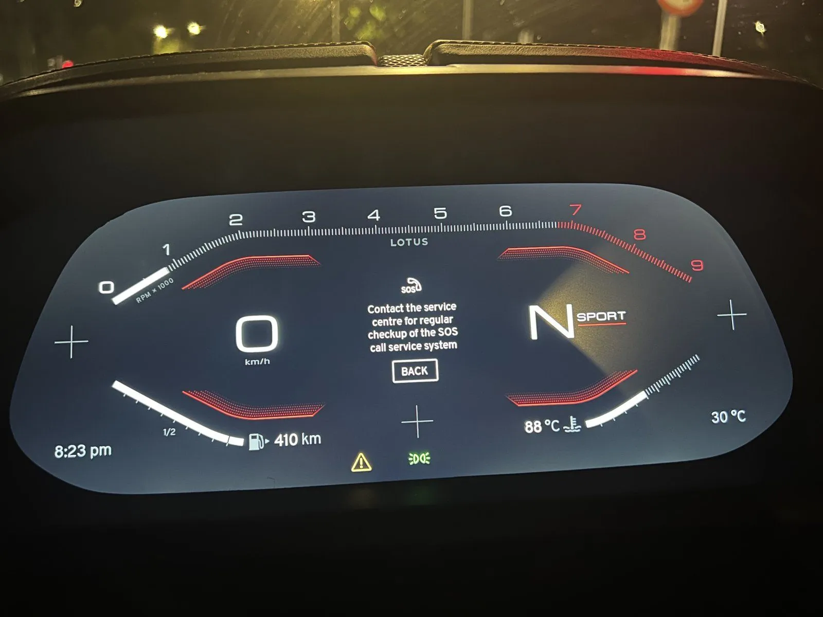

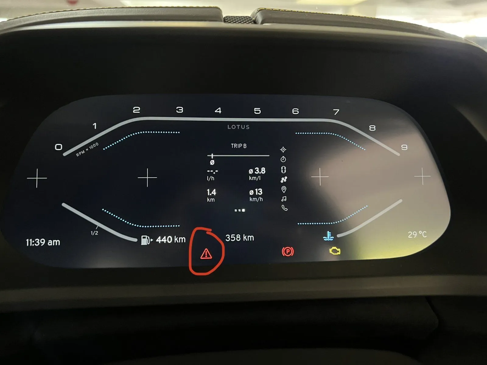

So went to start my Emira up this morning and upon starting up the car, a brake failure warning popped up. ABS light came on. Freaking out, I switched the car off to see if it would go away upon restart. Car then could not restart and a warning message said something along the lines of “e-brake failure/needs to be serviced”. Car then was essentially “bricked”, despite shutting it off and locking the doors, the dashboard remained on and message stayed. Waited for 5 minutes and it didn’t go away.
Lastly, I did the oldest trick in the book: disconnected the battery for 5 minutes and reconnected. Warning went away and was able to start the car again.
Not sure if these are common gremlins but I think another owner here has had similar issues with being unable to start their Emira.
PS. Was freaking out so didn’t manage to get the photo of the warning as i couldn’t recall it after a while, but this red triangle logo did remain and I took a pic.
Just for future reference if anyone encounters anything similar, they can try this old trick.

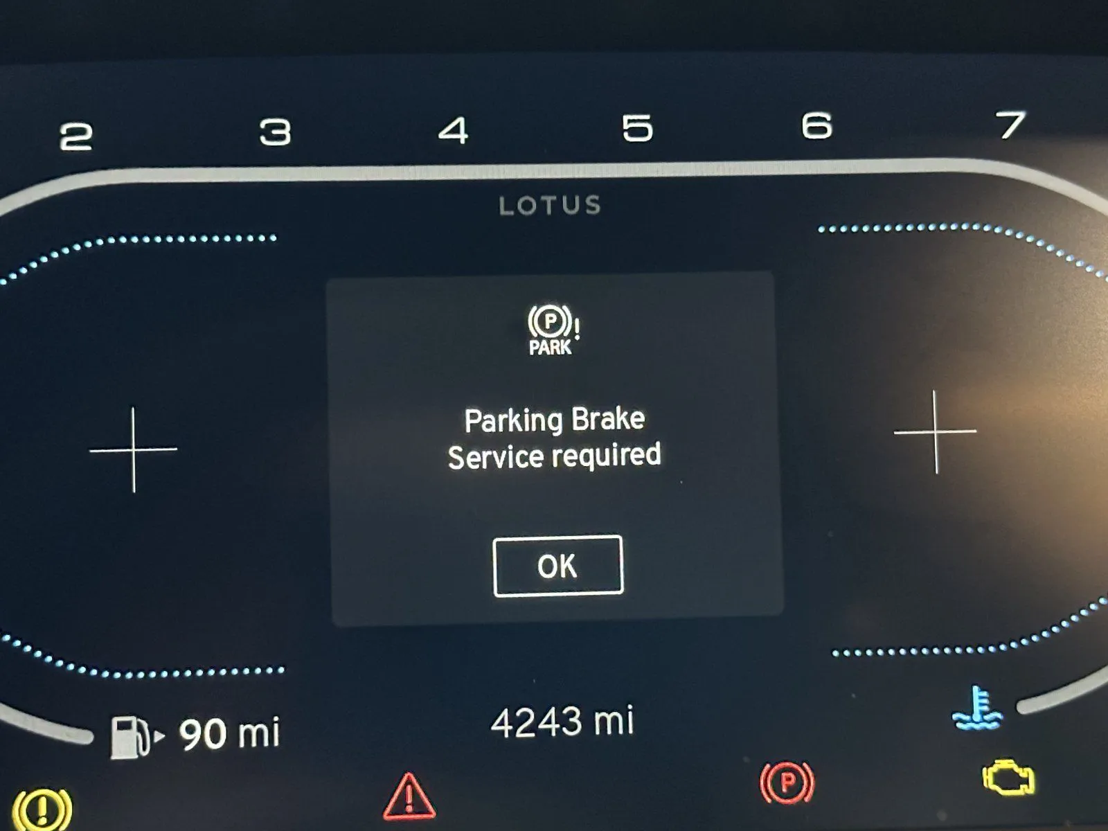

I think a few of us have seen that. In my case locking it up and coming back 20 mins later it was all ok. Not sure if there is a definitive time. I have to say that that happened in my first few weeks of ownership. Since I started using the car for longer trips and keeping it on a CTEK charger when in the garage I haven’t seen any software issues like this..
This is probably the message you saw (localized). Had the same issue, including not being able to start. Locking and leaving the key range for a few minutes (Which gets the ECU to fully shutdown) solved it.

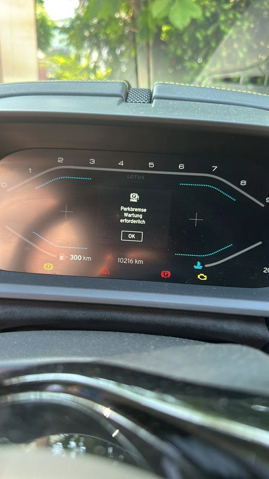

This week I had the same issue, which expanded quickly on to other issues.
I was driving on the german Nordschleife, when the "parking brake fault" warning showed up. Just short after that, the next warning said, ABS sensor failed, the next said, ESP sensor failed. Right after that, no more revs showing up, no gear is displayd and on top of that, the displayed speed qas totally wrong.
After finishing the lap, I stopped the engine and wasn't able to start it again.
The whole car was bricked. Both displays dead, nothing worked. Even locking the car wasn't possible.
I had to wait for a towing truck. When it arrived, the displays were working again and I was able to lock the car.
When we arrived at the workshop at Komotec, they said, that the control units had shut down and were getting up again one after the other.
They also said, that there were 2 softwareupdates to be installed on my car.
The next day, the car worked fine on the Nordschleife.
