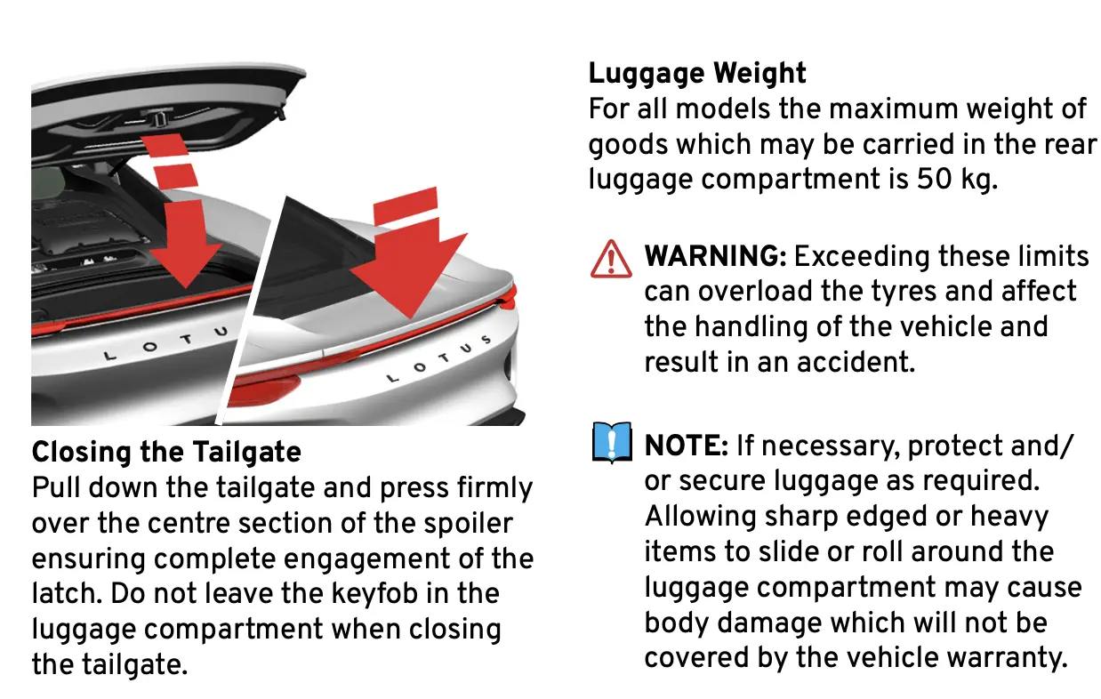

Lotus says in the manual to not put more than 50 kg (110 lbs) of weight in the trunk? Is that limit just for driving purposes?
Yeah there's a weight limit sticker in the trunk too but I've never had an issue on the 400 just getting in and working over the engine. I did the same for the intake on the Emira and no wierd noises. I would suggest smooth movements but so far so good lol
Edit: and that page in the manual suggests it's for handling purposes not load bearing of the trunk itself. Neat! never knew that.

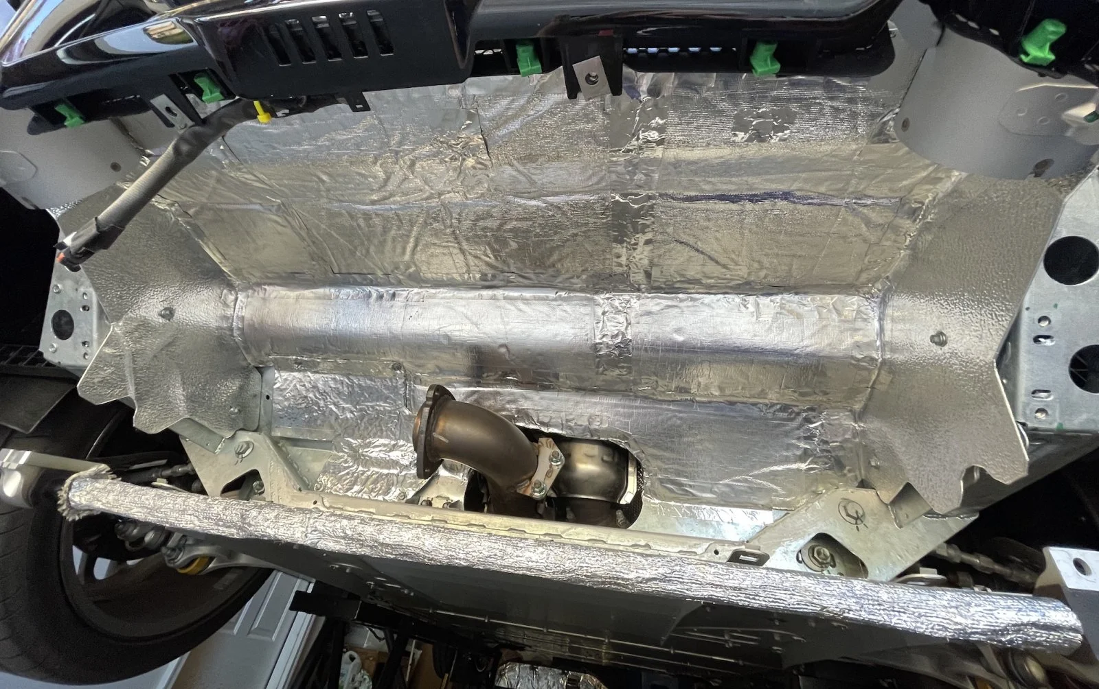

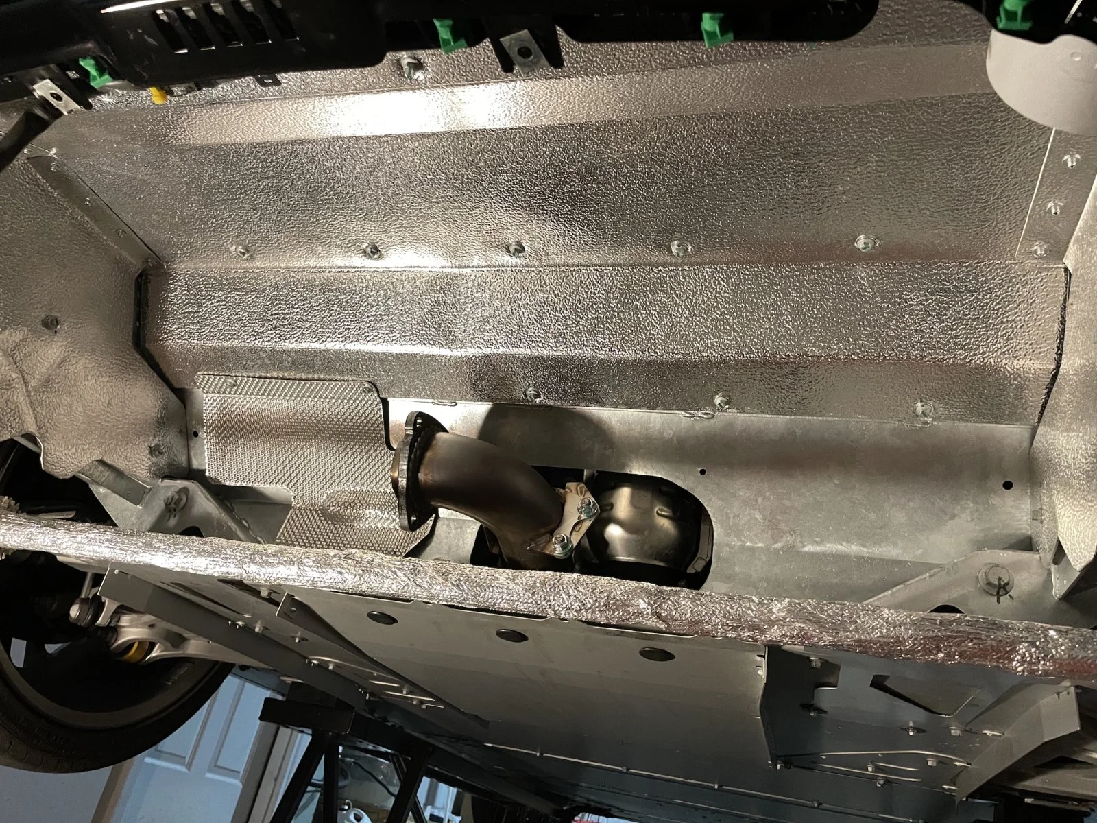

Finally got all the stuff I needed to install the Mega Mat in the muffler area.
Here's the before:
And here's the after:
I didn't take a picture with the 3rd cat and muffler installed because I had taken so much time carefully taping up all the seams, that it was getting late and I just wanted to get the car back together and go for a drive. The slight amount of resonance at 2,000-2,300 rpm is gone now. If I'm at that rpm and accelerate, it gets a bit louder for a second but once you get out of that range there's no boominess.
Here's the before:

Good stuff. Do you think it's possible to place the Mega Mat w/o removing the muffler, or is it a must?
No. The glue on the back of the Mega Mat is really sticky, and if you accidentally get it stuck in the wrong spot, you'll probably tear the foam off the metal backing trying to lift it back off. It's very lightweight and fairly easy to work with, but you still need to contour it to fit. You're going to want easy access for that. Do it in small sections, rather than large ones. You also need to tape up the seams afterward with heat-reflect tape which is also metal backed. That took quite awhile too, and it's also easier to do it in smaller strips rather than long ones.
Cool. I'll have to remove it then. Thanks for the tips.
