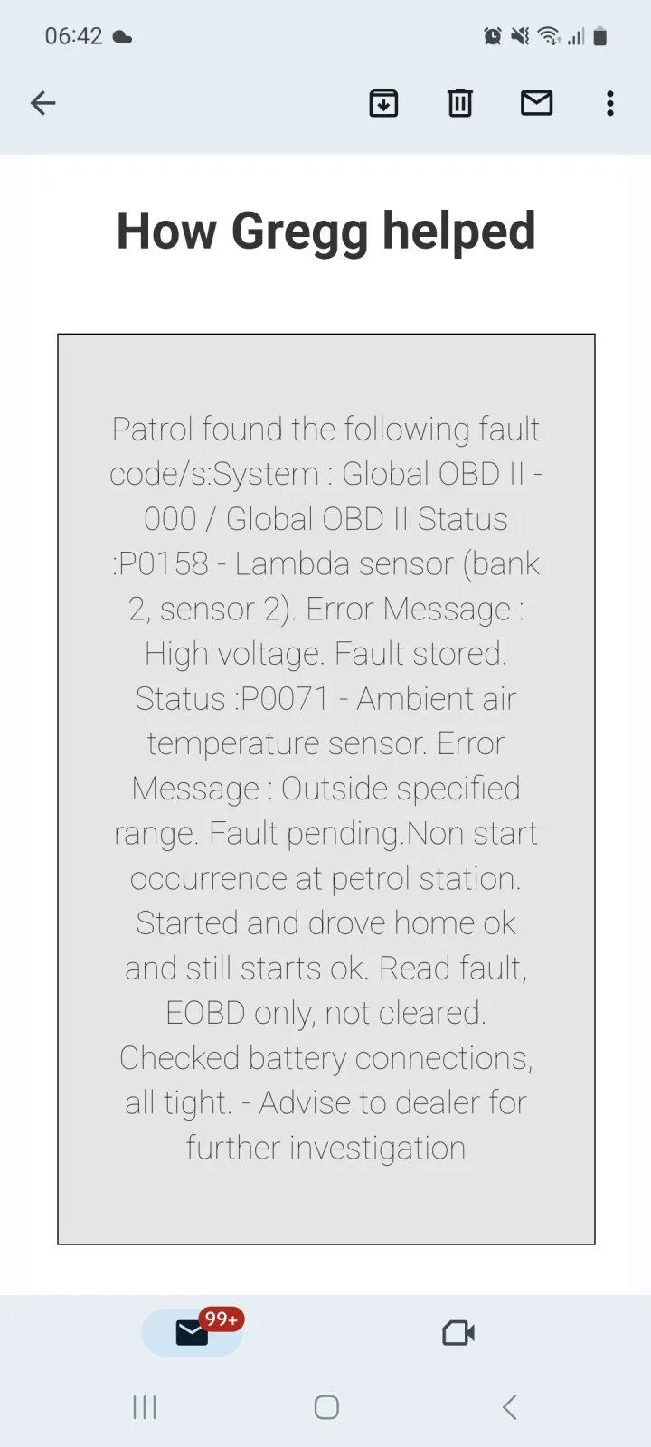

Few non related issues also identifed when plugged in:

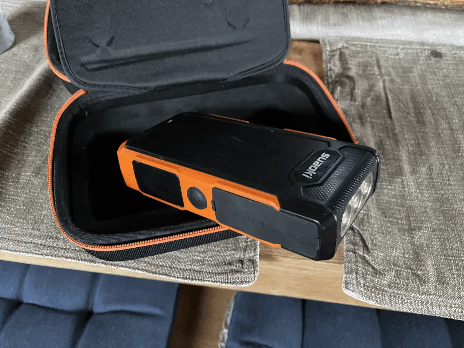

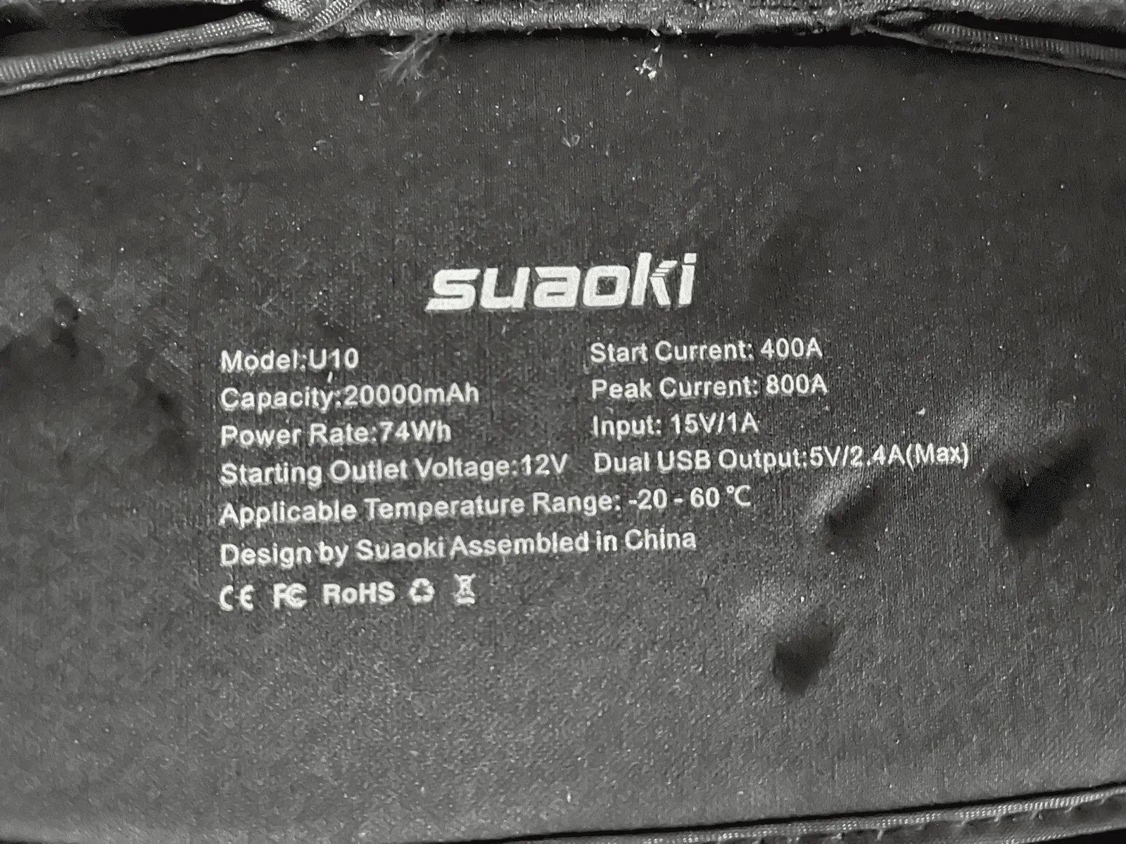

No...it doesnt condition or trickle...I have the Cteks for that. it is purely a booster to use to start up the car when your battery is flat...usually also comes with a very bright led torch...my model is below but this is quite old and Im sure there are better ones on the market now
