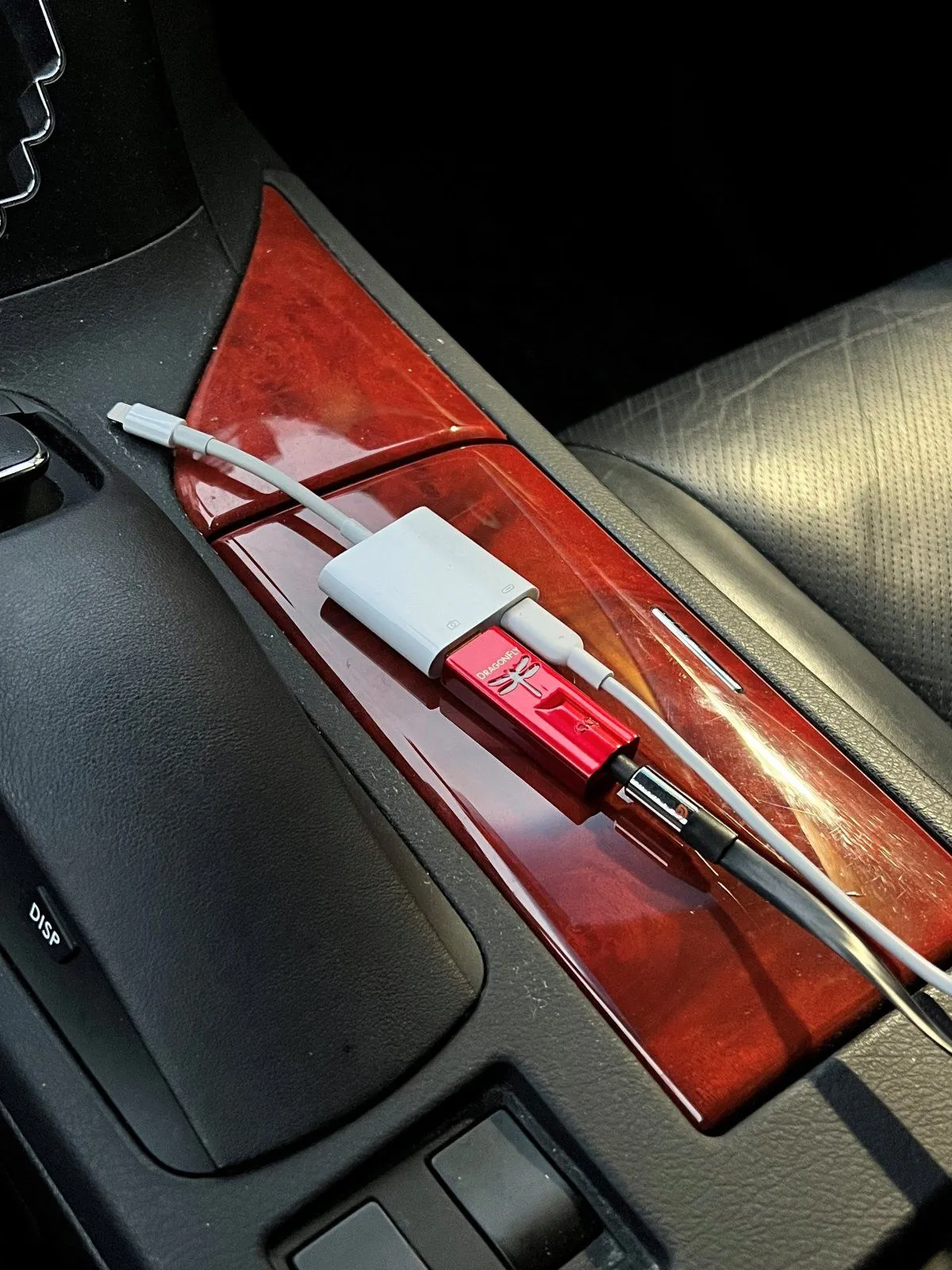

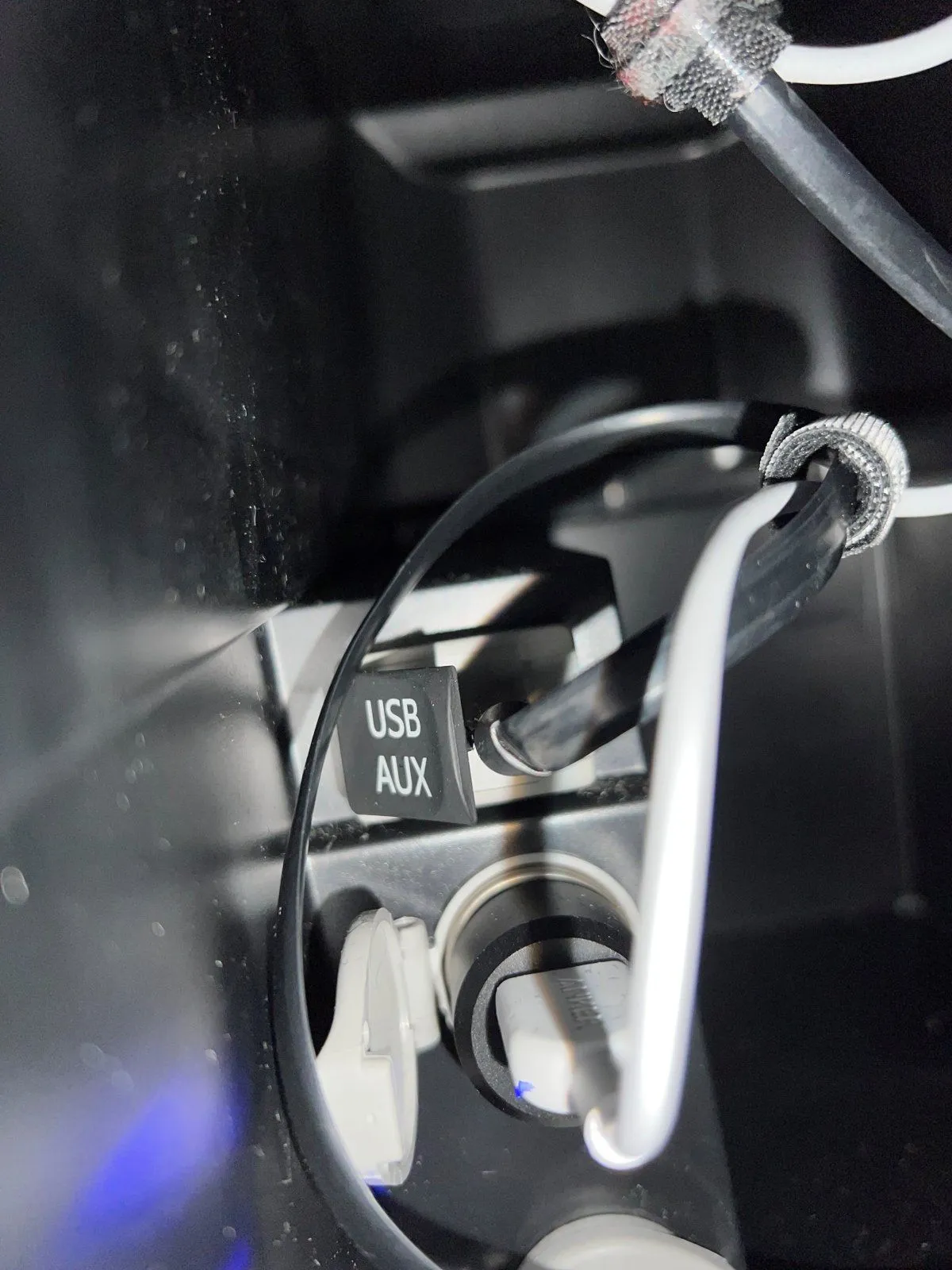

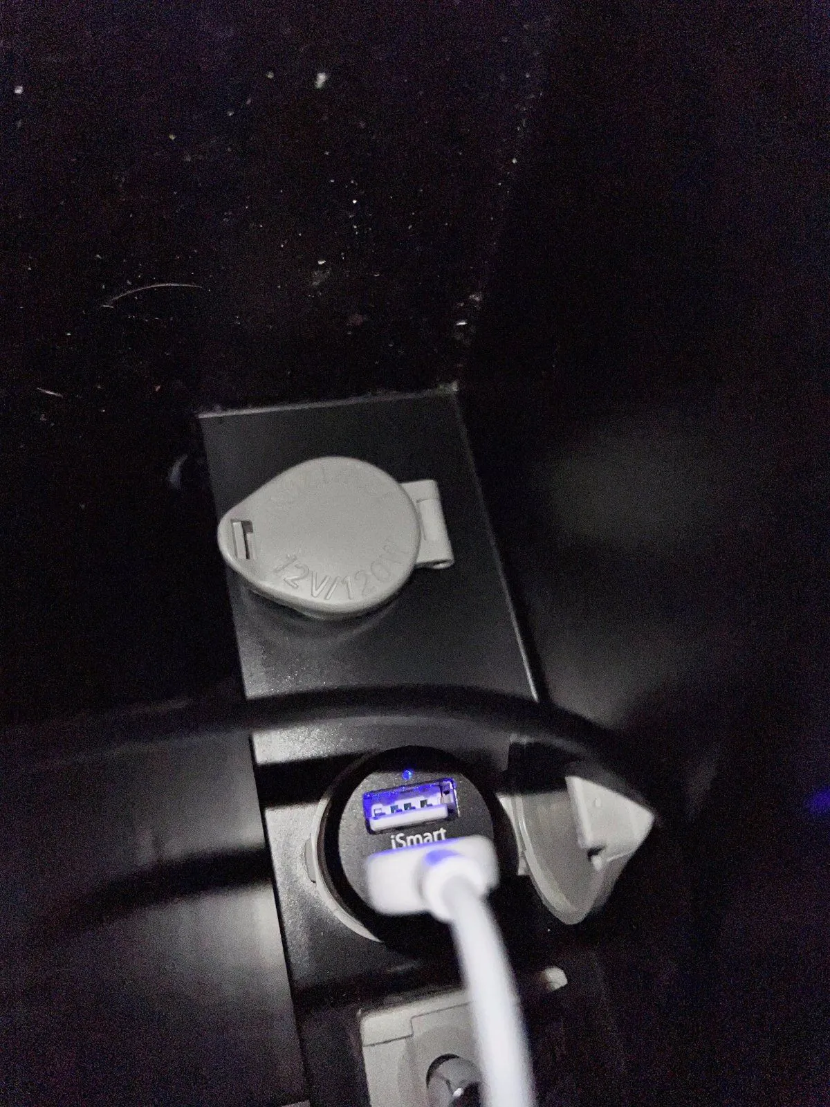

@Skinwarrior Here are the pics of my DAC setup as promised. My iPhone is plugged into the Apple connector at one end, and the other end is the Dragonfly Red DAC. 3.5mm audio cable is connected to the Dragonfly, and the other end is plugged into the AUX input of my Lexus which is located under the arm rest. I also have USB to lighting wire to recharge my iPhone at the same time. So to answer the question, can you hide the DAC? Yes, I can hide it inside my arm rest but that means I also hide my iPhone as well. The only problem is that you won't be able to manually scroll through your phone to choose what songs to play (not that I encourage or endorse the use of one's phone while driving). Hiding your phone/DAC works if you only want to listen to your playlist and don't have a need to fiddle with it.
Is the DAC worth getting? As Porter mentioned, it works great and it does transform the audio system. It makes a mediocre stock system sound much better. For the regular person who is not an audiophile, it should be more than sufficient. But if you are a true hardcore audiophile, you won't be completely satisfied. There's only so much a portable DAC can do. The other parts of the factory audio system is the weakest link. For the true audiophile enthusiast, a tear down and rebuild is the only way to get hi end audio.

So the theory here is that a portable DAC does a better job of decoding the bitstream into analog waves than the head unit? And I guess you’re not wortied about picking up crosstalk in the analog 3.5mm stereo line or in the wiring from the jack back to the head unit?
Just to point out that there’s no 3.5mm aux input in the Emira, only USBs.
So you’ll need a DAC with USB output.
I can’t 100% guarantee that a portable DAC does a better job of decoding bitstream into analog than stock head unit. But from my experience (and Porter’s), the portable DAC does indeed do a better job. The best way to confirm this is to test one yourself.
As for crosstalk or feedback noise, did not notice for the most part. There was maybe one or two songs that had some crackling when played, but I think it’s due to either the limitation of the stock speaker or possibly the DAC itself. This occurs only for specific songs with high frequency. 99.9% of the songs played have no issues.

Thanks for the photos and the explanation.
I wonder if this type of DAC setup would preclude the use of the wireless Carplay in this vehicle?
I believe you are correct in your assessment. CarPlay is wireless connection between your phone and the head unit. But you could bypass CarPlay by using a DAC with USB output, as KJD mentioned. You’ll get better sound but you sacrifice functionality. Not sure if this is acceptable even for me lol.
If the output is USB, then where is the D/A actually happening?
I’m no techno/audio geek, and I’m not gonna say I’m right on this…a DAC stands for digital to analog converter. So it’s reasonable to assume that the mobile DAC will convert digital audio (from phone) into analog sound. From there it goes via audio cable to the Aux port. But Instead of using audio cable, we use USB instead and we plug into USB port. Knowledgeable stereo peeps feel free to chime in to clarify if I get anything wrong.
That's not possible though. DAC = Digital to Analog Converter. If the music is converted into analog, the analog signal can't be carried over USB since USB is a digital connection. If there is no AUX input in the Emira, then it cannot benefit from a simple DAC like this.
The only possibility is to add a DAC after the head unit by interfacing with its A2B bus. I though that might have been what's been referenced when talking about adding a DAC.
