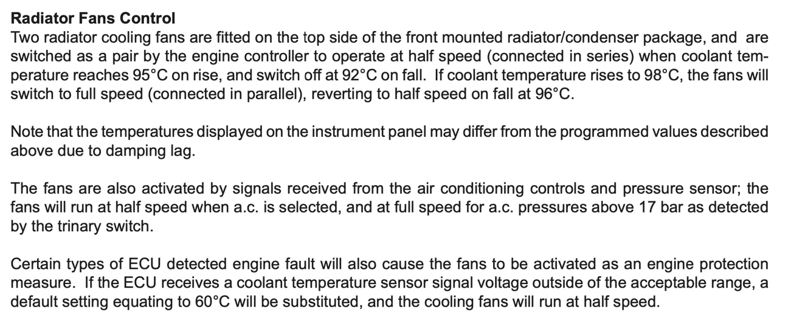

In the meantime, another issue. I've updated the issues thread, but putting here for completeness.
When idling for any extended period of time, the car starts to overheat quickly, like 116+ degrees, throwing up red warnings and a mini-limp mode of sorts. Driving quickly cools it back down. Coolant levels look correct, so it's thermostat, a sensor, or air in the system most likely.
Unfortunately Lotus can't look at it for 3-4 weeks, they are rammed busy, not their fault but not ideal for me as I want to be using the car as we enter spring and nicer weather. So a local Porsche specialist will be taking a look later this week for me to determine what's what. I'll report back.
That's scary -- first thing I'd check here is radiator fans -- making sure they come on while idling, would be pretty easy to check yourself too.
No documentation exists for the Emira yet but this is for the Evora:
And some additional logic after the car has been switched off:
I can't imagine the Emira is considerably different than the Evora when it comes to cooling logic.

Independent garage checked over the entire cooling system today. The fans work (when powered independently) but something is up with the control unit for them, it works sometimes, fans come on when idle etc, at other times they don't come on at all and the car overheats. Not ideal. I realise the car is under warranty and this work cost me, but I wanted to know what was wrong, get a written report and in my next booked Lotus visit in a few weeks will have it addressed under warranty - I'll be messaging them first thing tomorrow with the report and list of required parts.
Annoying but realistically I don't sit idle for 5+ minutes for it to be much of a problem often. Still needs resolved of course.
