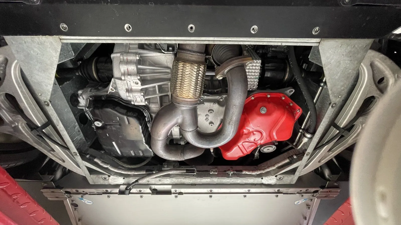

Getting Access

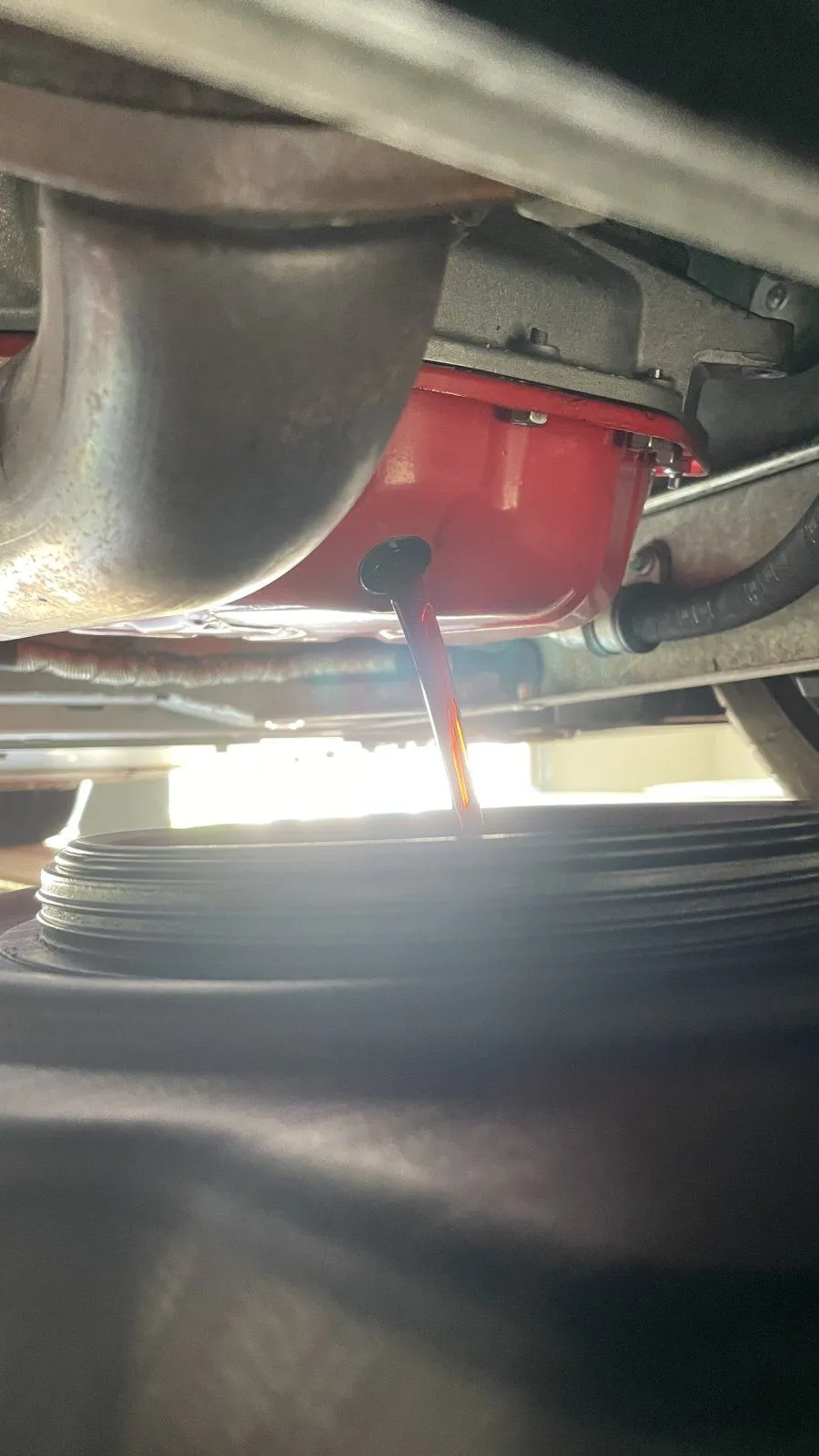

  • Use 10mm socket to open the bolts and then remove the undercarriage tray. Here is a before and after.

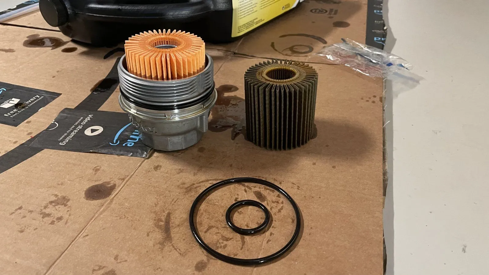

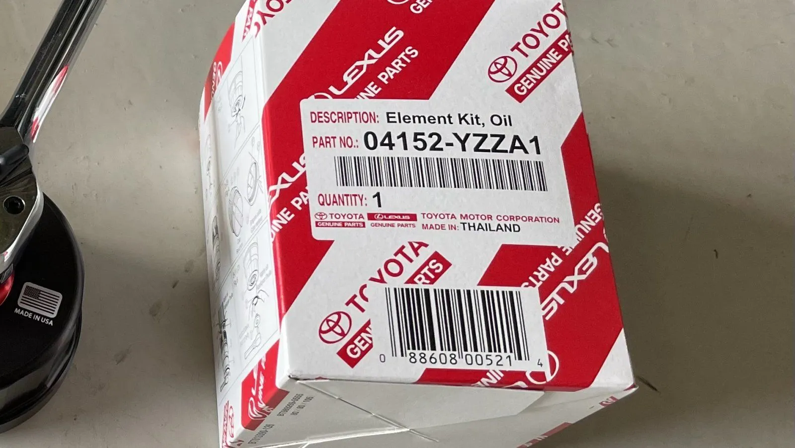

  • Oil filter (my local Toyota dealership sells it for about $6). It comes with 2 different size O-rings that you will use. See picture for part number.

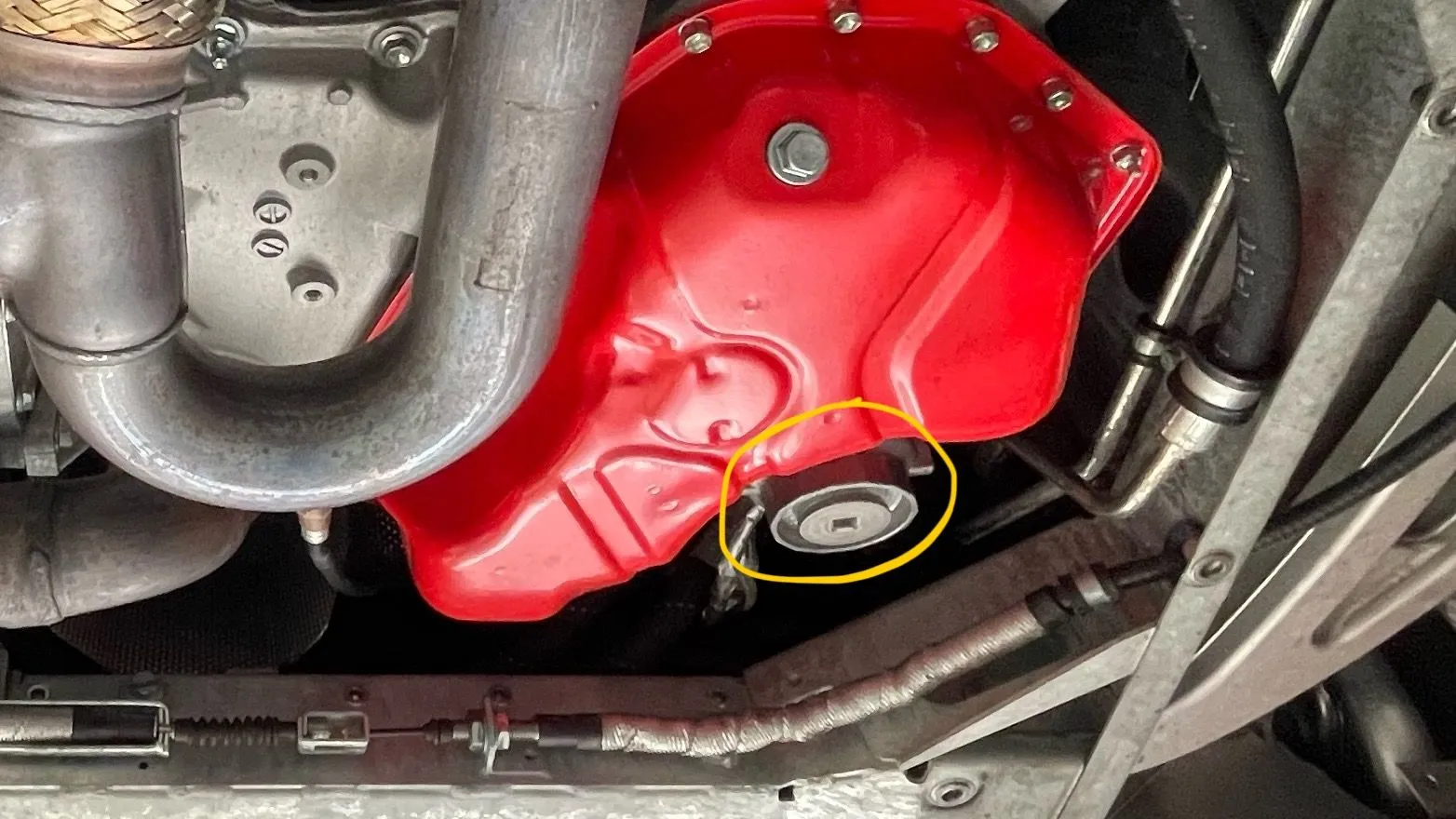

  • Oil pan drain plug washer. Ask your local Toyota dealership for one. Mine threw it in at no cost. I believe the part # is 90430-12031.

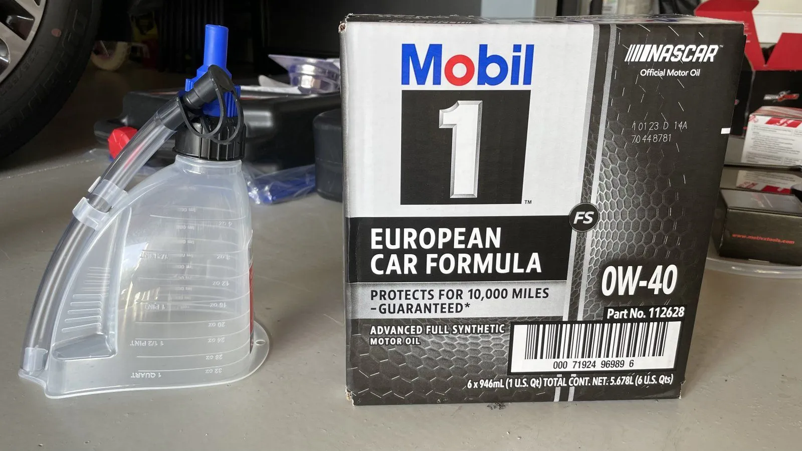

  • Motor Oil. 0W-40 is what is recommended for Evora GT. After a 30-min drain, mine took 6 US quarts as confirmed through the dip stick.
  • 14mm socket will open the oil pan drain plug.

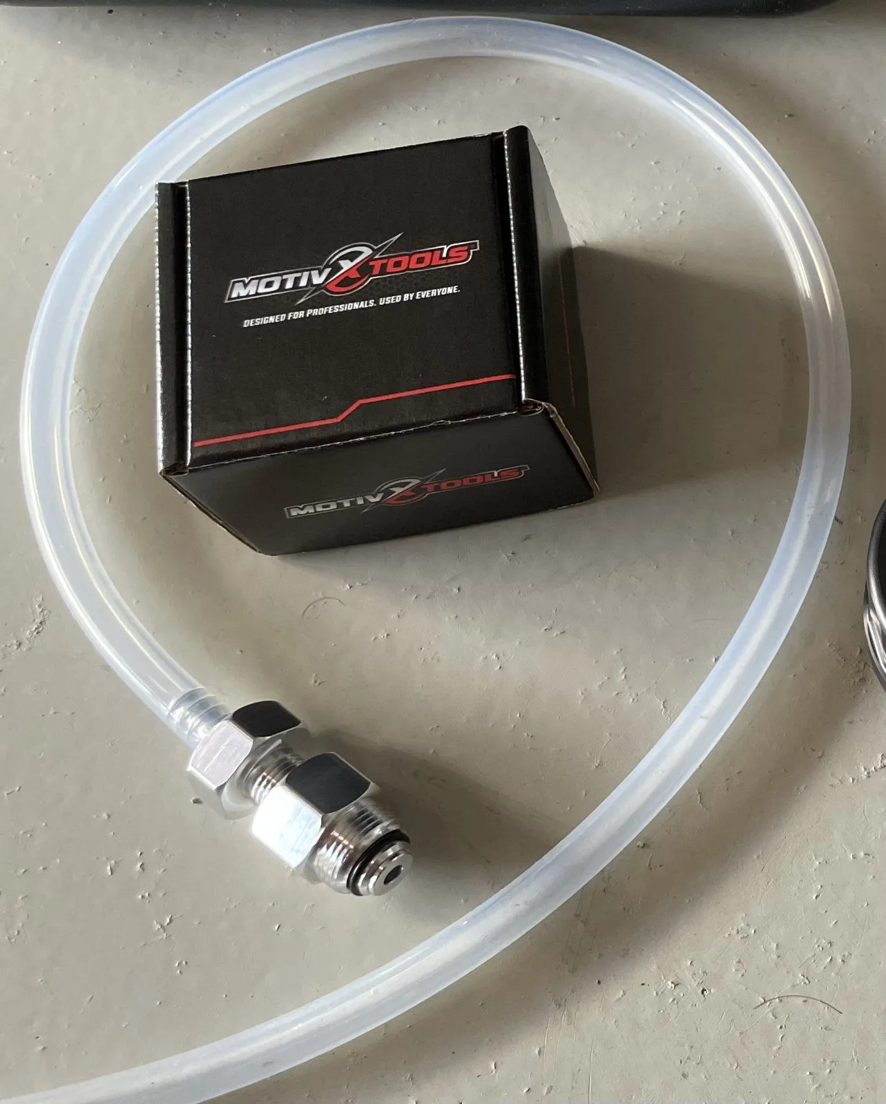

  • An Oil filter drain tool to drain the oil sitting inside the oil filter. This tool helps avoid an oily mess when you loosen the oil filter. Also from Motivx and worked great.

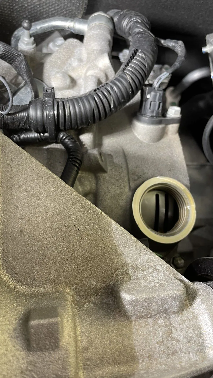

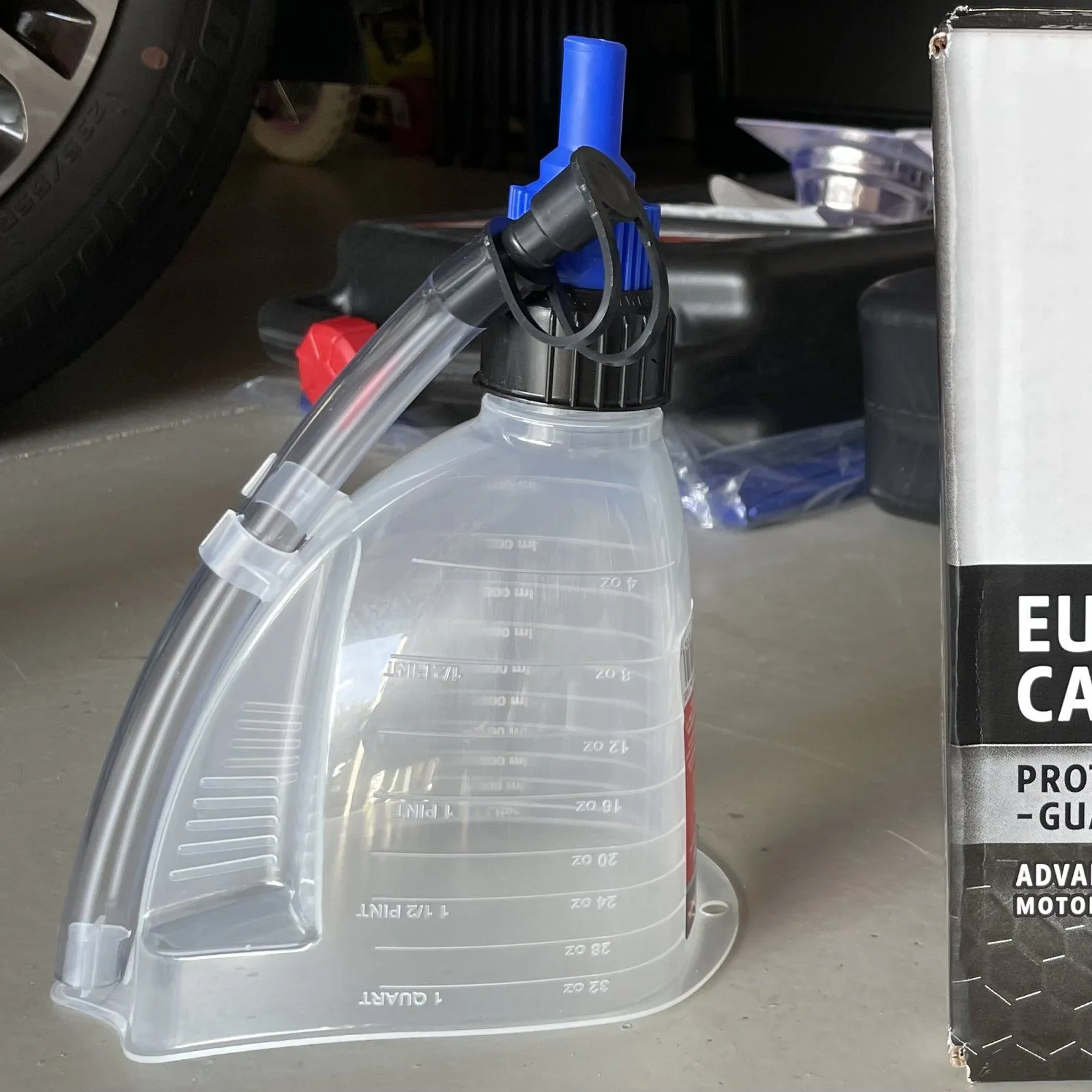

  • A funnel with a flexible hose for when you are ready to pour in new oil. Note that you can’t stick the funnel hose all the way inside the opening because there is a metal plate/filter that blocks the hose from going past 1 inch. In addition, the overall position is awkward and a second set of hands is really helpful here. This will avoid accidental oil spill on engine components.

  • Old oil filter after 12 months. 1,000 miles since last oil change. Also, the oil filter housing has the torque specs written on it.

What's the oil pan drain plug washer for?
  • #9
The washer sits between the oil pan and the nut that you take off to drain the oil. You almost have to pry it off with a flat head screwdriver.
It’s the dark ring you see in this picture.

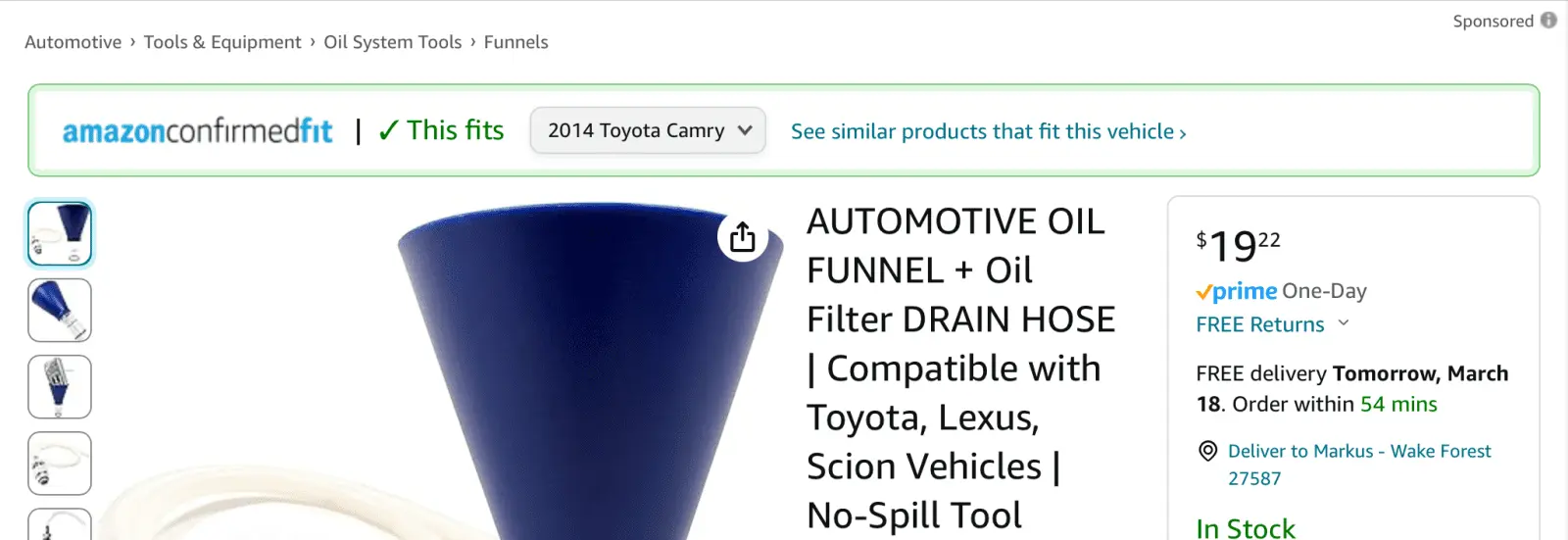

Interesting that it says it doesn't fit the Lotus Emira.
If I remember correctly, at least on the Evora, there was not enough clearance to screw it in. Might be different on the Emira.
Bump!
Did anyone ever figure out whether these screw-in oil change funnels work on the Emira? The clearances are tight but I'm not sure if this might still work.
[edit] FYI they do NOT work. Angles are too tight. Get yourself a zigzag funnel instead, like this one: https://www.amazon.com/dp/B01HRH2FRO
