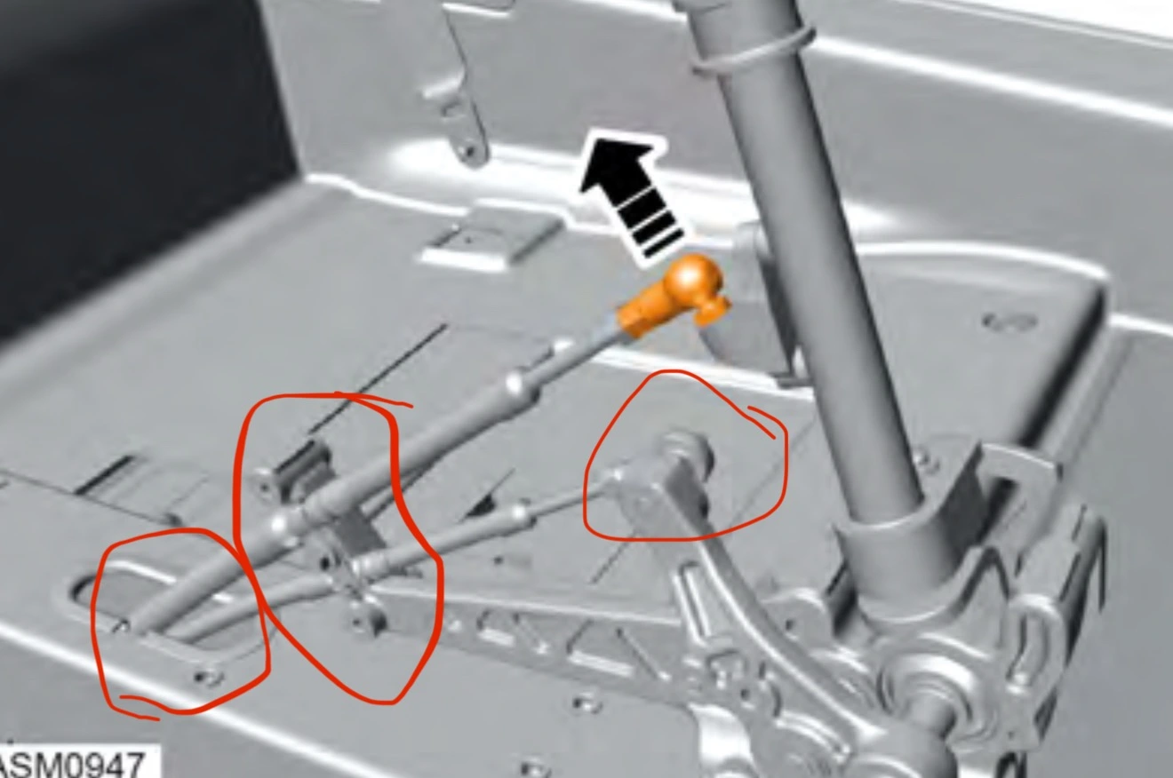

It’s actually the cross gate cable rattling. I discovered this when I did my floating console modification and the ticking became a bit more pronounced. The modification allows you to reach into the shifter area while driving and feel around — and the ticking and vibration can be felt on the crossgate shifter. Likely this source of the vibration is actually the transmission traveling through the cable and into the cabin area. I suspect some strategically placed isolation dampers holding the lines would fix this.
It’s probably one of these three places:
The cables actually run inside solid flexible conduits that have a rubber/plastic jacket. Vibrations from the trans are transferred through the cable (inside the conduit) and into the cabin. I am pretty sure the noise comes from the knuckle/bearing that attaches to the cross-gate mechanism of the shifter. When you move the shifter to either side, the cable tightens and the vibration goes away.
