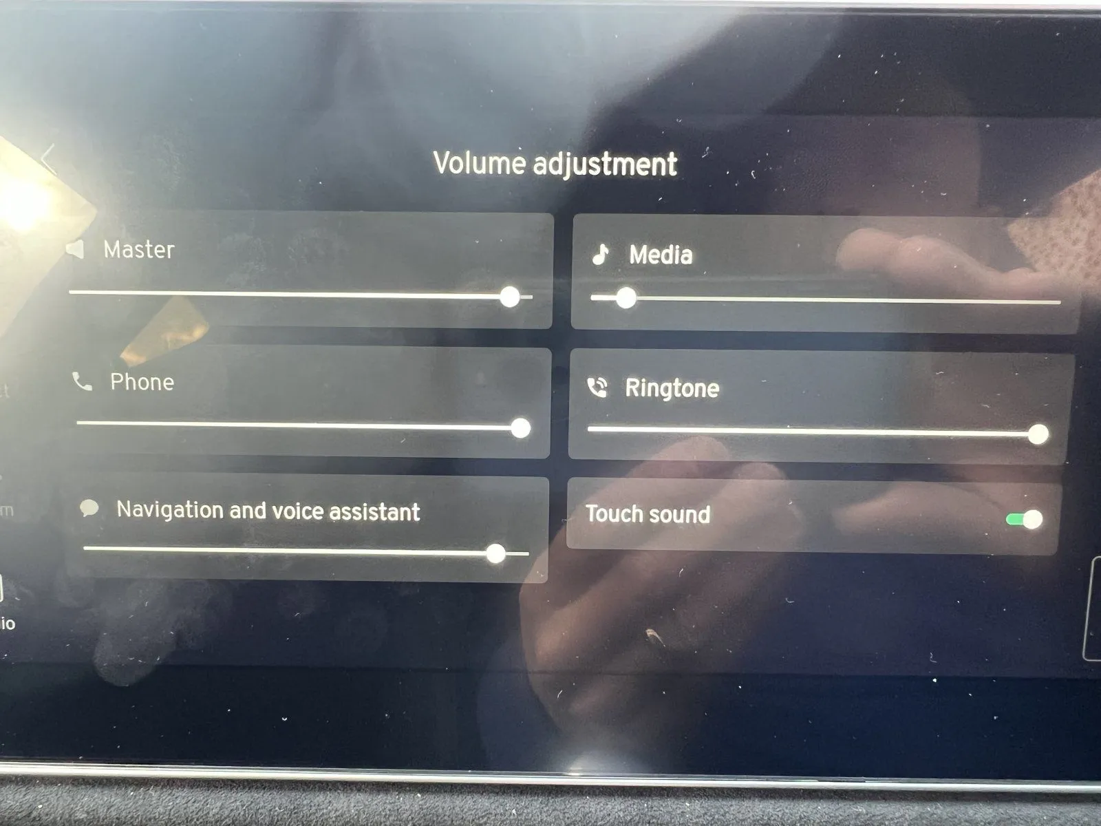

Right think I'm getting to the solution. in this menu. Problem is you need to toggle it when driving and the touchscreen isn't the most responsive, going to be some trial and error
