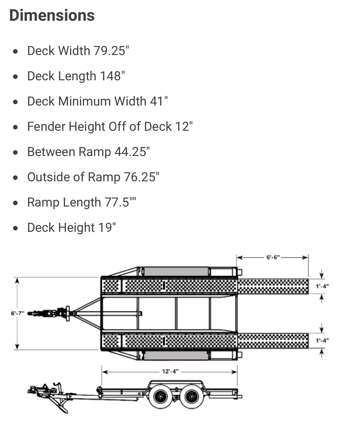

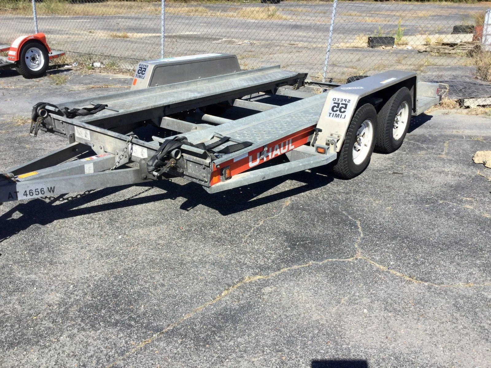

Question for those that have taken delivery. I'm 4-5 months away from delivery🤞🏼... and I'm planning on trailering my Emira from my dealer (3.5 hour drive) to my PPF installer. I was thinking of renting a Uhaul trailer but wanted to be sure the Emira would fit. Concerned about the outer width tire to tire and if I back onto the trailer the rear diffuser ground clearance. Can anyone verify these measurements?
Here is what I'm dealing with:
Your assistance is greatly appreciated.
I used one of those for my C5 a while back, I went on forwards. The trick was to build up some wood blocks under the front wheels so the overhang would clear the trailer. The straps still go over the tires so it can’t move. Might be able to do the same trick if loading backwards.

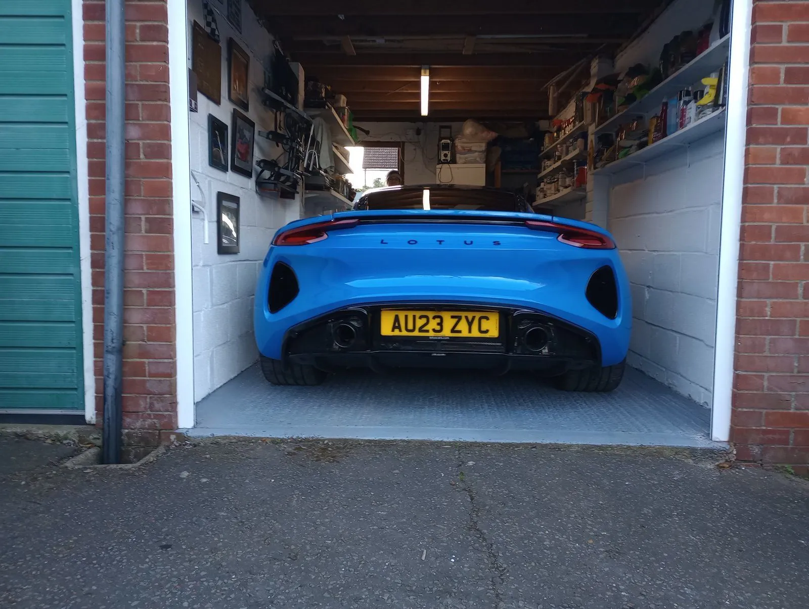

The detailed Emira dimensions from the owners handbook were posted recently in the discussion about small garages:
Awesome! Looks like it'll work. Thanks, Tom!
