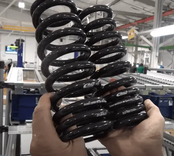

The rear springs appear to be progressive on both suspension types, with the Sport spring being slightly shorter (one fewer coil) and therefore a smaller wire diameter for a similar nominal spring rate. No idea whether there's any difference in total wheel travel, we'd need on-vehicle data and/or detailed damper specs to figure that out.
Rear spring difference from the Harry factory visit video... as you can see, both of these are progressive. Tour on the left, marked 110 N/mm rate, and the Sport on the right, marked 115 N/mm rate.
