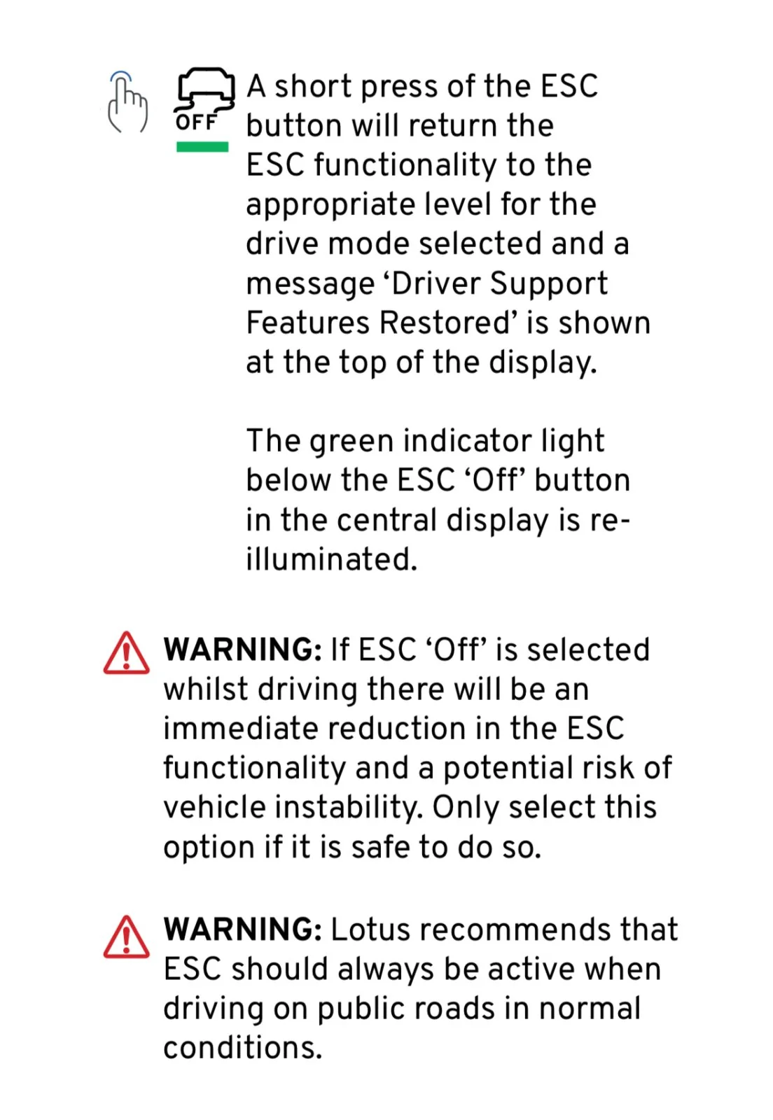

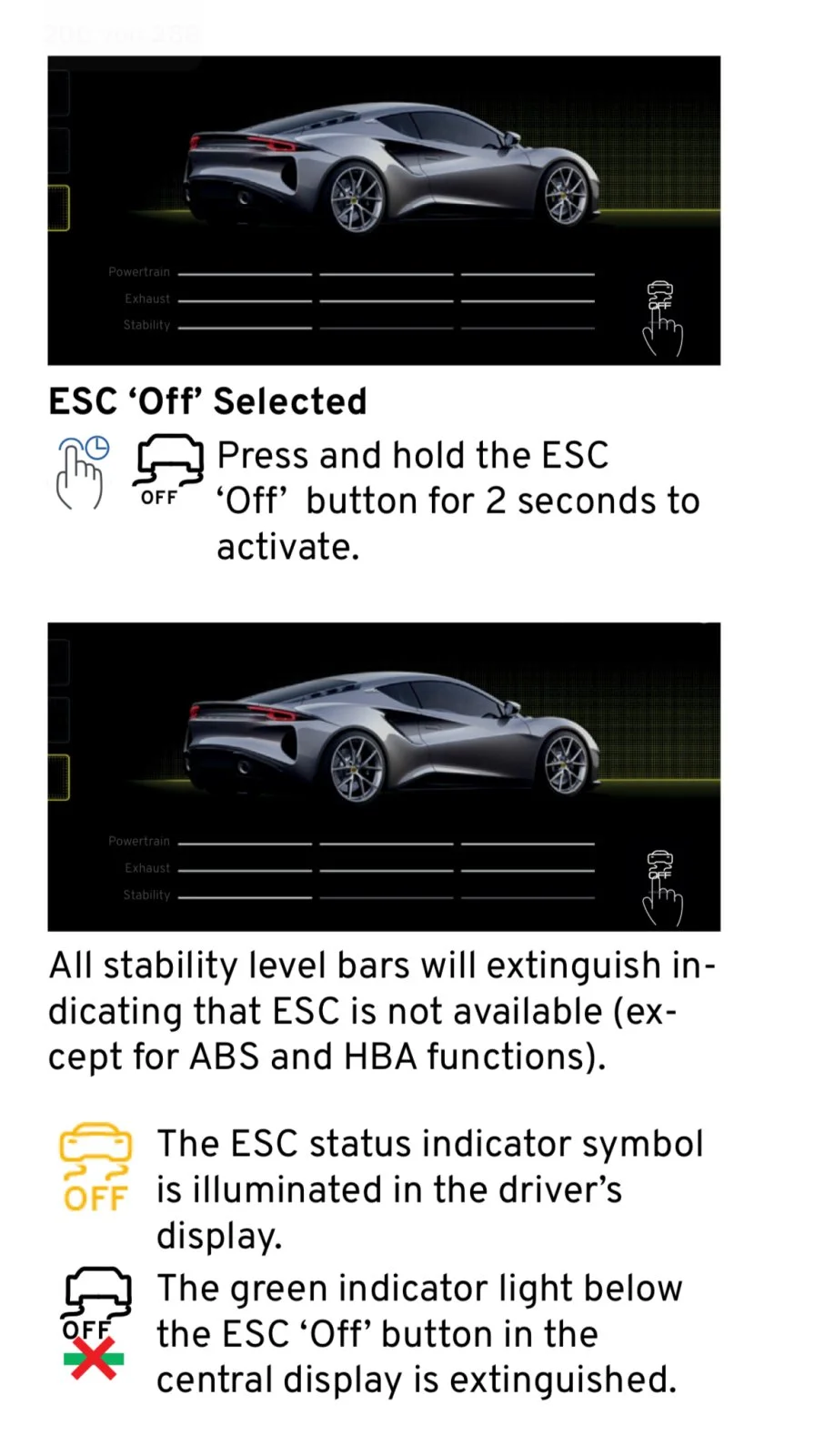

In track mode you still have some safety net when pushing hard.
In track mode you additionally have to switch off ESC completely by pressing „ESC off“ on the screen, there is a little button for this.
  • #3
Thank you for your kind reply.
I made sure to fully turn off the ESC by holding the button for 2 seconds.
However, it still seems to reactivate when I push the car aggressively.
