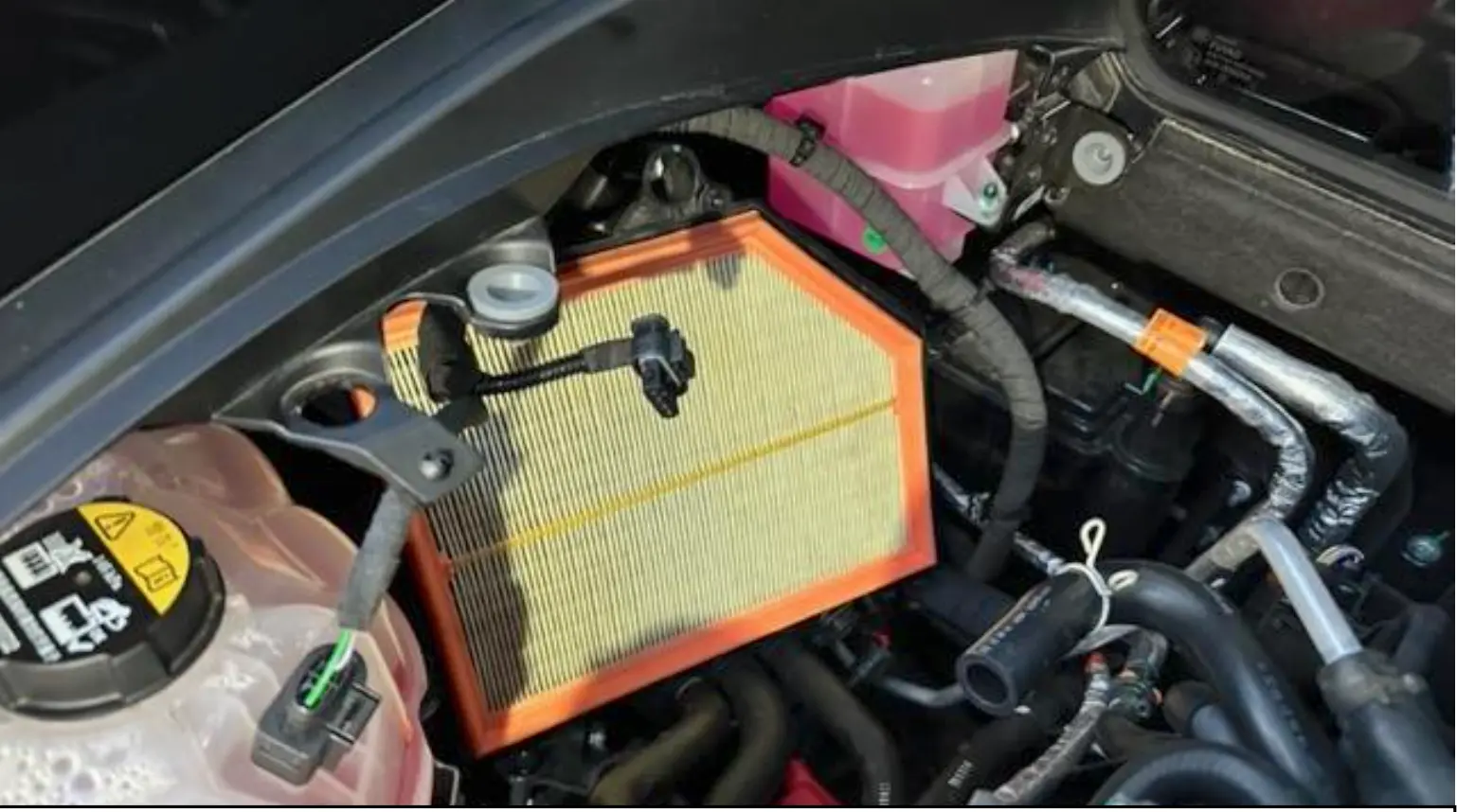

If you look at the factory intake, like every modern intake box, it's a box with a big flat, thick air filter element.
(These snaps are from the Eventuri installation guide)

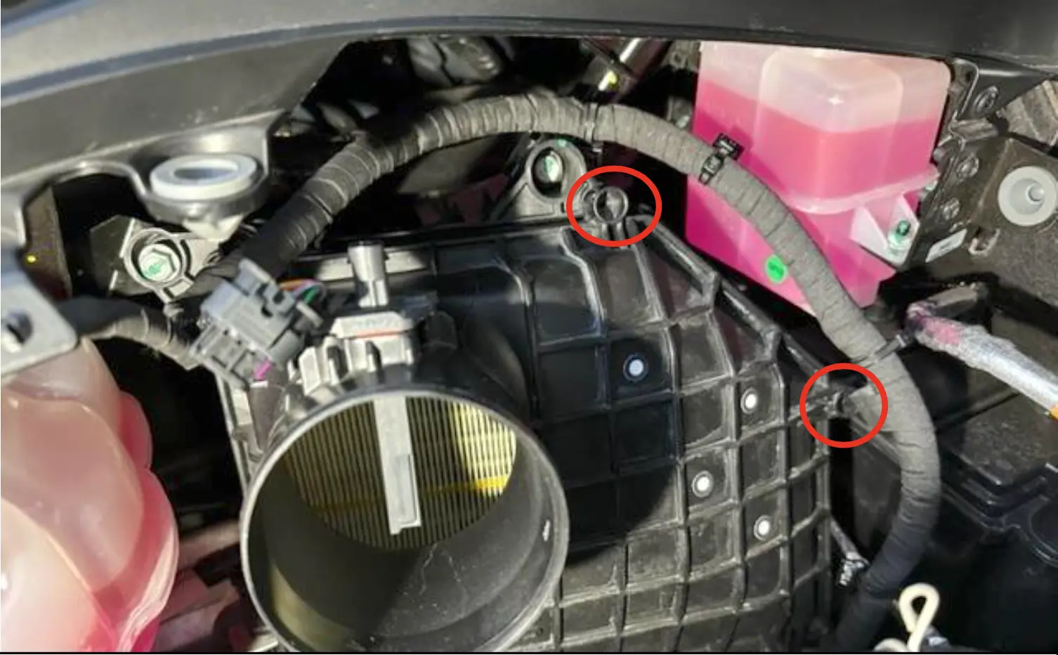

There's no focusing or shaping of airflow; it's just capacity for the most part. Air coming in from the outside just bunches up in front of that filter element. Notice the shape; that's the shape of the 'room' the air is coming into. Air does not like to change direction, in any direction. It loses its velocity rapidly.
Look at what the air is doing inside the factory box after it makes it through the filter. It has to go from that odd square shaped space with one corner lopped off, into one corner of the 'room' where it's squeezed into a tubular exit. There's nothing about this design that says airflow speed; it's just a capacity system.

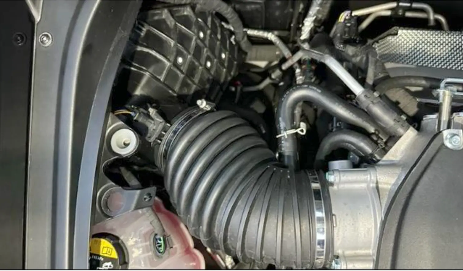

Now look at what the air has to do once it's forced into that tubular exit out of the air filter box. It goes into a ribbed tunnel that is S shaped and climbs upward before leveling off to go into the supercharger. The S shape slows it down, the ribs in that tube slow it down, and all while the air is having to change direction multiple times.

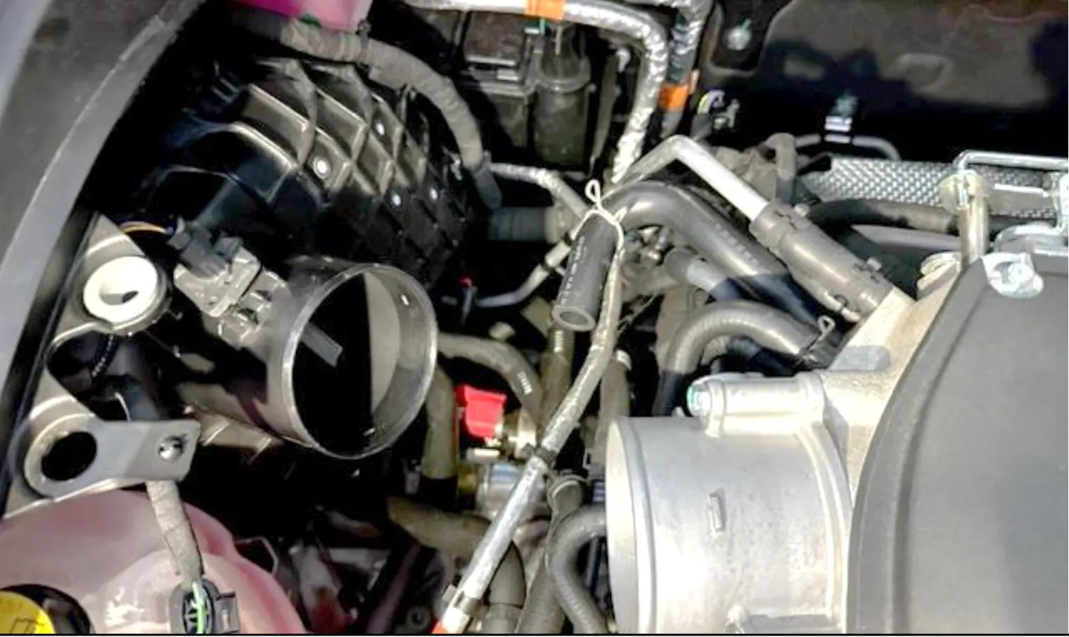

You can really see the journey the air has to take here with the flex tube out of the way.

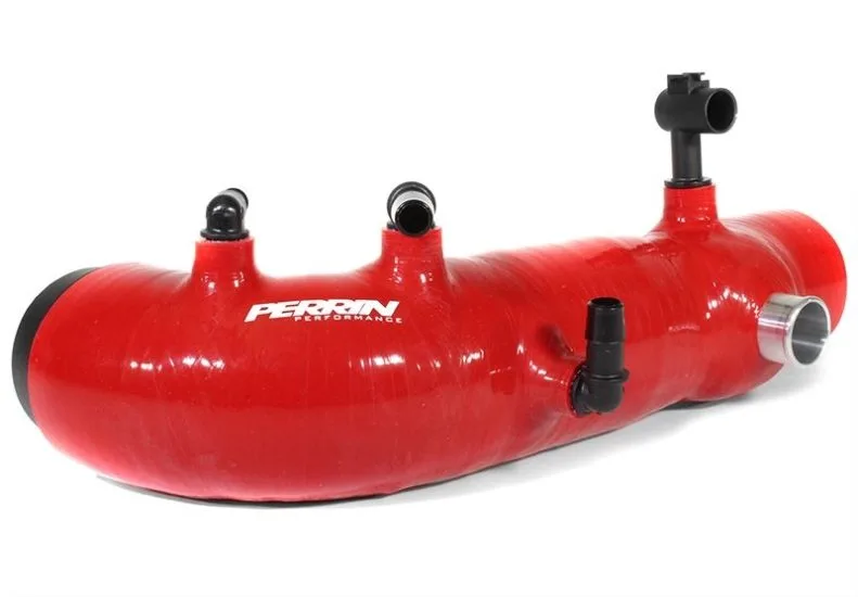

You can accomplish that just fine with silicone hoses. For example, I ran this turbo inlet on one of my Subaru STIs with no issues. It's multi layer silicone reinforced by a SS support wire:

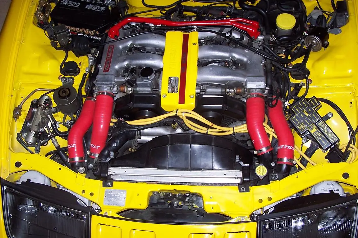

And here are the silicone boost hoses on my 300ZX twin turbo.. No issues with melting or collapsing, even at 28psi and over 450whp.
