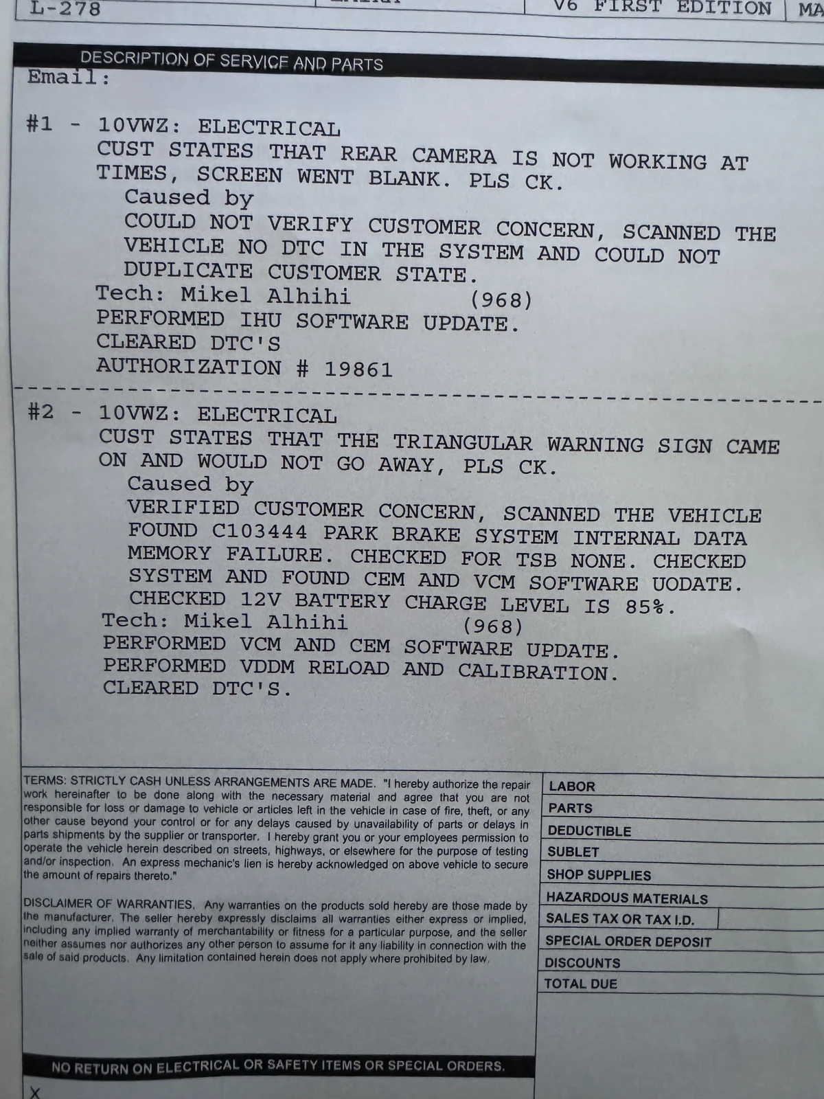

Have you returned for service since delivery?
Wiz33
Sep 5, 2023
418
375
Just a FYI. I don't know how many of you have gone back to the dealer since you got your car. I have now gone back to the dealer twice since I got my V6 back in last Apr/May. First was last July for my 1000 miles oil change (not required but I'm old school) and it received like 4-5 software updates although I have been trouble free at that point. Then last week at 3800 miles, I got a yellow warning light on the dash and my rear camera have failed to come on once with a onscreen message that rear view camera not responding so I took it in. Although they can't duplicate the camera but there was an infotainment system update. Then there was 2 other update relating to the yellow warning light so 3 updates since last July. If you haven't been back to the dealer for a while, might want to at least call to check and see if there are updates for yours. They also installed the trickle charger lead for me for free (it wasn't installed on the V6 but the i4 came with it already installed)
Thanks for posting this. Love to see a list of SW updates available for these cars. Was the charger lead included with the maintainer or a separate piece?
The battery charge lead is included in the trickle charger package.
