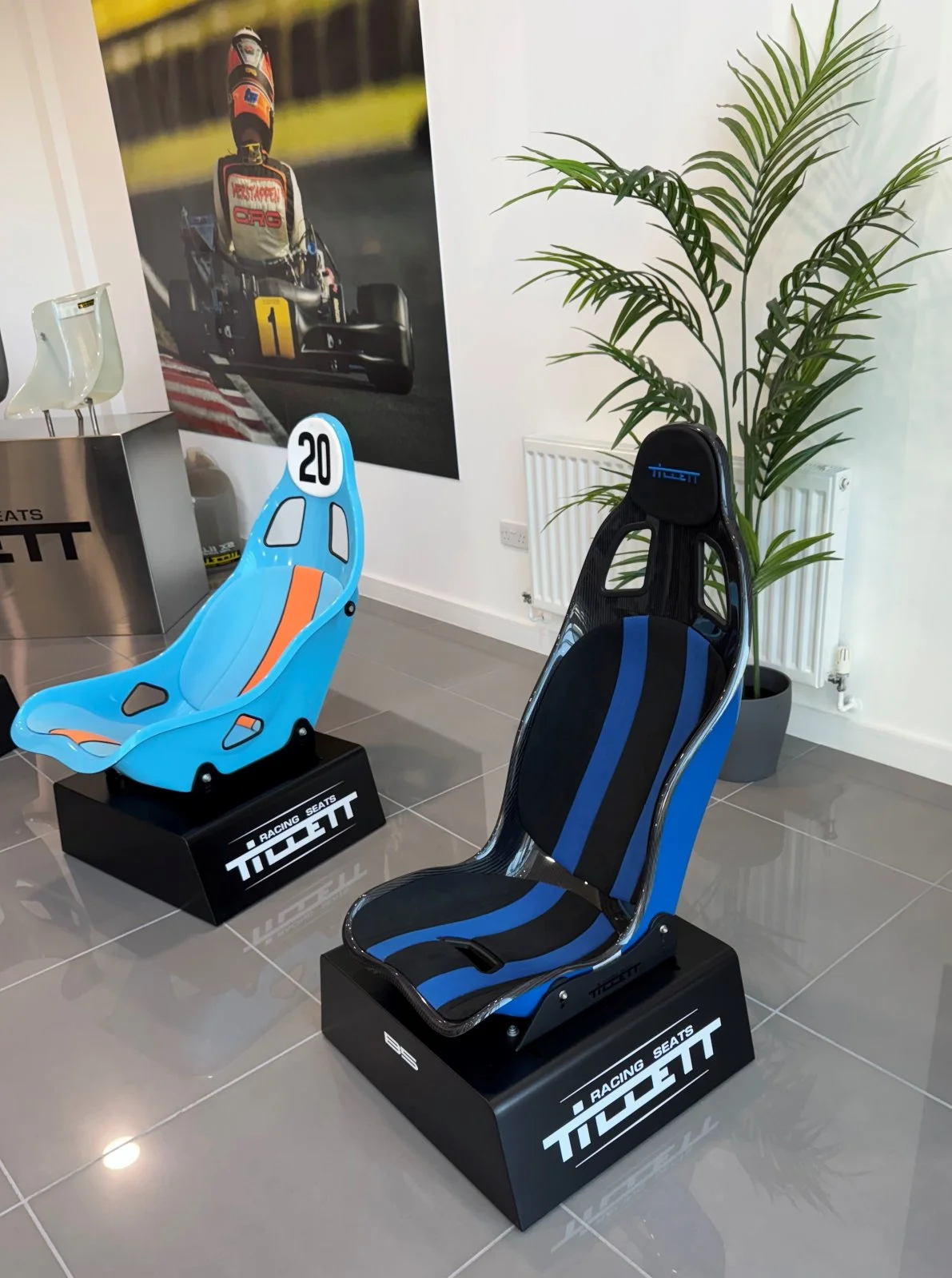

Mr. Tillett, please show & tell more about your custom finishes. Especially the blue seen in the background around the 2:19 mark :)
That’s a B5 carbon GRP seat with two blue suede stripes. I will get a photo because it is still in the showroom. I couldn’t find a picture of that one. Basically you can dream up what you want within reason.
The most difficult thing is matching specific colours when the customer is not in the UK. We do have standard stitch patterns like diamonds and a hex pattern which have a fixed price and a choice of thread colour. Leather, suedes. All of which have to be quoted when you request the design. Embroideries are possible too. If you go through a dealer for example if you are in the US. We will still work with you to get the panels specially made. Normally a request to Leanne at customerservice@tillett.co.uk is the best route and she can send you an order request form where the office will price up your request but we may suggest a local dealer if they have what you need in stock. Then the panels are easy to retro fit as they are on a thin composite matched shell.

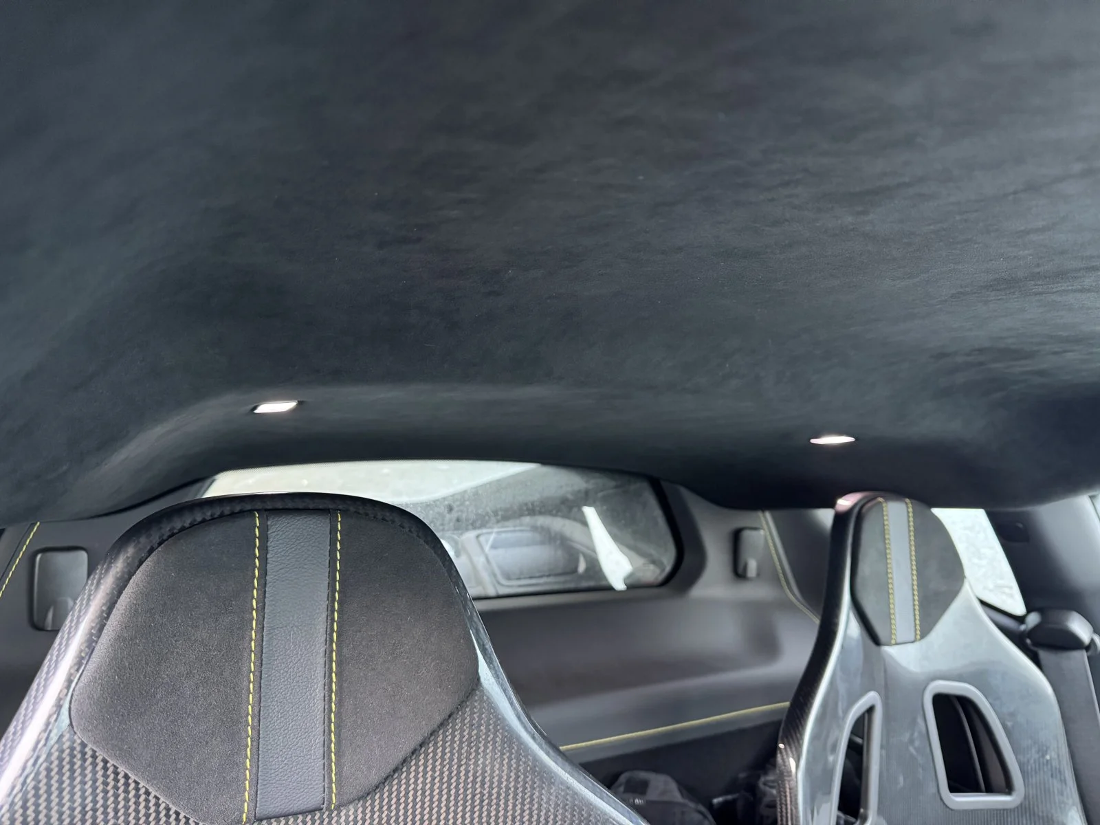

on the photos it already looks like the headrest part is close to the roof lining, lifting it up by 1inch or more will make it touch it or is there a substansial gap still? Im also 5.9 and think the current setup will be too low for me aswel and will also needing it to lift up, however I would aesthetically not like it if the headrest area is very close to the roof.
Steven could you please take some pictures from headrest level or mid level up? Most pictures are take from above that shows the entire seat it the but yet have to see a pictures that faces up or is mid level of the seat to have a better view how it sits in the car. Thanks
That brings up a pretty good point about "room" for some kind of tilt forward mechanism. It would have to have a tight enough sweep that it does not hit the roof while pitching forward. Likey not possible.
I’m 5 ft 10 and shrinking.
I have it set on the brackets one hole down from the top.
We have models with lower headrests if this is an issue for you like the B6 Screamer and B7. Also the B8 and B9 have a straight back which sit you more upright.

Tbh I like the shape of the b10 the most, its just that the back part looks a bit too high for my liking (its not about the headrest size), i need to see/test seat first before purchasing but the trouble is that you have none in Dubai available. With regards to the other models, they look too sporty/racy to me.
5’8” on the top bolts with padding should be fine imho. I’m 5’9” and 1 down from top with padding will likely also be fine.
Headrest is in a good place too for that height, the clearance to the roof liner isn’t even a concern to me — if it clears it clears.

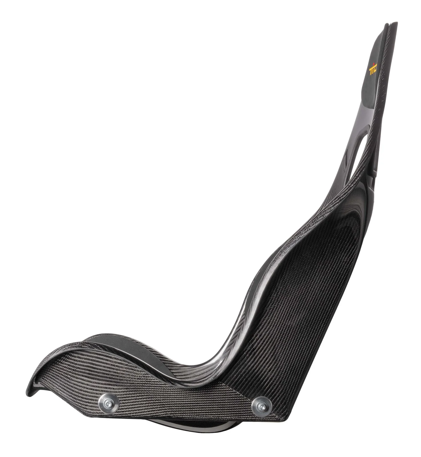

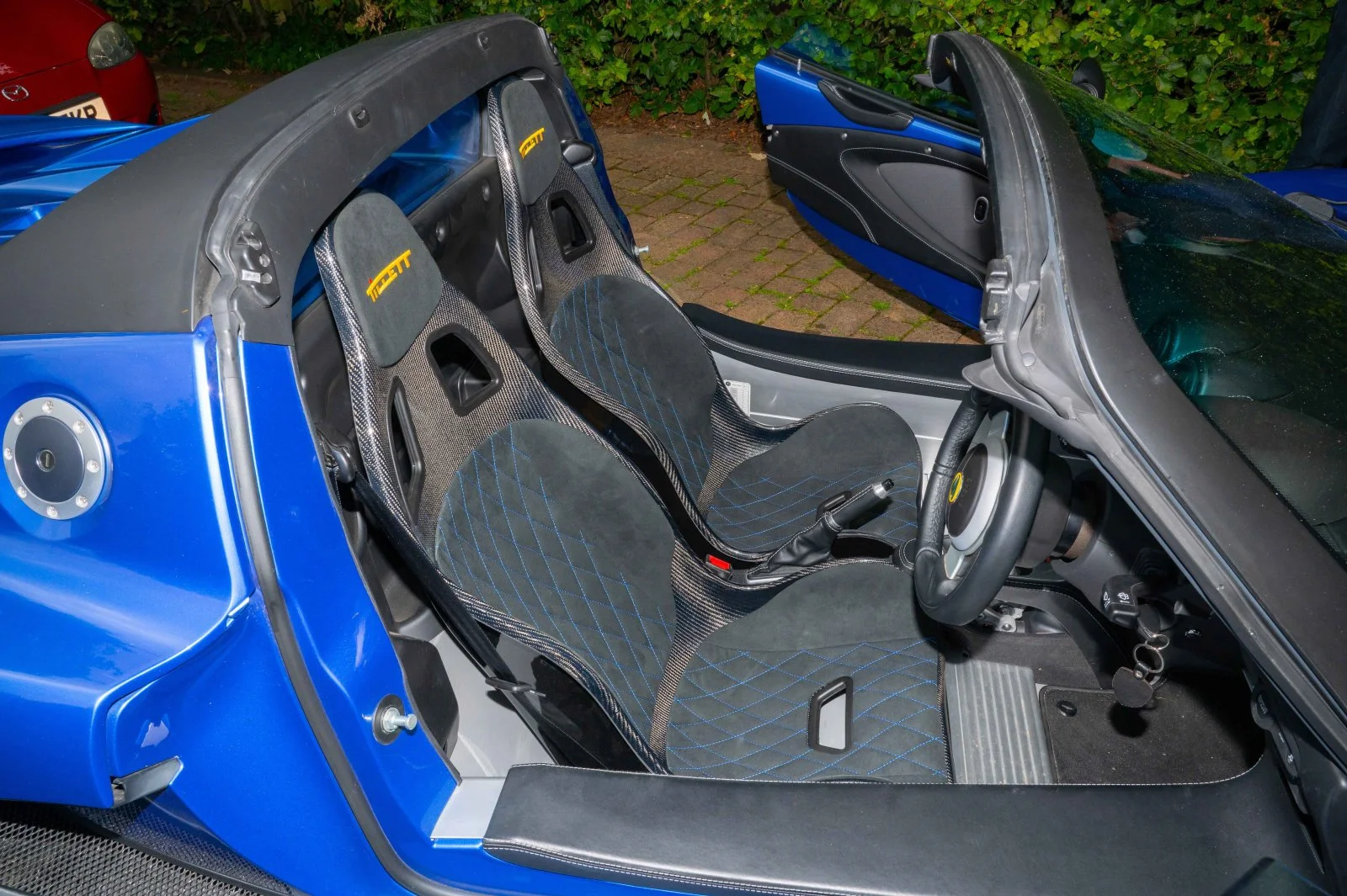

The B9 has similar low sides for a road belt and is the lightest seat we make.
