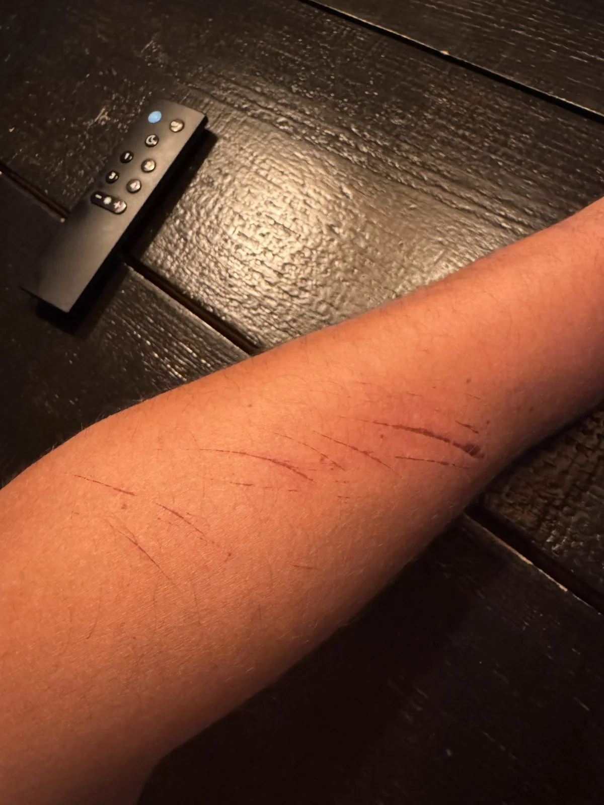

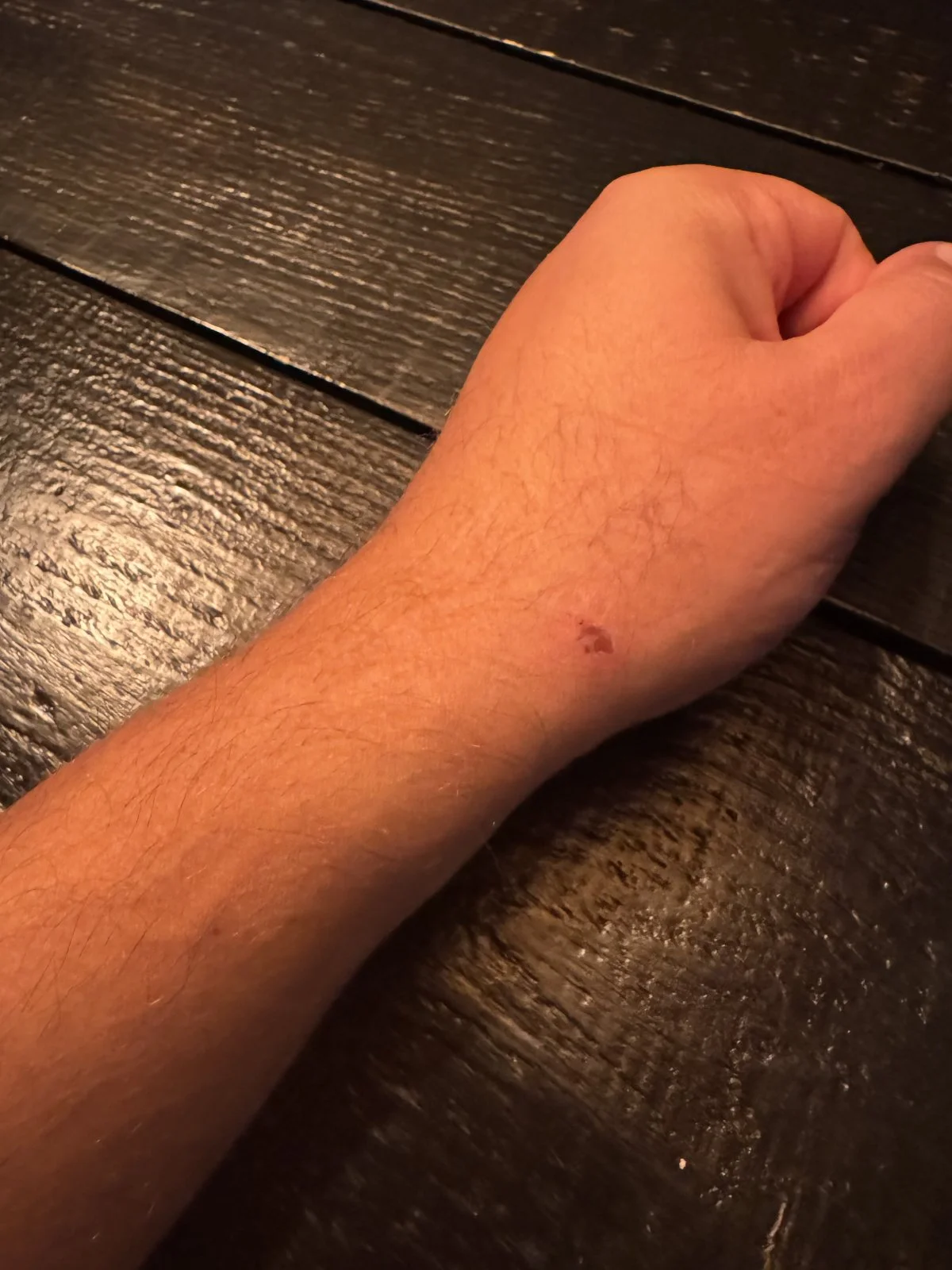

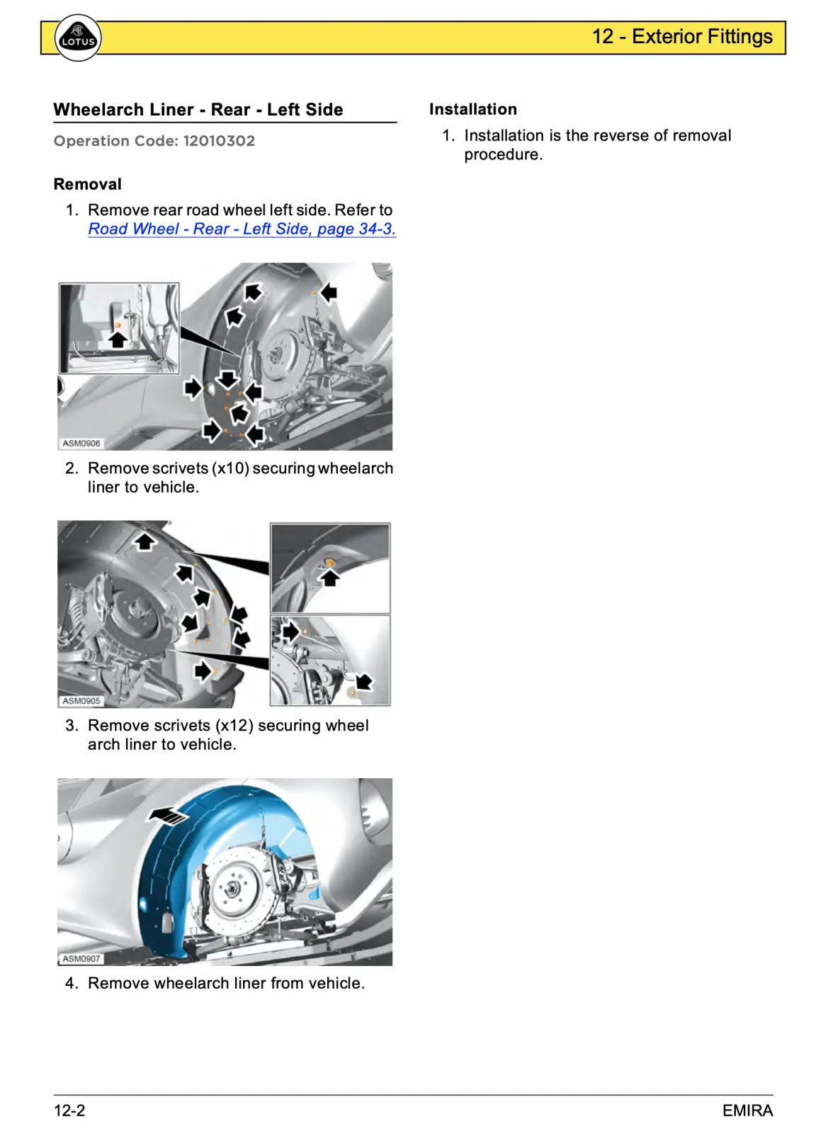

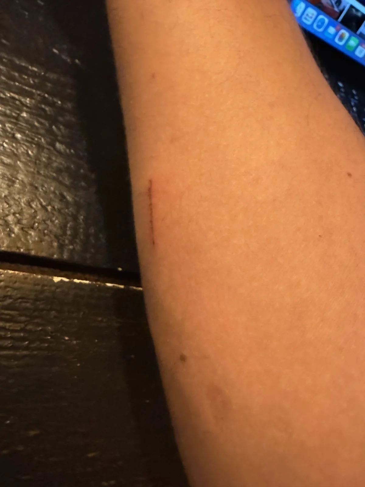

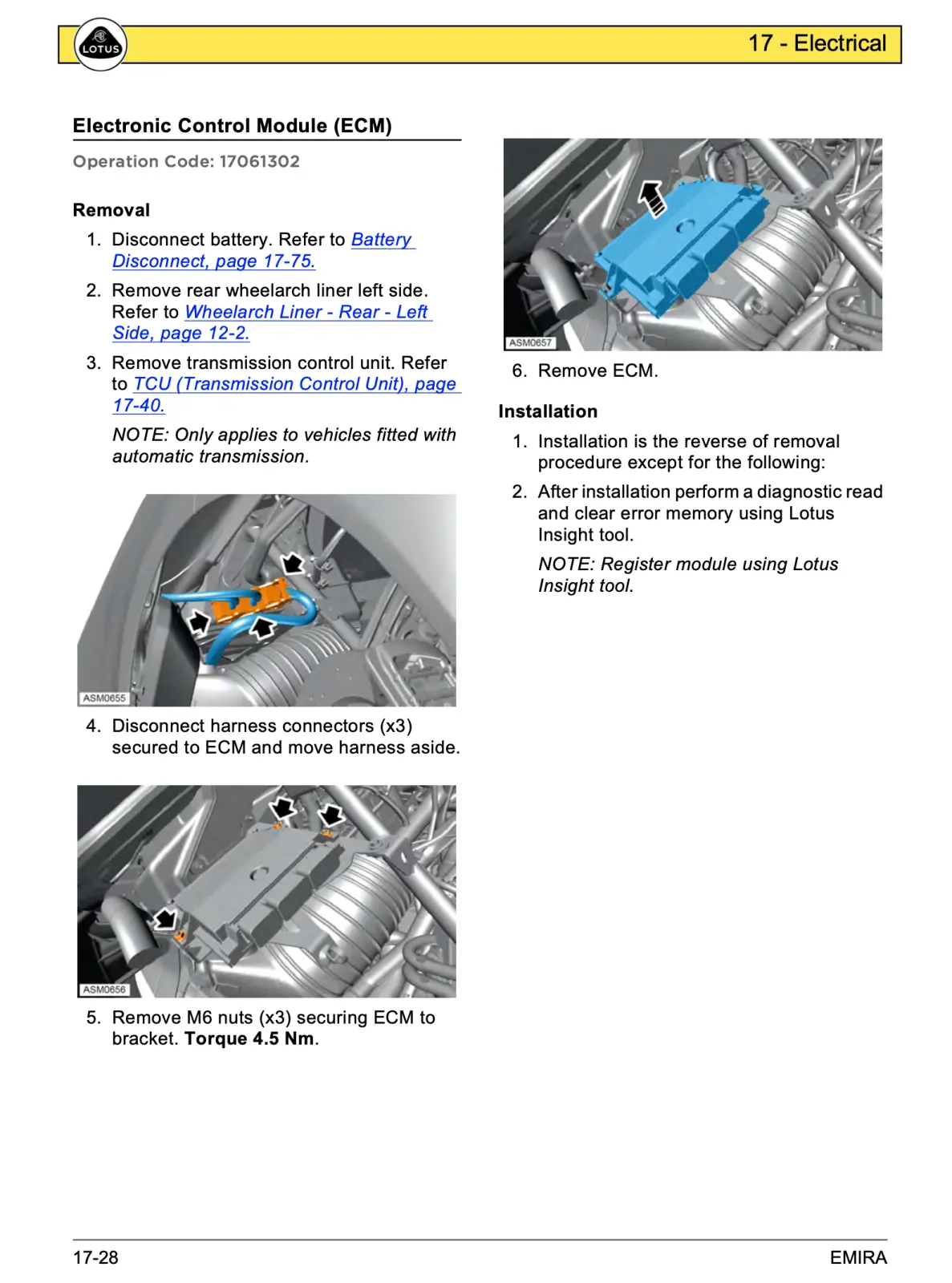

Did you install the 440 or 460?
Trying to install mine.. but its not that easy, not sure how my hands will fit in there. If anyone has a workshop manual page to access/remove/replace the ecu, id be happy then to make a video of the install for the group here.
It’s the 440 and yeah they say it can be done through the engine bay but unless you have long skinny arms is the only way.
I went through the left wheel well. Took about and hour and half start to finish but I wasn’t trying to rush it. I’m sure you can do it in an hour that way.
They are going to uninstall my ECU when they update it so they will be doing it the “15 min” way through the engine bay so I will try to video it or take pictures.
