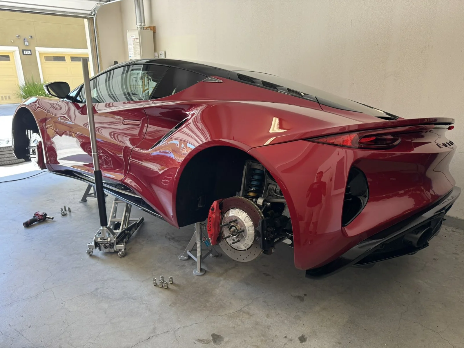

I added wheel studs and 12mm spacers on all four corners to see how much clearance there is on the OEM alignment, I will be getting an alignment next to see how much camber is possible for track duty and to help me measure clearance for a 3rd party track wheelset as the OEMs are for street only for me.

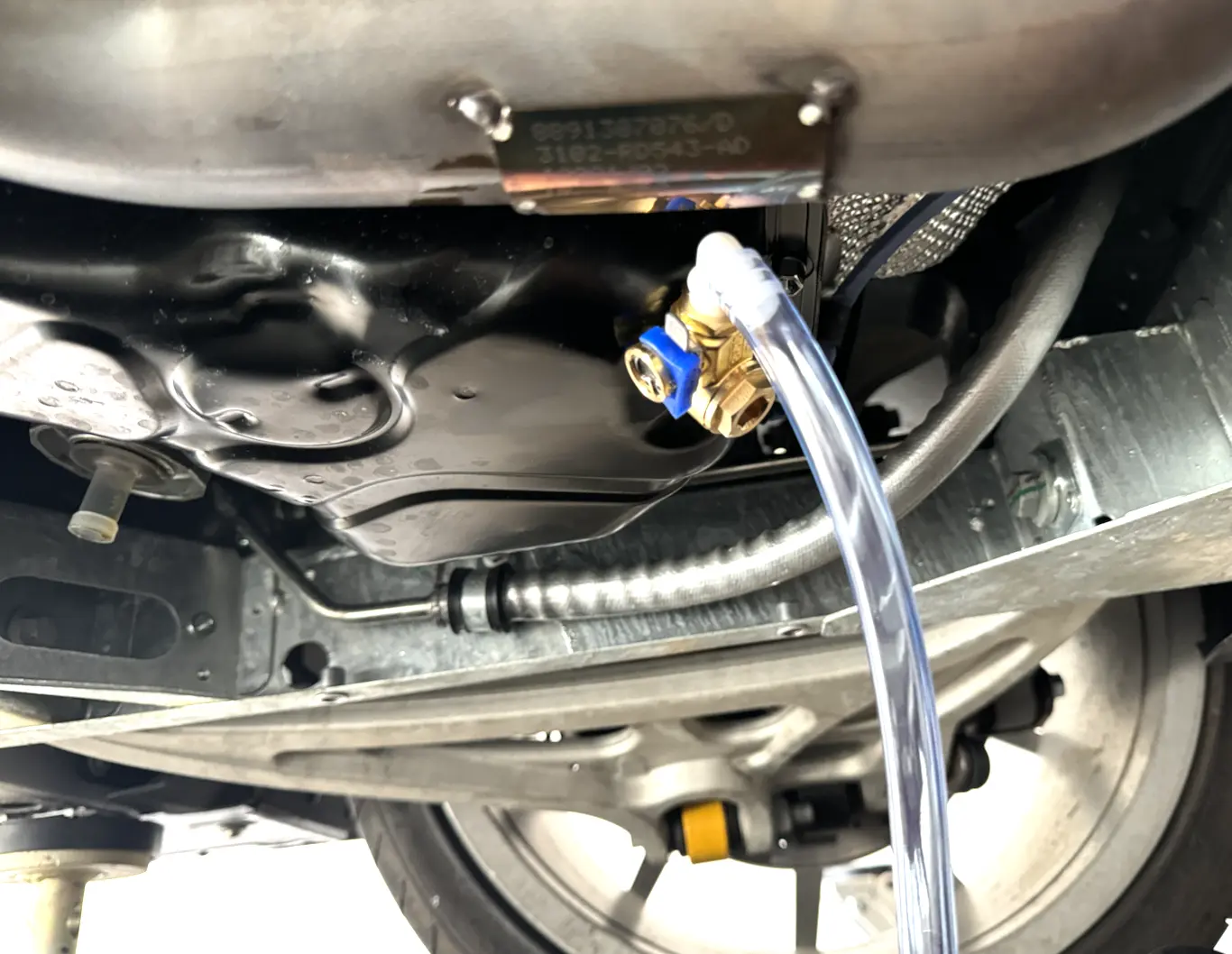

For those who have thought about a fumoto drain plug for their Emira -- don't bother -- none of them clear the lower aluminum cover panel. This is one of the most low profile ones they offer.
I'll find a different solution, but in addition to this I'd like to cut access ports for oil drain plug, oil filter, and transmission drain plug and cap those with access ports with another aluminum piece and bolt them shut -- same as how the existing aluminum panel is held on. I really dislike removing the 20+ bolts for the giant aluminum panel to access this stuff, it adds easily 40 minutes to the oil change time to remove and reinstall.
