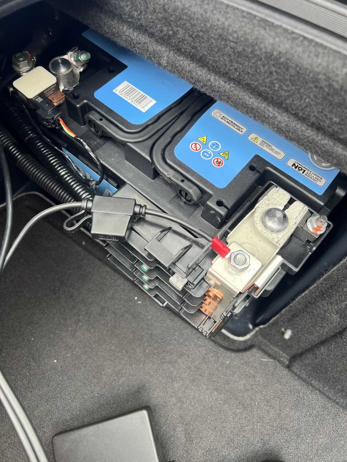

I charged mine before installation, just be sure you're using a charger that is for lithium batteries. The charger that's included from Lotus apparently works for both AGM and lithium. Just loosen the terminal clamps from the factory battery, and lift the clamps up. You only need to undo the front holder clamp at the bottom of the battery (I removed it completely) and the battery will slide out. Do the reverse to install the Antigravity battery.

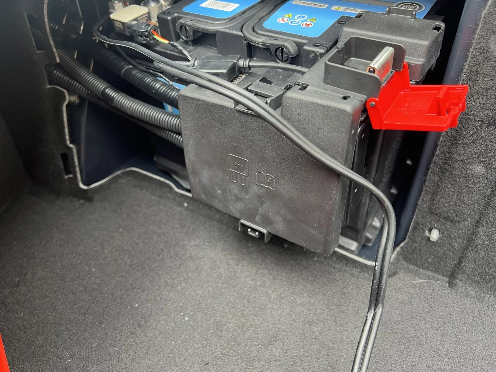

It’s super simple to just disconnect the old battery, disconnect the old battery and slide in the new one. The hardest part for me was to trim down that black cover piece to fit the pig tails of the new charging cable
