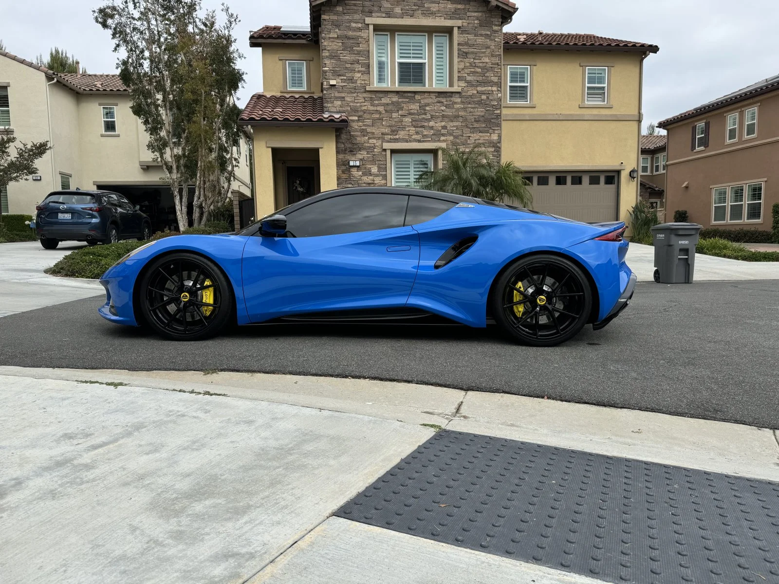

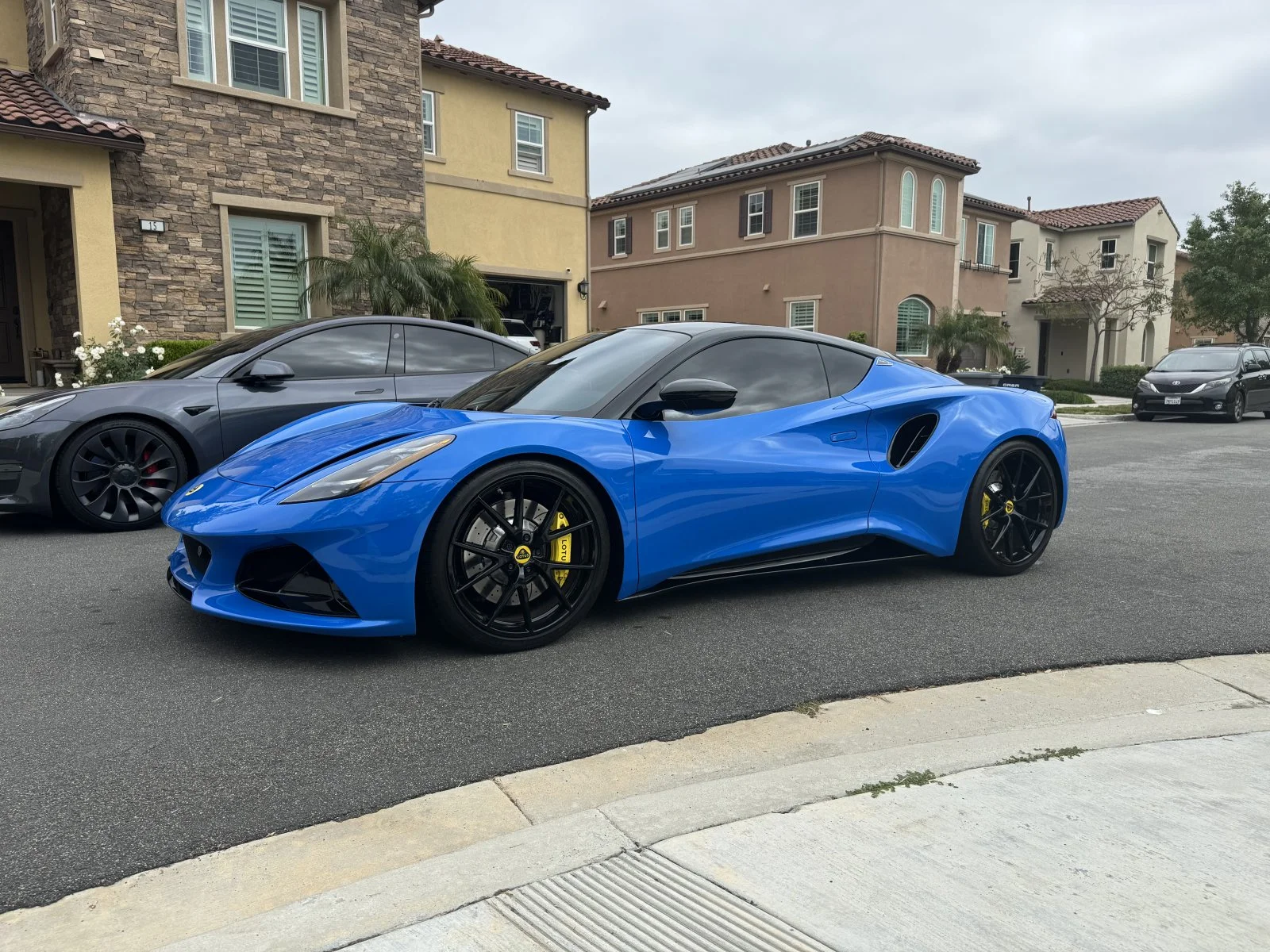

I threw on some Nitron Coilovers, posting since its seems very hard to find lowered Emiras!?
It looks good... Here in NJ we are getting more speed bumps and do not want to take a chance
on bottoming out my Emira...But does look good..
Looks great....assuming 10-15mm lowering? Are you going to space or stick with oem offset?
This is the absolut perfect amount of lowering the Emira. Very well done!

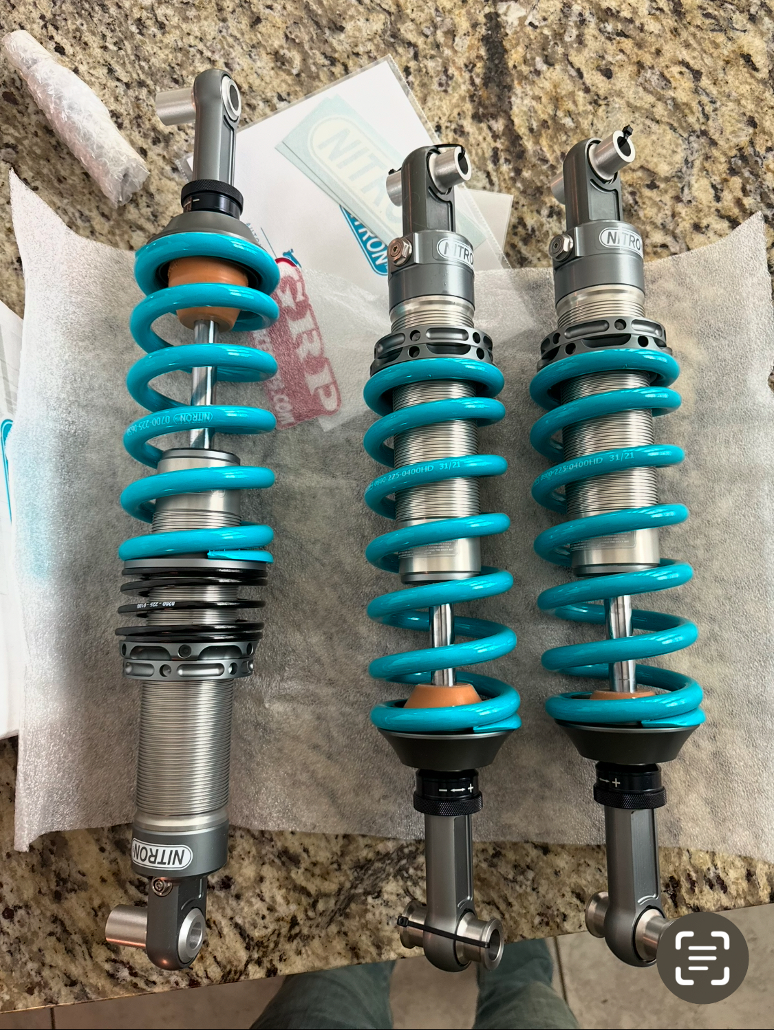

Yes, shredded one from the GRP system rubbing it, when installed was about 1/4 gap but gap closed after settled
interesting... hopefully it's not a normal thing. I'm sure GRP will respond if not.

Originally had the GRP coilovers, shredded a CV boot with those.

For everyone who shredded a boot with the GRP lowering sleeves, how much clearance did you have between the boot and the lowering cup?
1mm?
3mm?
More?
Was that 1/4" gap distance between the boot and the locking nut, or between the boot and the spring purch?
Fwiw and before false info is spread here:
There is no possible way for the suspension to “settle” and decrease the static gap between the bottom spring perch and the CV boot. It’s a fixed mechanical setting. If the perch made contact or “shredded” a CV boot adequate clearance was not set initially.
When I installed the first set on my personal car I set it with a 1.5 turn gap (approx 2mm) and it barely touched the boot. I then gave it 2.5 turns/4mm and it has been problem free for 2750+ miles.
