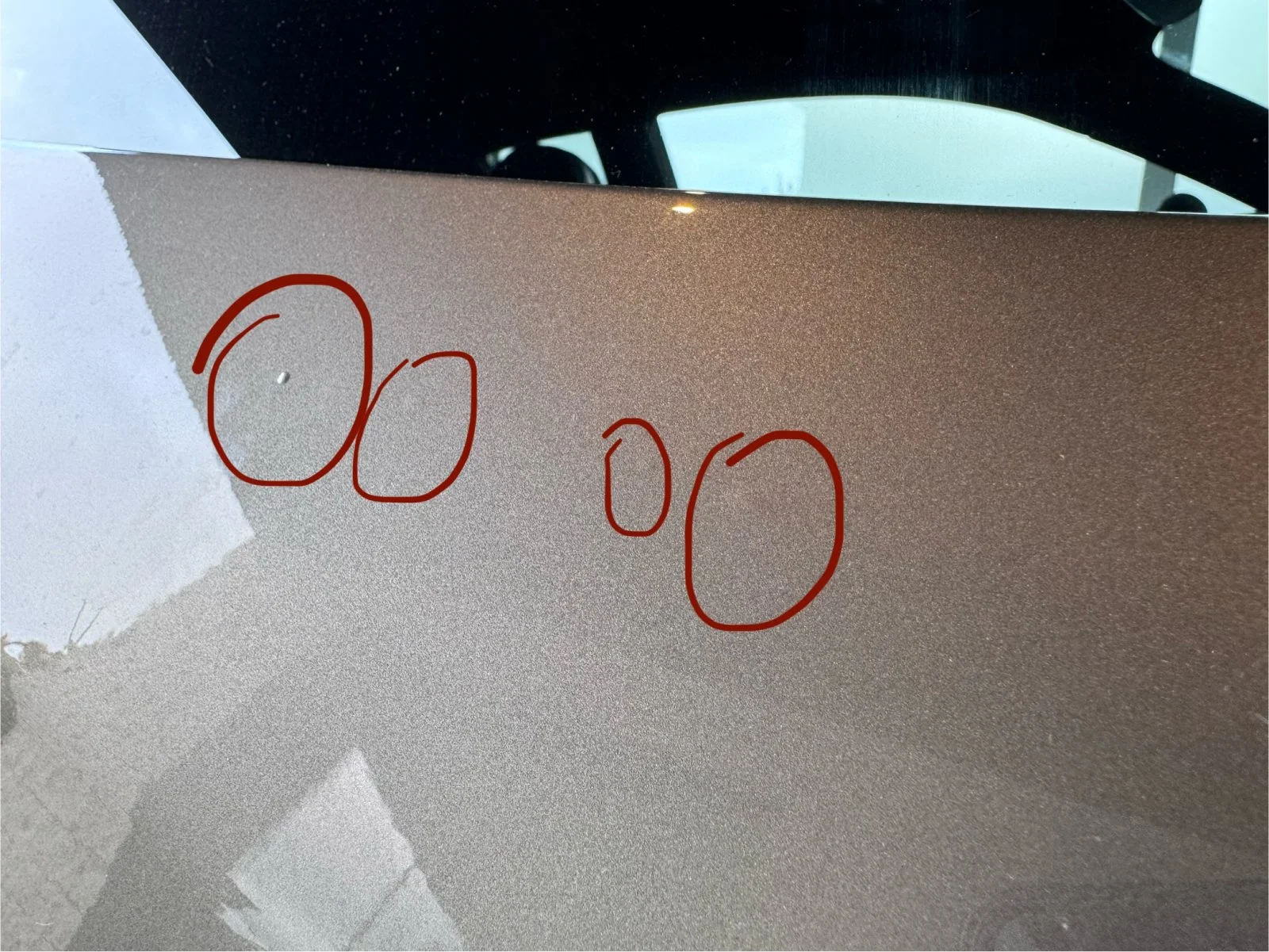

After 1.5 years of ownership I now have the blistering paint on both doors - see attached pics of passenger door, which is far worse.
Build date as per certificate is 10th October 2022!
Car was delivered in Dec 2022, then fully PPF'd, only covered 4081 miles, is always garaged, not used in the wet, last washed 3 weeks ago, which has more than likely delayed the appearance.
Went for a drive in the sunny weather last Wednesday (17th July) - The blistering wasn't there when we set off but was there 5hrs later...
Dealer wanted to see the car. They will replace both doors and cover the cost of the whole PPF to be redone pending Lotus approval.
But, I'm number 39 in the queue at my dealer, so 6+ month wait, plus I'll lose the use of the car again for a while, plus my time and fuel driving it back and forth...
Pissed off is an understatement :mad:

Number 39… to replace panels???
To clarify - There are 39 cars with defective doors in front of me solely at the dealer I'm using in South East England...
Holy crap. What a disaster.
Implies that Lotus could eventually end up replacing panels/doors on hundreds or possibly even thousands of cars.
Yes.....
Think I have just proved it's a ticking time bomb depending how much you use the car + in what weather conditions.... :mad:

It’s mega frustrating and I feel for you. Only good news is that it’s happened now rather than after the warranty has run out.

Given it’s a manufacturing defect, it’s going to affect soooooo many over the years. I really believe it’s just a matter of time.
18 in the queue at my dealership (not including those already repaired).

If you believe they actually fitted later model cars with an updated version of doors, then Lotus might do a recall before hundreds or thousands file warranty claims for this problem. They could drill a water escape hole and retrofit the inside panels or something. That would be the smart thing to do anyway, so maybe for that reason they won’t they won’t do that after all. 😂
Just spotted paint bubbling on the courtesy car's boot lid that I've got while mine is in to get the bubbling fixed! Not sure of the history of the other panels on the car or the build date but it was registered Sept 23.
I've just had the doors replaced and PPF reapplied after a few months wait. The job looks great, you really can't notice. I was really worried about getting a match on the DV metallic paint. The car was away for a month in total.

Around the same built date (received the car in November 22) and blistering just appeared a few days ago (with PPF too) on the door … Wating for dealer feedback.
