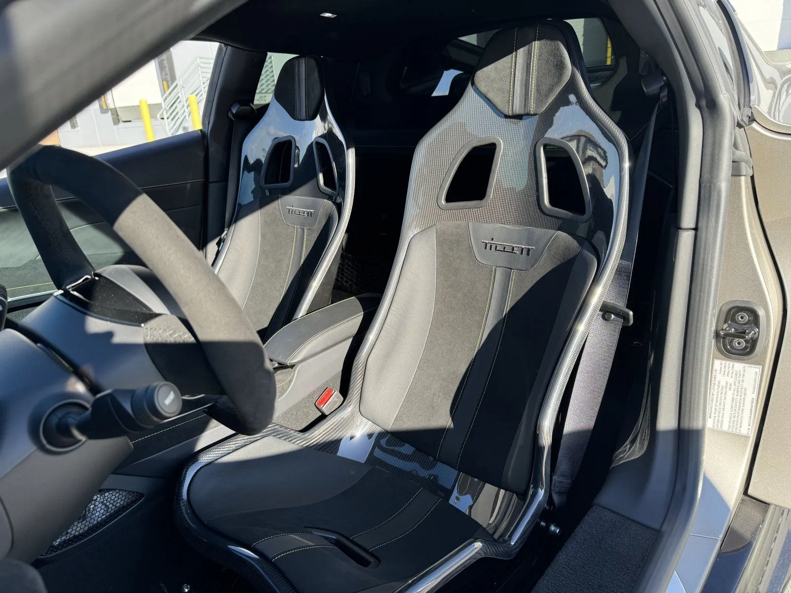

My seats are better for a bad back, not worse. I was getting a bad back after two hours with the standard seats. I drove to Spa last weekend and my 55 kg daughter was next to me. The seats were perfect for both of us.
The B10 has zero pressure points, so you hardly feel the seat and with no squashy foam they hold all the vertebrae in position. If these bones do not move they don't hurt. We always have an initial reaction where people make comfort assumptions based on looks but when people sit it them they always change their opinion.

I went away just last week and would say that inconvenience is a small price to pay for the feel, rigidity, support and dare I say comfort.
All up it is also 30 kgs saved and a much lower driving position if you want it.

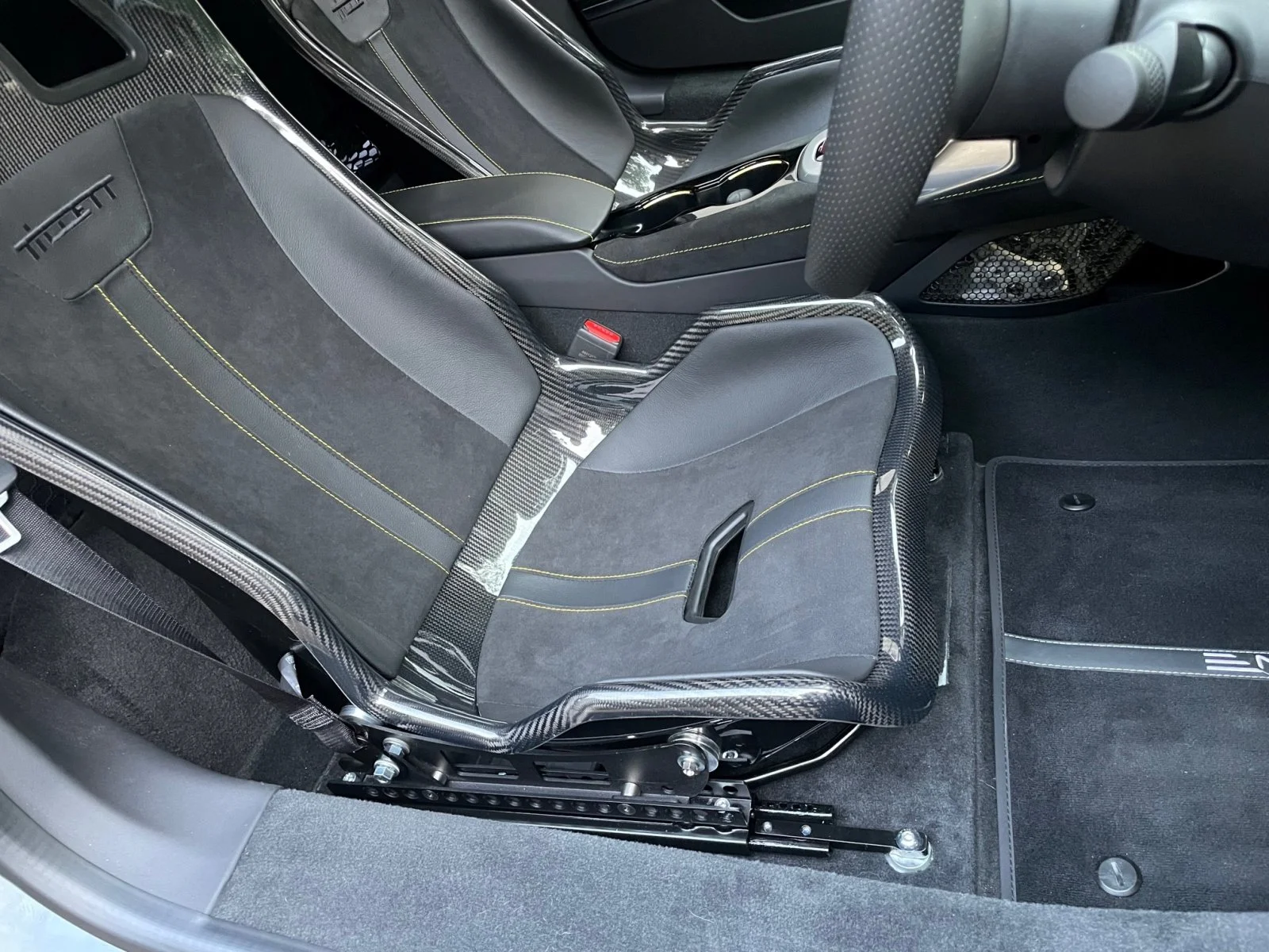

No, with our seat and runner kit you have numerous adjustments in height and angle, anywhere from slightly higher than the the lowest setting on the OEM seat to a head height 4 inches lower than the stock seat can manage.
But, it's not "live adjustable". It's set with the intended driver, sliders front-to-back will accommodate some other drivers, but anything height or tilt is not trivial to adjust.
Oh sorry, no you have to unbolt it to reset the height. My 5 ft 5 daughter drives it without resetting it though. it's not like it's undrivable for a shorter driver. Also there is more front to back adjustment with the runners than the electric motorised ones provide.
You would not normally have an issue with tilt when the steering adjusts so well. The seat is designed to work at an angle that 90% of drivers would not need to change.

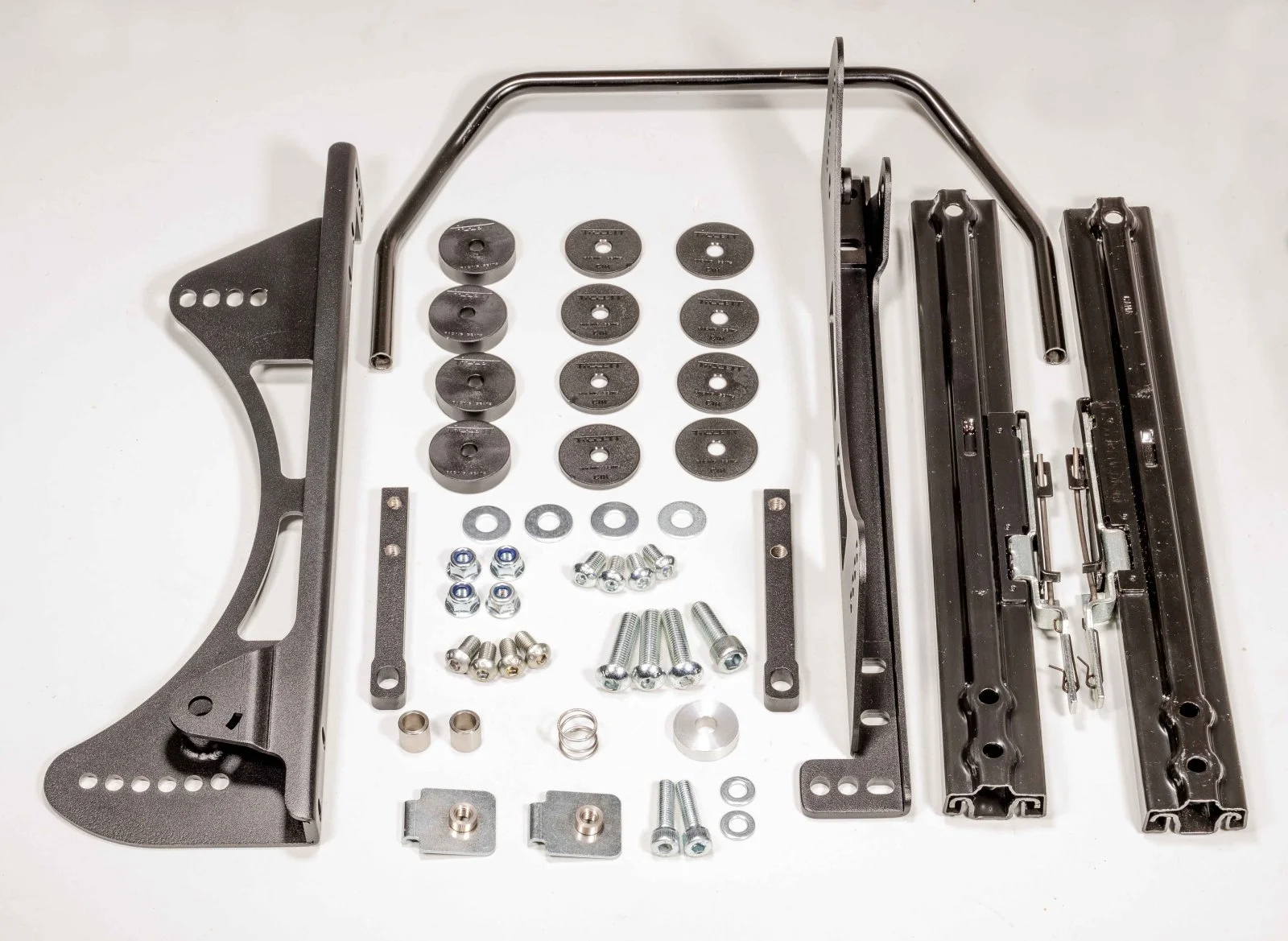

@Steve Tillett but could you make an angled runner? So that pulling it further forward also raises it slightly?
At the front of the seat under the runner is a 1 cm thick metal spacer. By adding a bigger steel spacer, or an additional one, you could lift this runner angle and re adjust the seat angle on the brackets. The ally seat belt receptor fixing spacer that comes in this kit would do the job but you would need to order a couple extra per seat.

But then it would be tipped backwards unless you countered it with another spacer in the back.
There should be a way to make runners that slide forward at an incline without changing the seat angle.
The overstuffed feeling seat and high seating position is hands down the worst thing about the car for me.
You would just lower the front on the brackets by one hole to compensate for the increased angle on the runners. The only downside would be a tendency for it to shoot back a bit quick.
