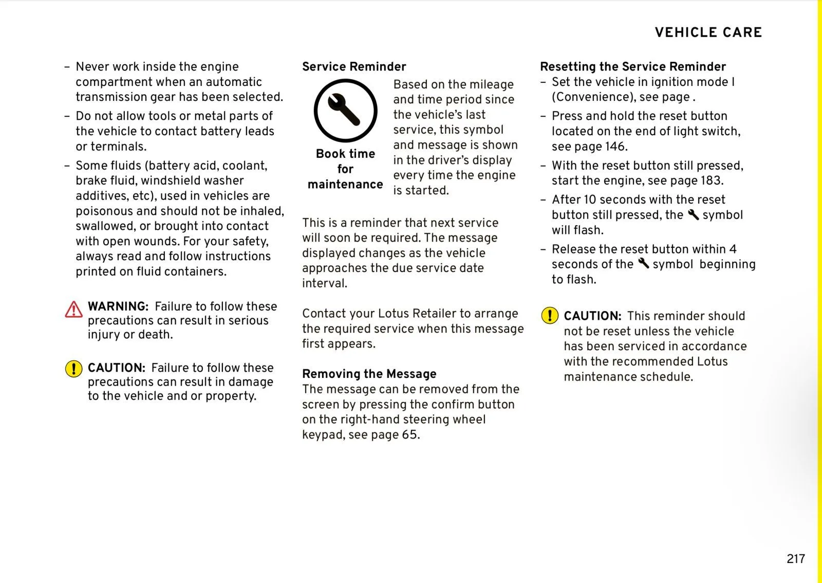

Question for DIY community, what options are there to reset oil change indicator and other service related messages? So far my search did not show any options like the icarsoft solutions, etc……
or are there options like with BMW that you can enter the service mode by various stalk and dashboard combinations?

Page 187 in your manual
unfortunately we have not taken delivery yet in the US, the pdf manual page 187 does not talk about service interval reset options, but I did find it on page 217 in the online handbook
thanks for the hint👍

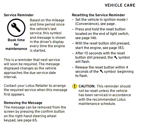

seems like they are different, that's my page 187
