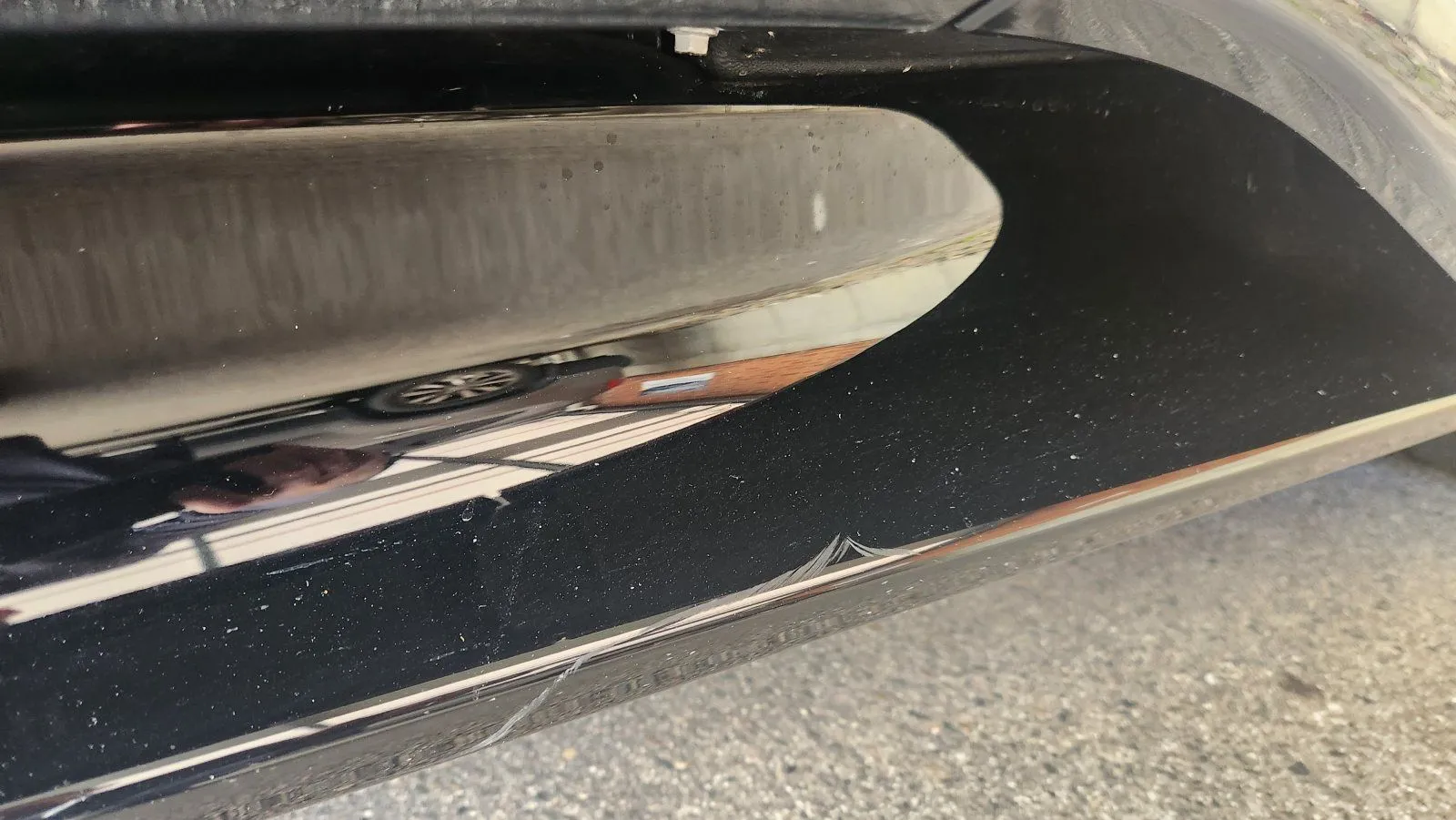

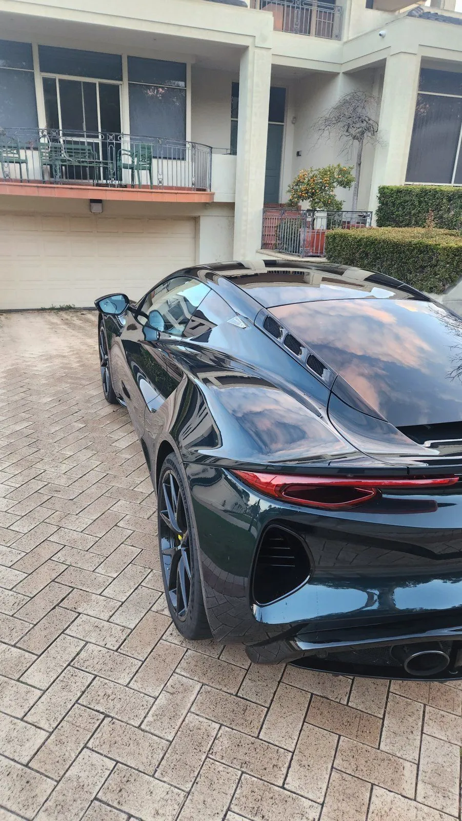

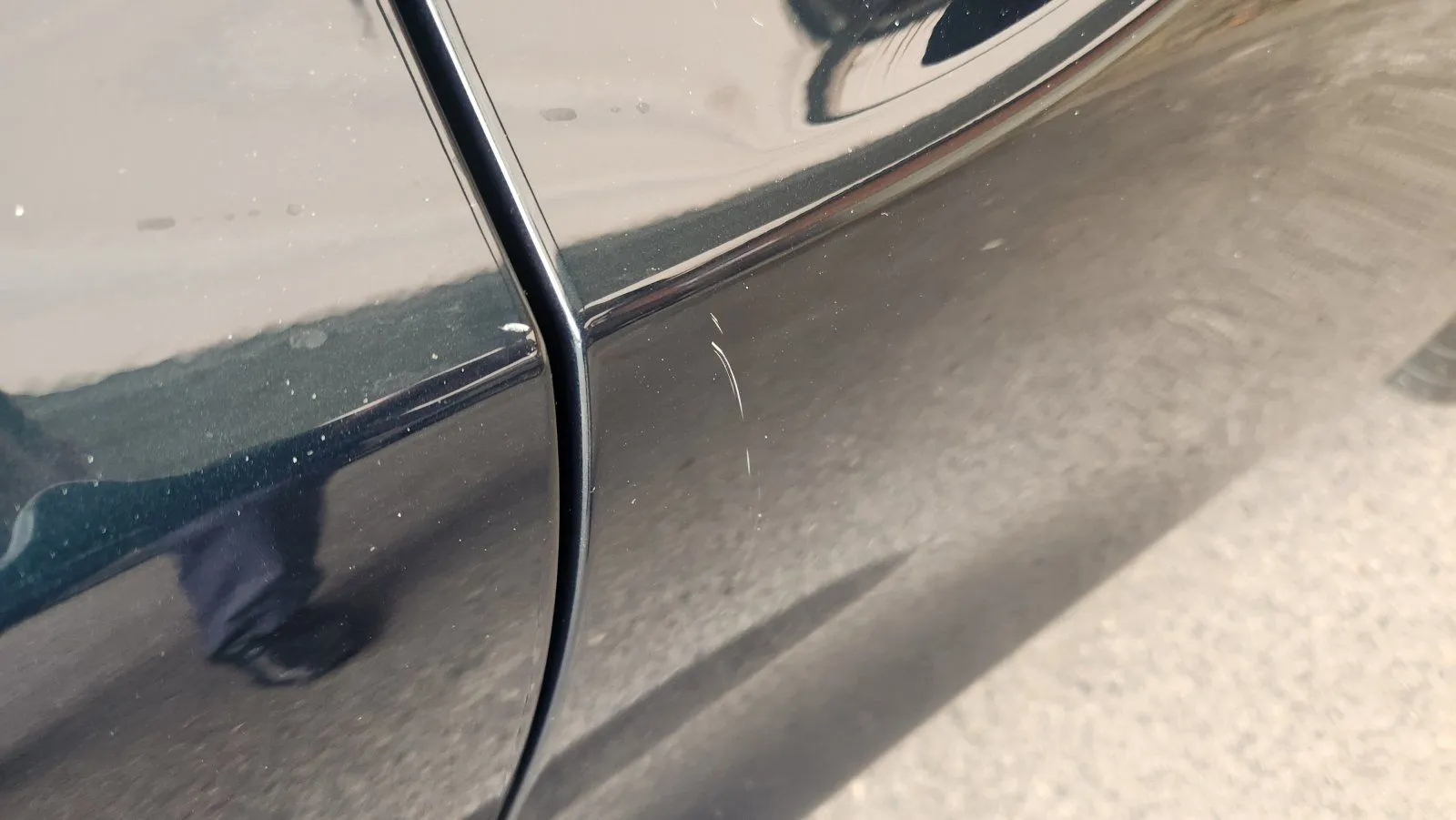

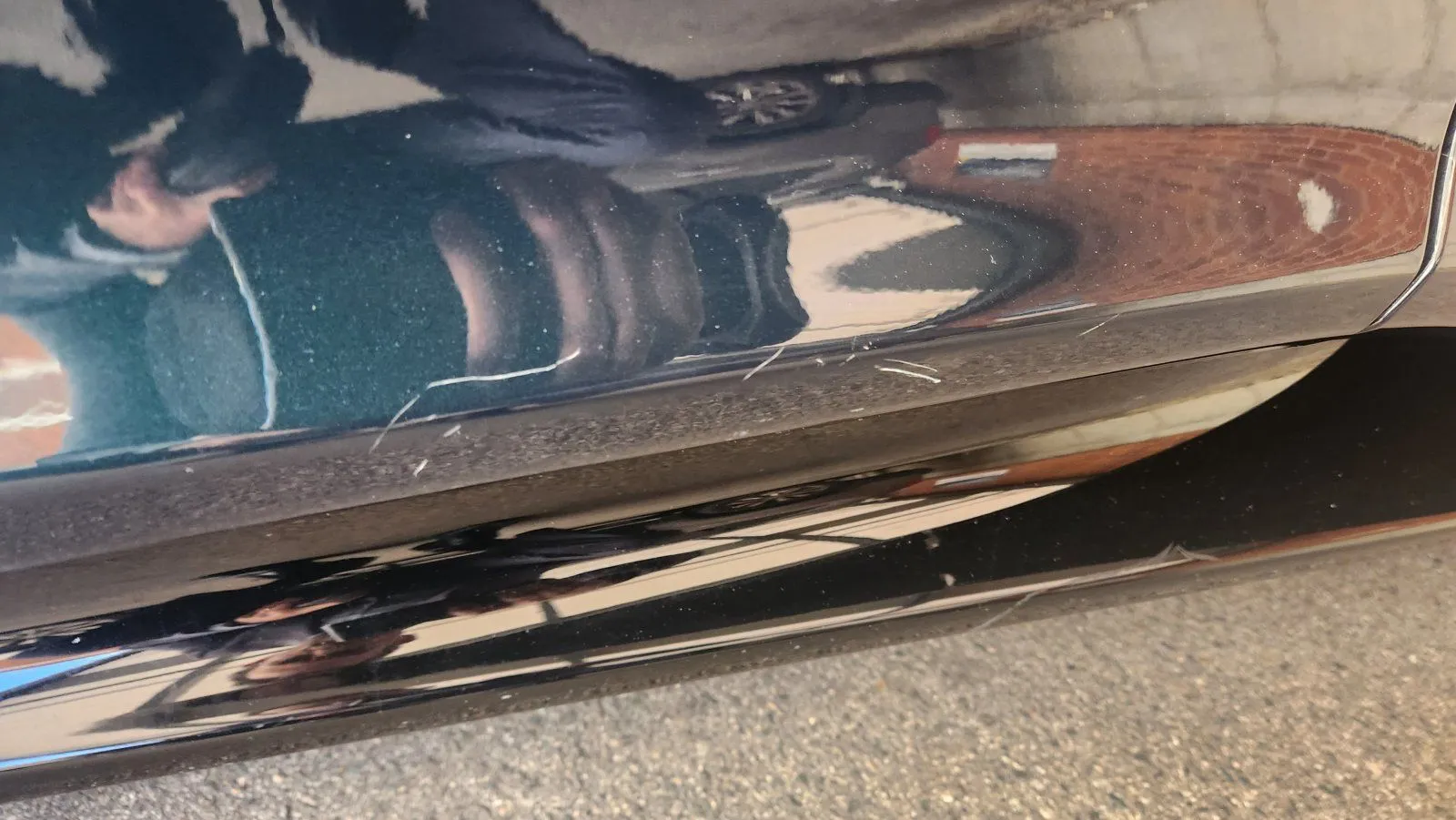

Car parked next to mine in a apartment block got their window smashed and broken in to. I thought I got away with no damage, but once it was able to get in close for a look found some pretty nasty scratching 😔 photos below.. what's my best approach to fix / touch this up? Also, can confirm occured during break in as day before I had just done a full wash and went over every inch of the car, I would have seen. Photo of newly washer and shiny car included below for positive end to this post!!

You must be absolutely gutted, I really feel your pain! I would recommend a good machine polish first. It may just get the majority of the marks out. However, if you can feel a definite ridge in the lacquer/top coat with you finger nail, it will likely need professional Smart Repairer or bodyshop attention unfortunately.

I gave it a slight rub with QD and microfibre, some of it is deep (can feel), some cleaned up, but I think it will need professional to touch it up. It's not the end of the world, just feels like dropping your baby on its head for the first time... Not that I have kids, but I imagine that's what it feels like hahah

I would let a detailer take a look at that. Some of it may be cleaned/polished out.
