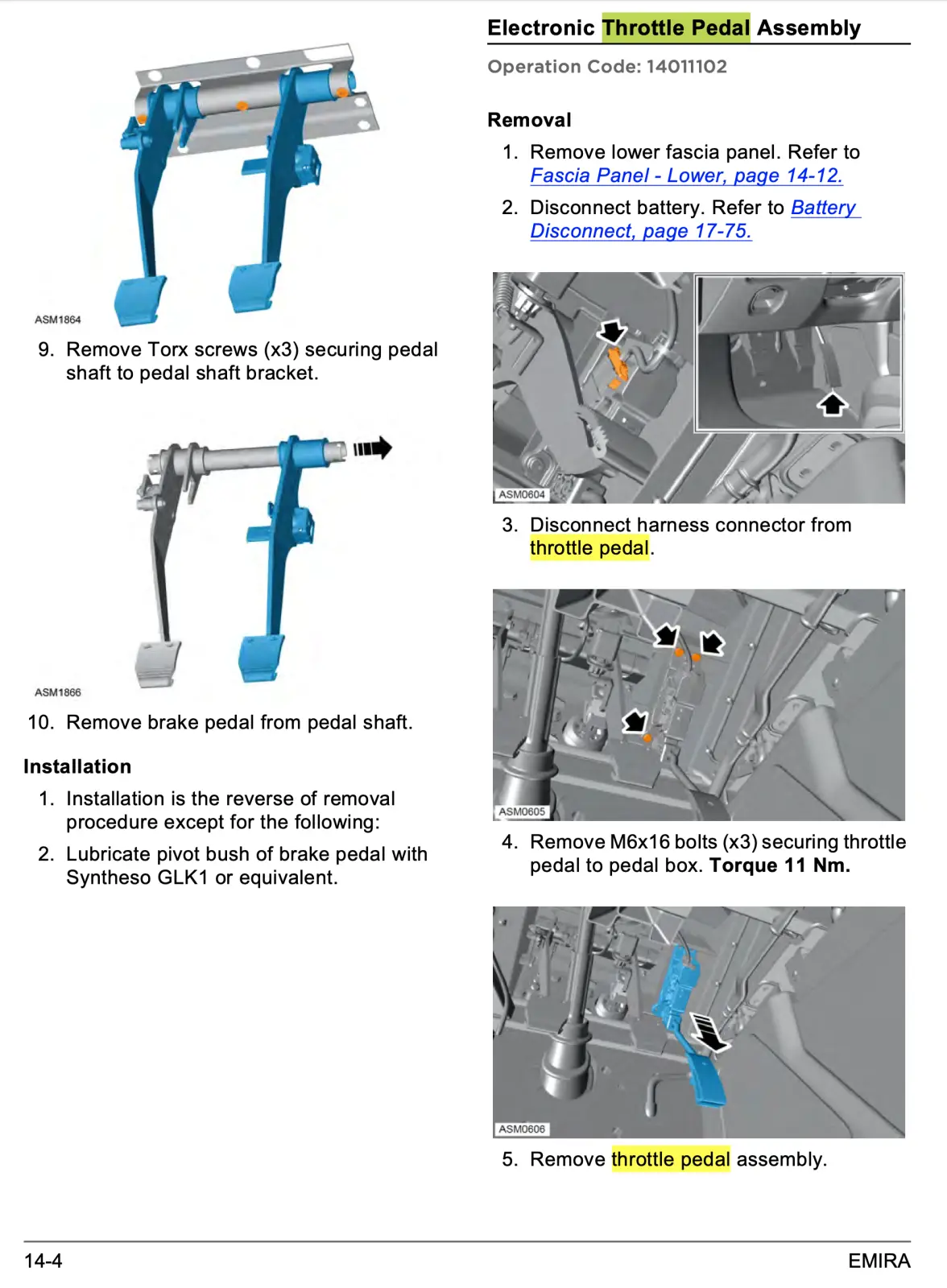

There is a harness connector at the top of the gas pedal. Check to see if maybe it's loose or working loose? Any signs of water or moisture up there that may have dripped down on it from above?
