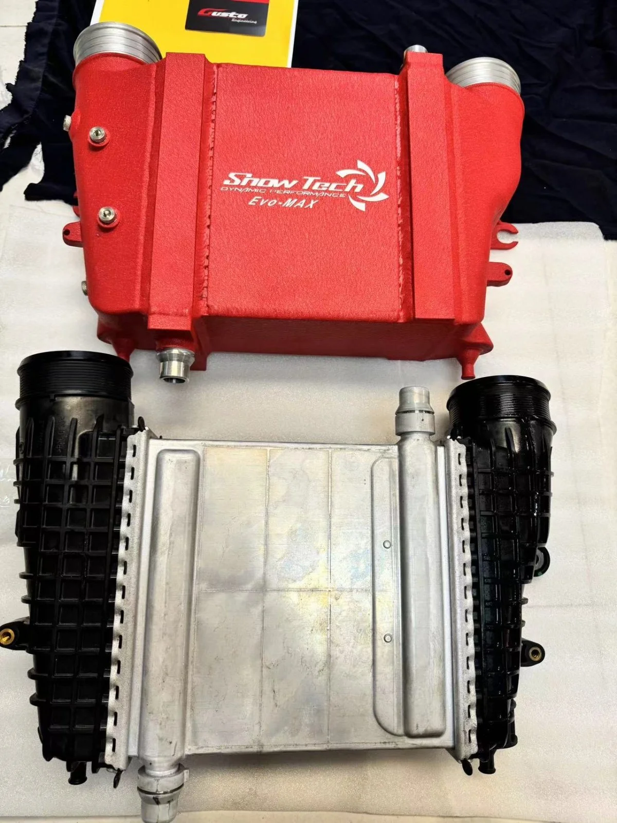

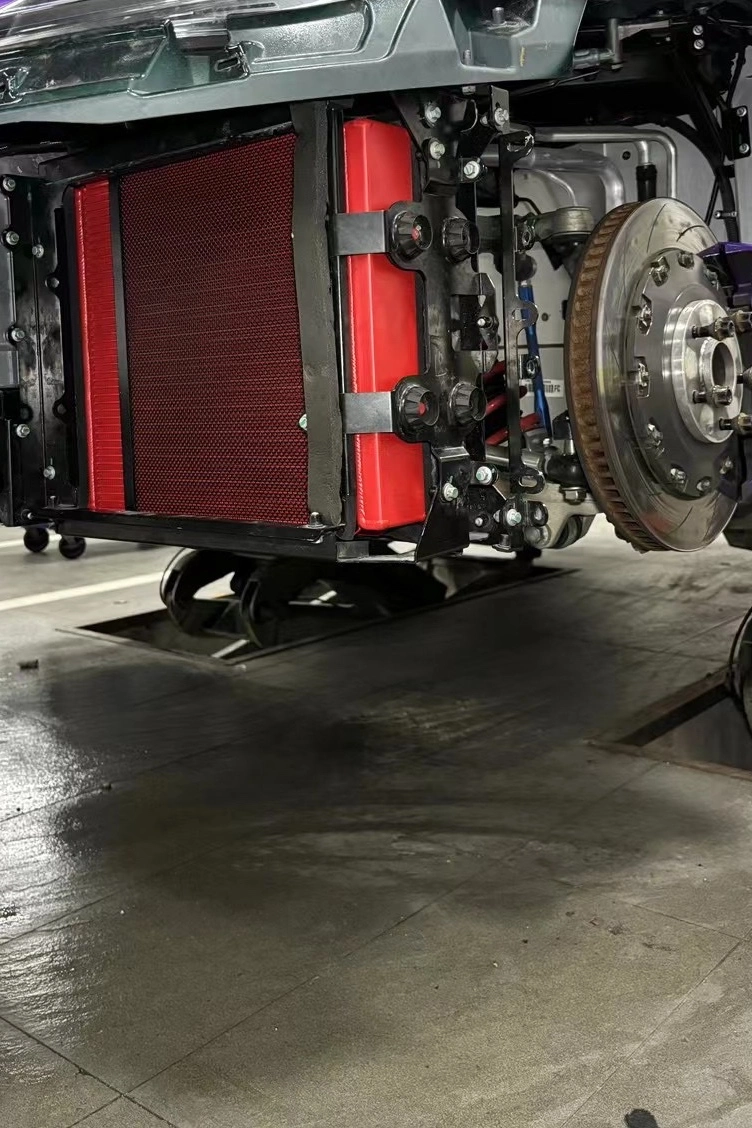

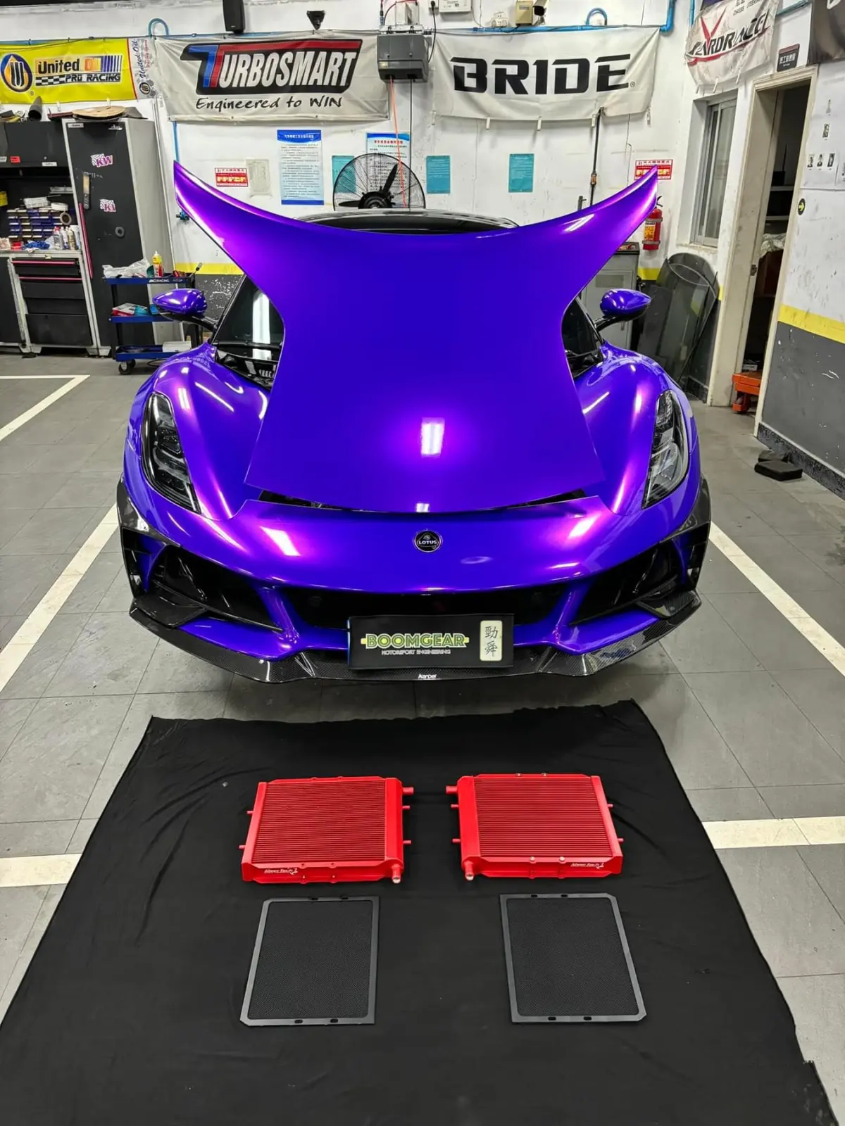

An upgraded intercooler helps a great deal, intake temperature cuts in half from 80 to less than 40, outside temperature is around 35 degree.
It would be interesting to see a comparison of the before and after dyno printouts, ideally on the same graph. It is always a juggling act to get an intercooler that lowers the temps but not too far that the boost drops. It is worth persuing on the i4 considering the temp issues.Have you noticed an increase in HP/speed?
