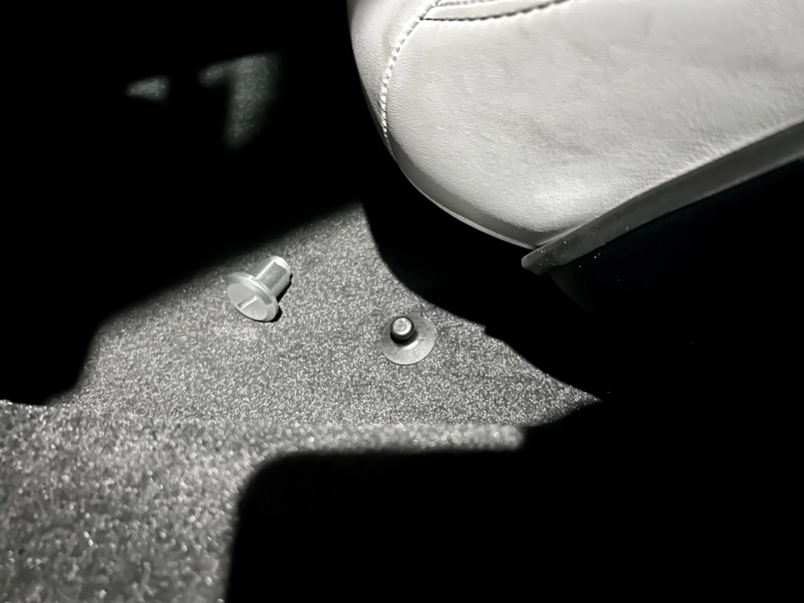

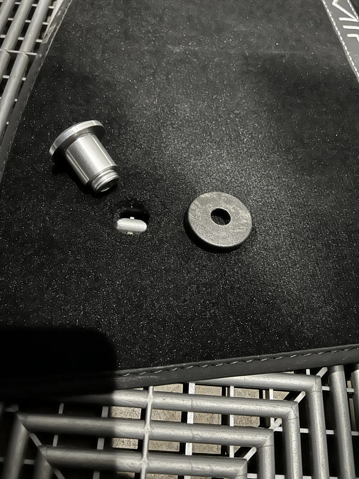

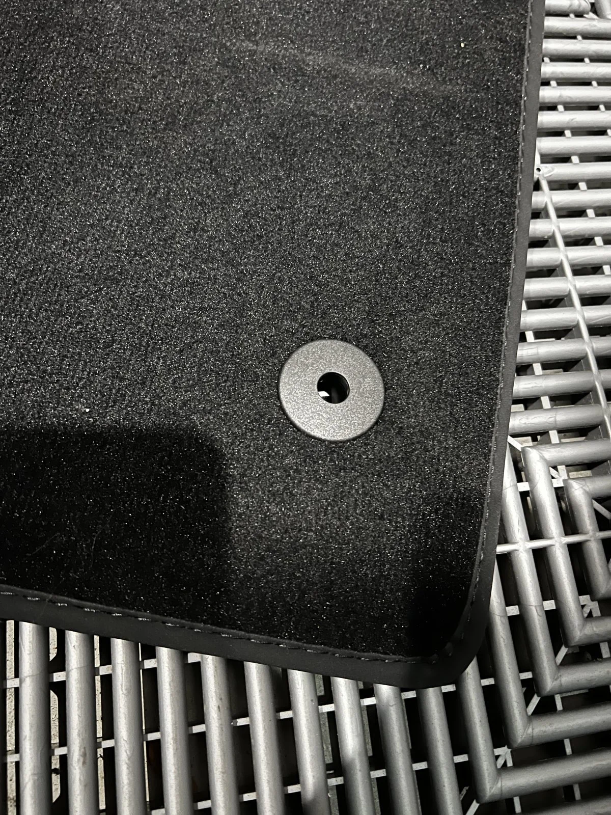

@LuckysDad
@GRP
Am I missing something? My wife’s mats don’t have plastic black buttons that look like these aluminum ones that I purchased from @GRP.
There’s an anchor nipple on the floor of the car, with a ring on the carpet that the nipple goes in.
I can pop the ring on the mat off and the aluminum buttons fit, but that nipple on the cars floor does not want to come out, and I don’t want to break anything.
Lotus must have changed the design. Mine has a hole where the buttons thread in. Threads are plastic and easily damaged, that’s prob why they switched to pins. Do the pins screw out?

There's a possibility that whoever removed it, may have accidentally dropped it when trying to reinstall it. It may be down on the body underpan somewhere. I've removed mine, and it's not easy to see or reach when reinstalling it.
They don’t appear to screw out. They just spin. I lifted the edge of the pin up with a trim tool and it looks like it’s attached to a metal washer underneath the floors carpet. The floor carpet lifts up when pulling on the pins, so the metal washer is what holds that pin in place.
Can someone take a pic of what the GRP buttons screw into? The design change makes these very expensive aluminum buttons useless if I can’t figure out how to remove the pins… because of the design change there may not even be a place to screw them into if I do manage to remove the pins.
@GRP can I return these for a refund?
@LuckysDad
@GRP
Yeah, that's a totally different attachment setup than what I have on mine.
So, Greg isn’t going to be able to sell these for the Emira with newer roll offs from the production line 🤔
I’m going to email him on his website to see about a return/refund, and bring up that he should update his product listing so more people don’t end up ordering something incompatible.
Greg will take care of it, don’t worry. I am just now learning of this change, I’m sure he had no clue either.
yeah Greg confirmed the carpet pins have changed. the ones he sells no longer work and hes offering refunds for those who have the new emira carpet pins
