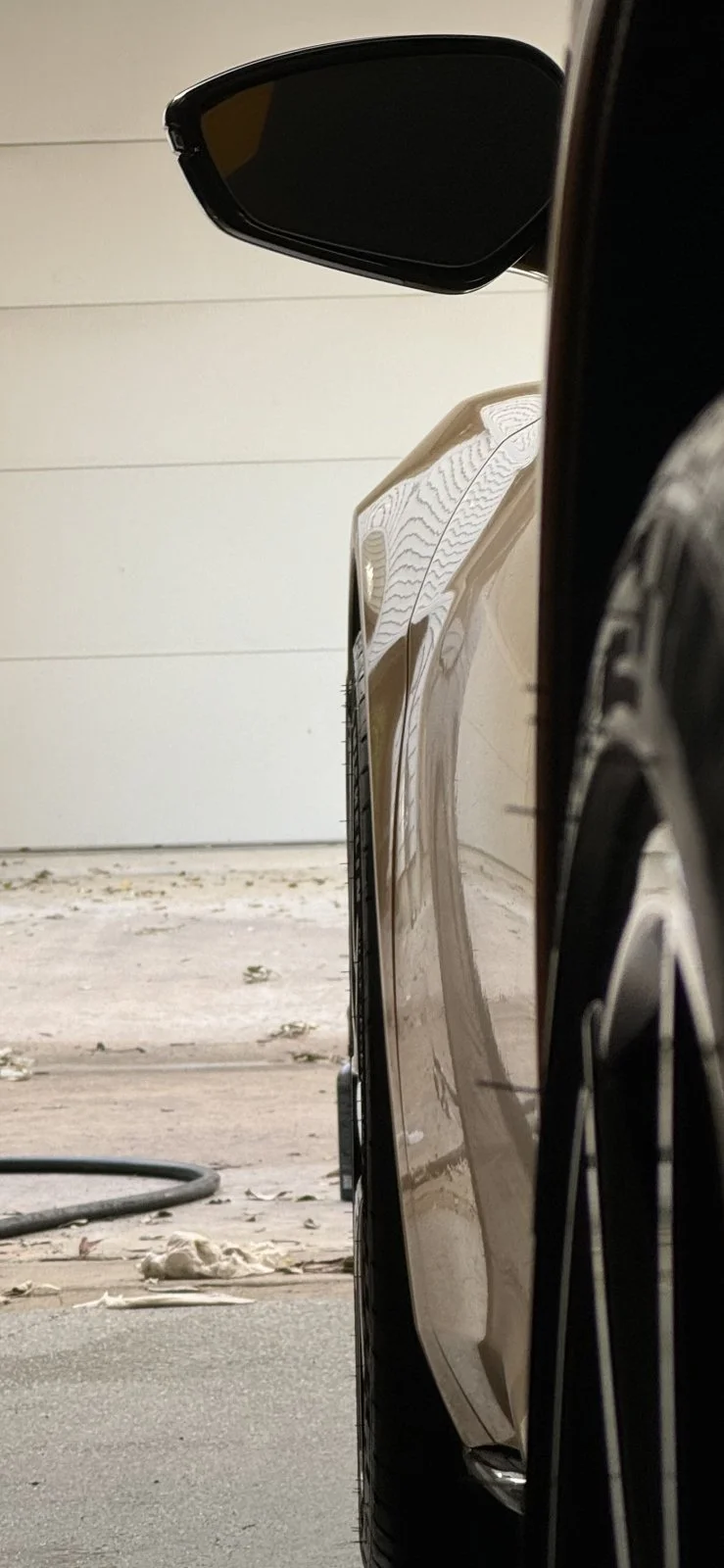

I have the the same 12mm spacers up front, wheels are flush and tires don’t rub. The rears can take a 15mm easy!
@scarzie here’s a pic of the front, the angle makes it seems like there’s a tiny bit of poke but it’s flush
I like the poke, that looks amazing. Are 15mms avail for the rear? :devilish:
I just ordered the GRP lowering cups so maybe 15 will be too aggressive then lol
I think they’ll still clear. You’ll add some negative camber once you lower the car which will give you even more clearance but I’d get an alignment after to make sure toe is in check.
