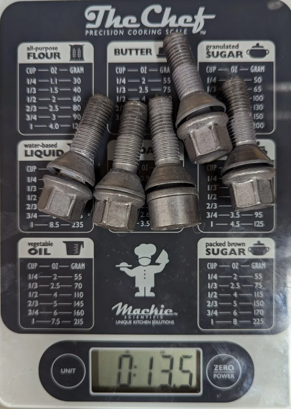

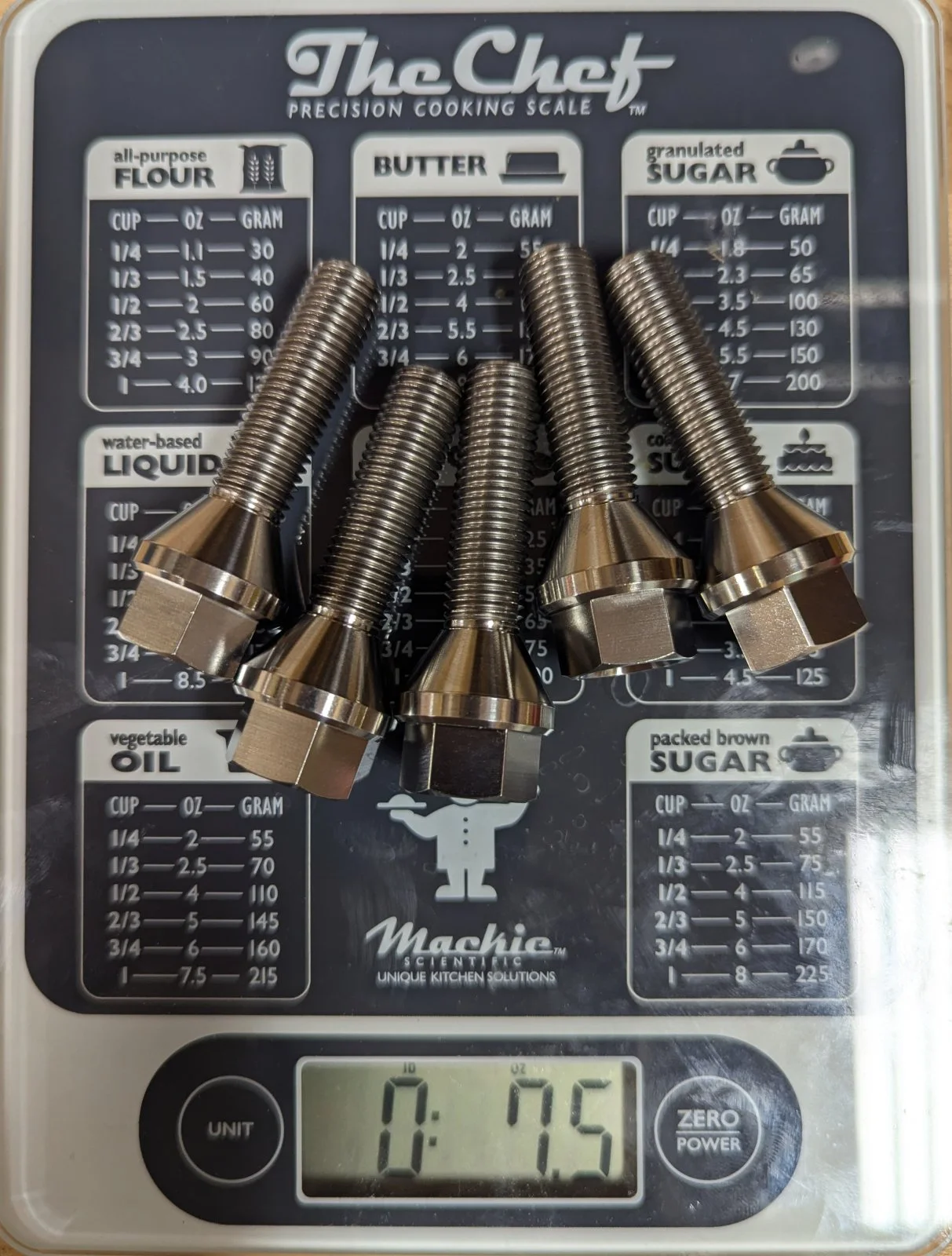

Hi, thanks for the link. I was about to install GRPs spacer but reading many members complaints got me to think again. Since you've installed 12mm spacer, what size bolt did you buy??
M12x1.5x40mm
I bought these titanium ones.
Titanium is not necessary but I figured if I'm going to add the weight of spacers I should reduce the weight of the lug bolts.

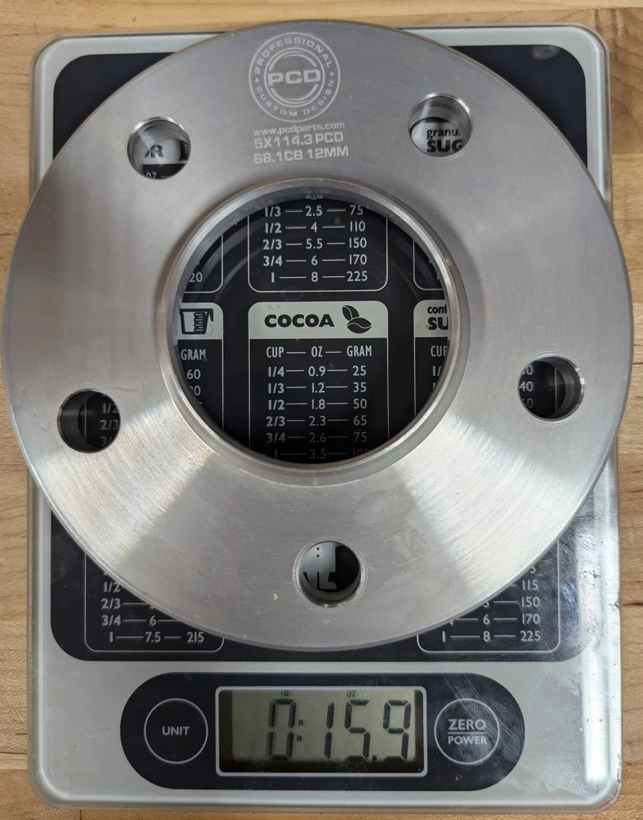

You probably have a 50/50 shot of those spacers without the lip causing a vibration.
On the advice of several forum members that tried that style and had problems I went with the 12mm with lip from PCD Parts.
Have you actually received these spacers and tried them? I'm not sure how you'd be able to use these on the Emira. The hub lip is 12.5mm long, you'd need like 3mm on top of that making the minimum spacer width to keep the hubcentrip lip around 15.5-16mm,

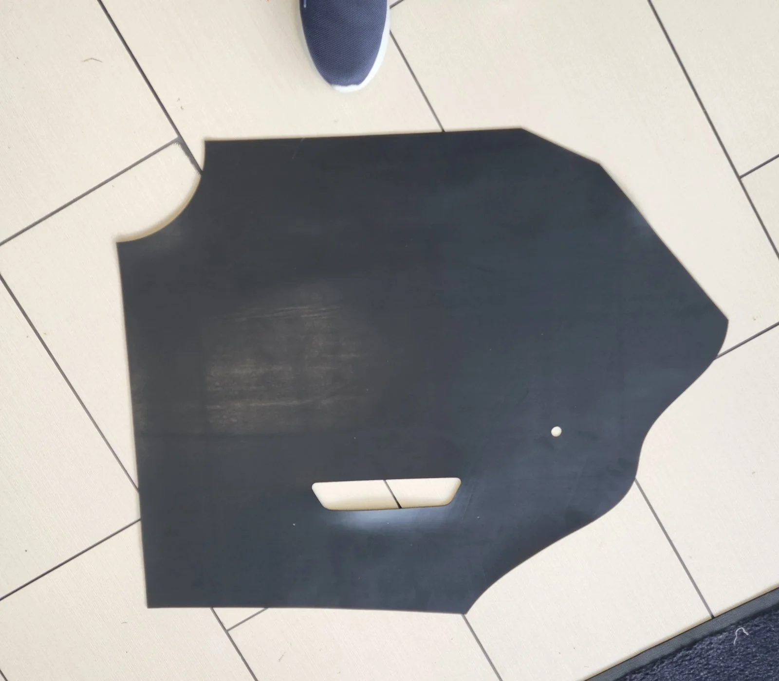

Had dealer install under-hood (bonnet if you will) rubber sheath to20240718_091948.jpg protect AC/electronics from vent borne water damage. Shoe visible for scale (yes. Track mode).
Warranty item.

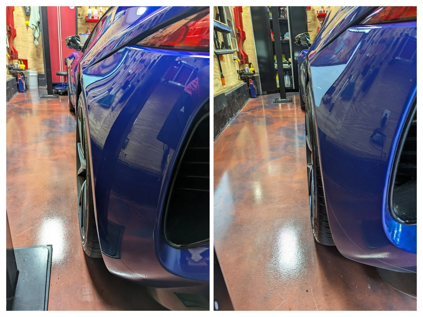

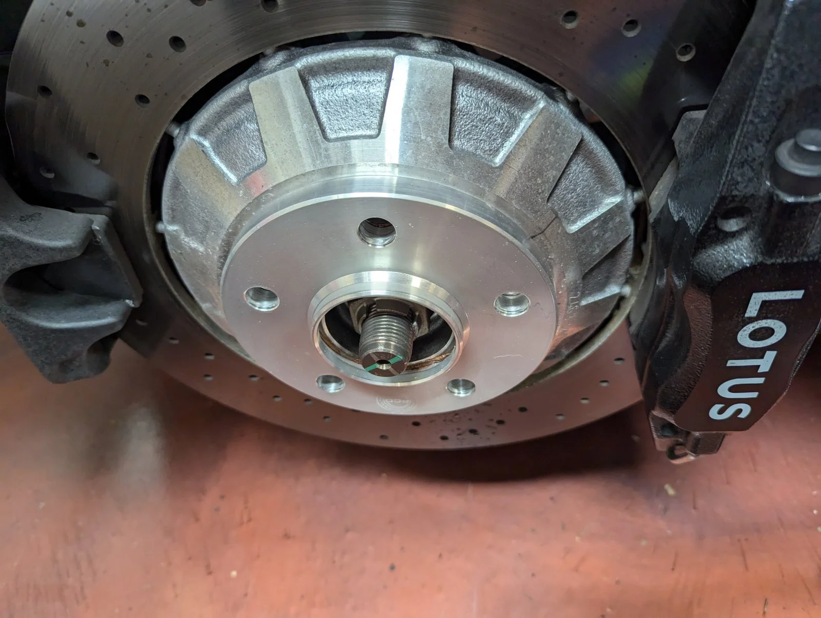

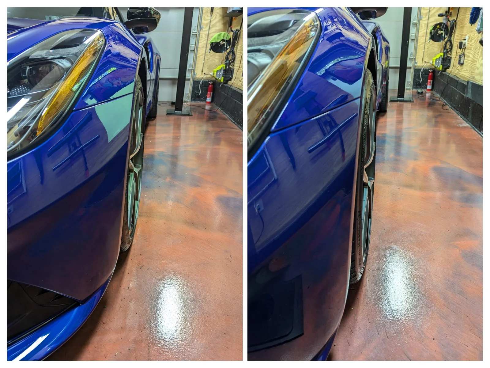

Swapped the Good-For-One-Year tires out for Michelin PS4S
Added 12mm hub centric spacers and 40mm titanium lug bolts
My observations:
~ Absolutely zero vibration at any speed.
~ The turn-in feels more predictable.
~ The on-center jittery-ness is completely gone.
I was able to drive on the turnpike at 80mph with barely a finger on the wheel.
All these incremental improvements just keep making the car more enjoyable.
